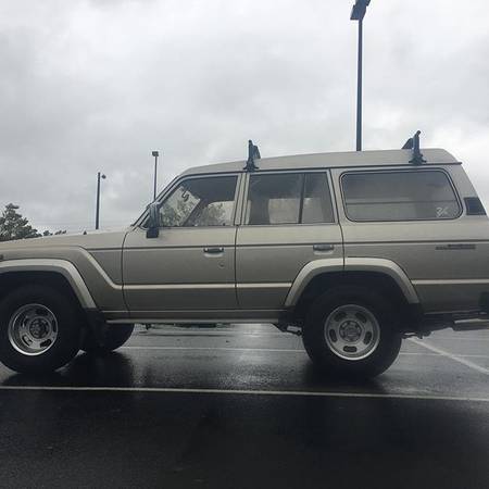

Beauty Truck, but priced based on the 'merican market:
Nice 61. Appropriately priced IMHO. I'm even tempted.... I know these are decent at towing too....
