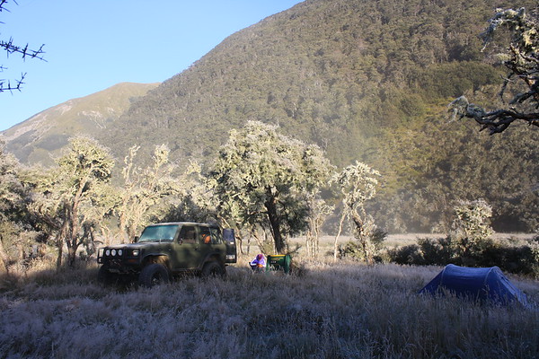

Tomorrow we may speak about winter driving in Siberia, if you like... :)
Yes please! You would laugh at us, In NZ if we get a -10C frost overnight on a winter camping trip we think it's pretty cold :)
Cheers
