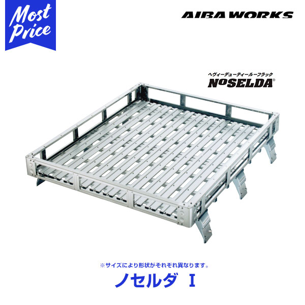

I like the roof rack a lot too. Nice work!
Maybe if you put a wind deflector at the front it will reduce the wind noise? It would not be too hard to fabricate a custom one? Something like this?

I thought abut such deflector! If lightbar will not work as deflector, I have to made it.... Too loud howl .

@GTSSportCoupe tried to PM you but for some reason you are not eligible to be messaged? wanted to ask you about your frontrunner rack
Sorry, I turned PM's off as I get too many re: 2LTE, LOL. I don't own a front runner rack; that was just a picture off the web.
