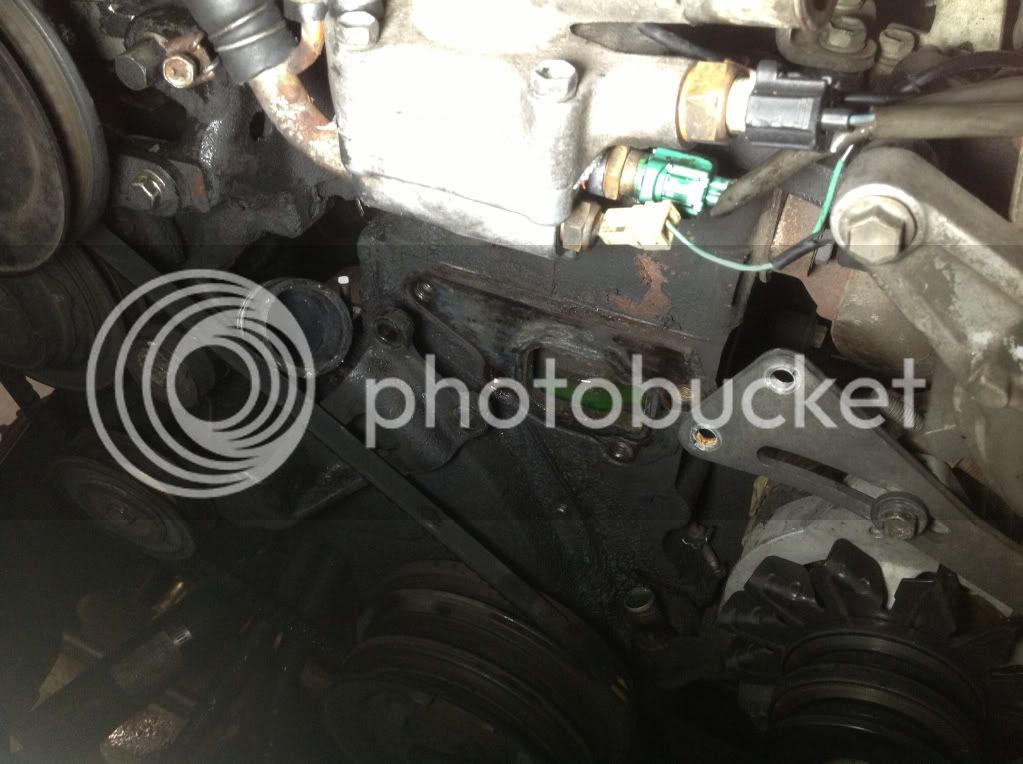

Forgot to share the drive home from expo fun on Sunday...... Sounded like a bomb went off under the hood when it blew! Shut it off and heard it percolating for a sec before she let go... Time now all new hoses, water pump and fan clutch...... Looks like the prior owner just did a thermostat....BTW, what makes rubber hoses go soft? Never seen such mush hose before!!!!!!!
Wow! Cooling system overhaul time!
That hose really failed marvelously! Did the hose go soft or was it dry rotted?
Yikes! Excess pressure in the cooling system from a blown head gasket could do that...
Better check the PHH and other coolant hoses while you have the system drained.
91-92s don't have phh.
Sent from my hawn finga using IH8MUD
Oh it was cool when it blew..... At first I thought a freeze plug let go.....
Soft as sponge..... No dry rot, looks like they were done at some point in the past, but never seen them sponge up like this.... Two hoses looked like they were ballooning (if there is such a thing):)
Yea we thought about it...... But motors got good compression all away across, no oil in the water or water in oil, temp runs good and idles like a stroked cat..... We know the radiator cap and 3 hoses were bad and we are thinking the ballooning hose could be a part of that problem we had with a little boil over push back into the overflow tank when we shut engine off........ Will see... Fingers crossed
