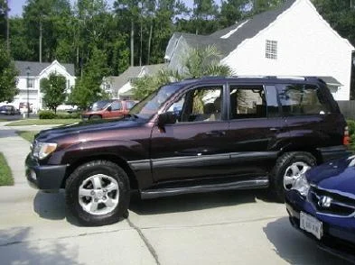

I've got the 275/65/18 Revos, but I never upgraded the spare (still brand new). That's over a 1" difference and I've always wondered if that would pose a problem. Hopefully, I don't go flat.

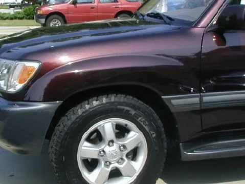

BTW, flyfish...the Revos look great on 18" rims

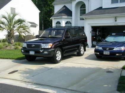

Pics please!

That's a real nice balanced size for the 18" wheel. Does anyone think a dealer would give you any warranty issues because you went from 275/60/18 tires to 275/65/18 tires? I know it would extend the mileage part of your warranty just a little :)
