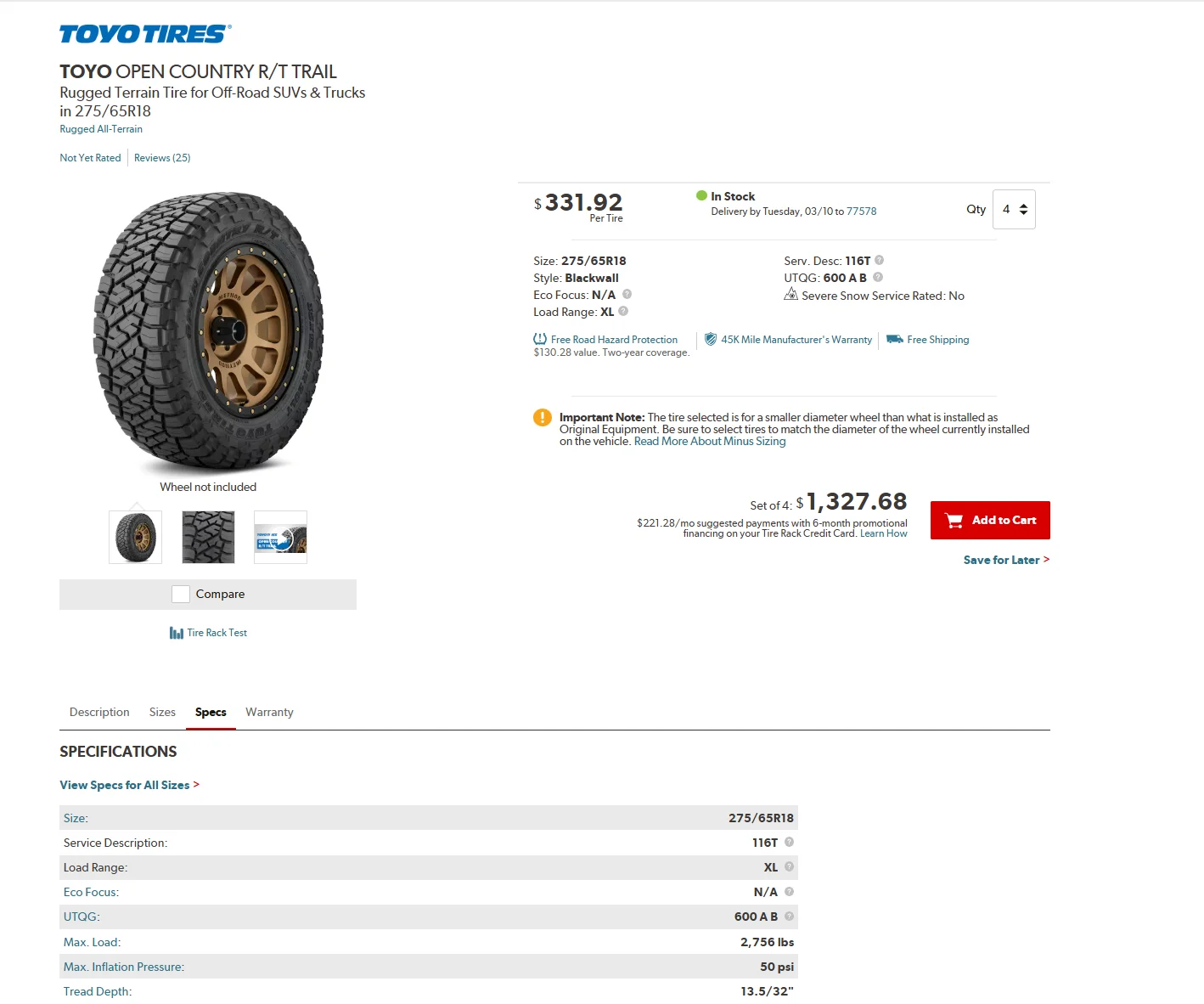

@gaijin can you by any chance calculate the RCTIP for a 100 series (2005 LX470)?
Tires: Toyo RT Trail LT295/70R18 129Q E1
Wheels: BBS forged 18” trd pro wheels

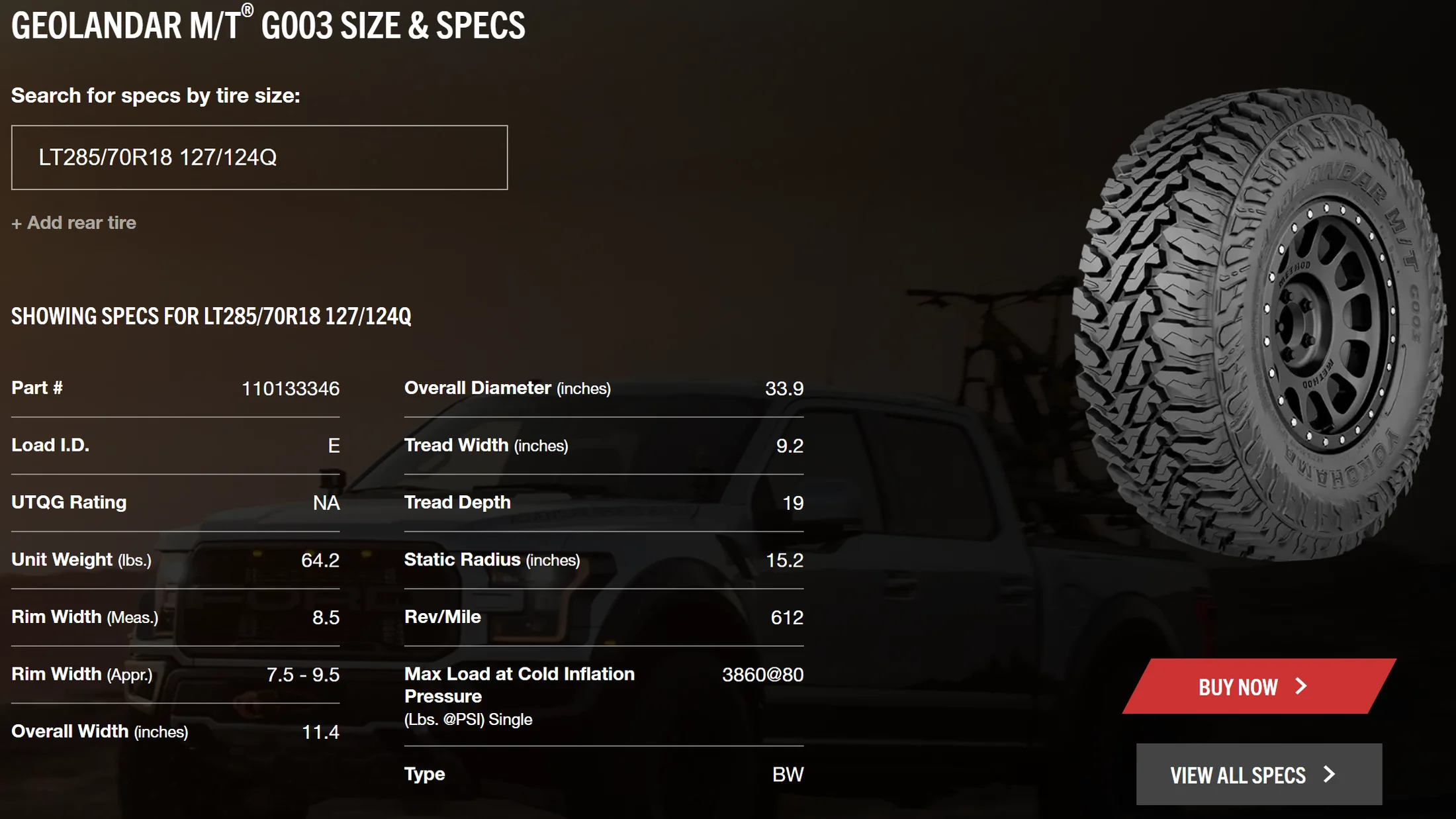

Hello @gaijin
Can you please let me know the RCTIP for a 2019 LC with Yokohama Geolander M/T G003 285/70/18 127/124Q 10R’s. On OEM RIMS WITH .75” bora spacers.
Thanks in advance!
Hello @gaijin
Thanks in advance!
Sure!
I assume you meant these LT-Metric tires:
If so, the RCTIP for those LT285/70R18 tires on your LC200 is 38psi F/R.
HTH
