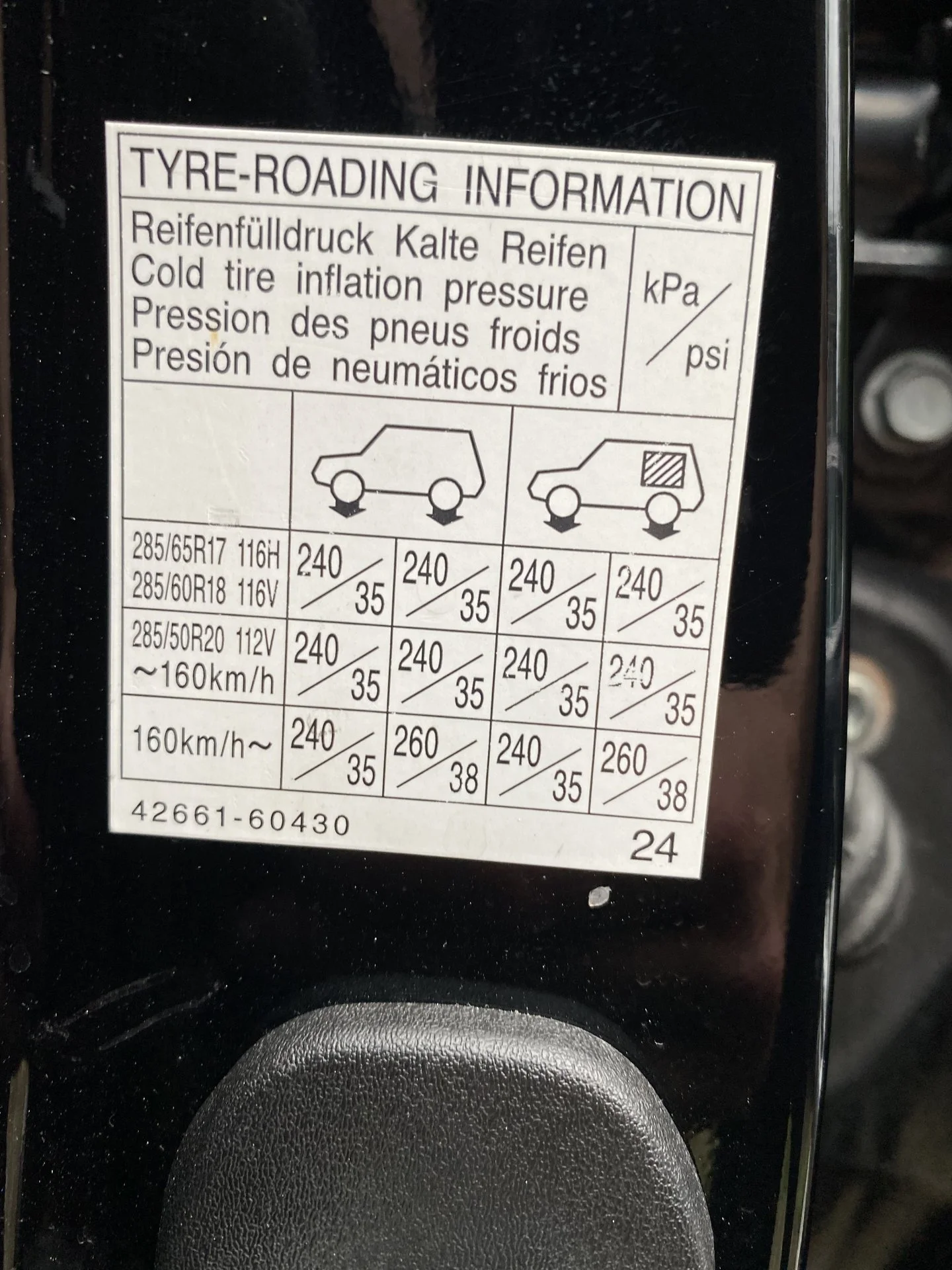

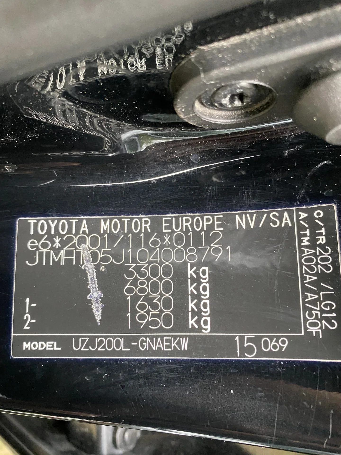

LC200 4.7 Petrol with AHC, 2008.
I have BlackBear AT2 LT 3PMSF 285/55R20 117/114S. What should my cold tire pressure be? Thanks :)
Please post a picture of the door stickers that show the stock tire size and inflation pressure as well as GVWR, GAWR (GVM) numbers.
That should give us enough info to make a valid recommendation.
