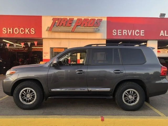

Finally it’s my turn. Just got Terra Grappler G2s on RW. 285/70 17, P Metric(I think). What is the recommended PSI for these?
Thanks in advance!
Thanks in advance!
Nitto makes the Terra Grappler G2 in both ISO-Metric 285/70R17 116T and LT-Metric LT285/70R17 E 121/118S. They do not make a P-Metric P285/70R17 Terra Grappler G2. Please check the sidewalls of your tires carefully to determine which size you have.
If you have the ISO-Metric 285/70R17 116T tire:
The Recommended Cold Tire Inflation Pressure (RCTIP) for the 285/70R17 116T tires on your LC200 is 29psi F/R.
If you have the LT-Metric LT285/70R17 E 121/118S tire:
The RCTIP for the LT285/70R17 E 121/118S tires on your LC200 is 40psi F/R.
HTH
