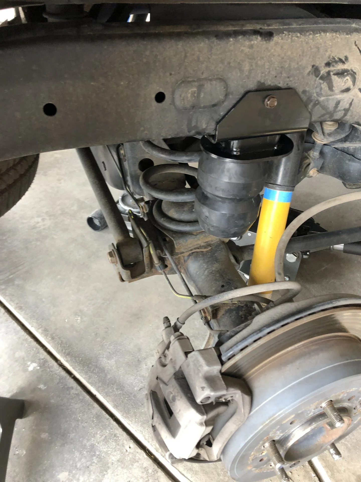

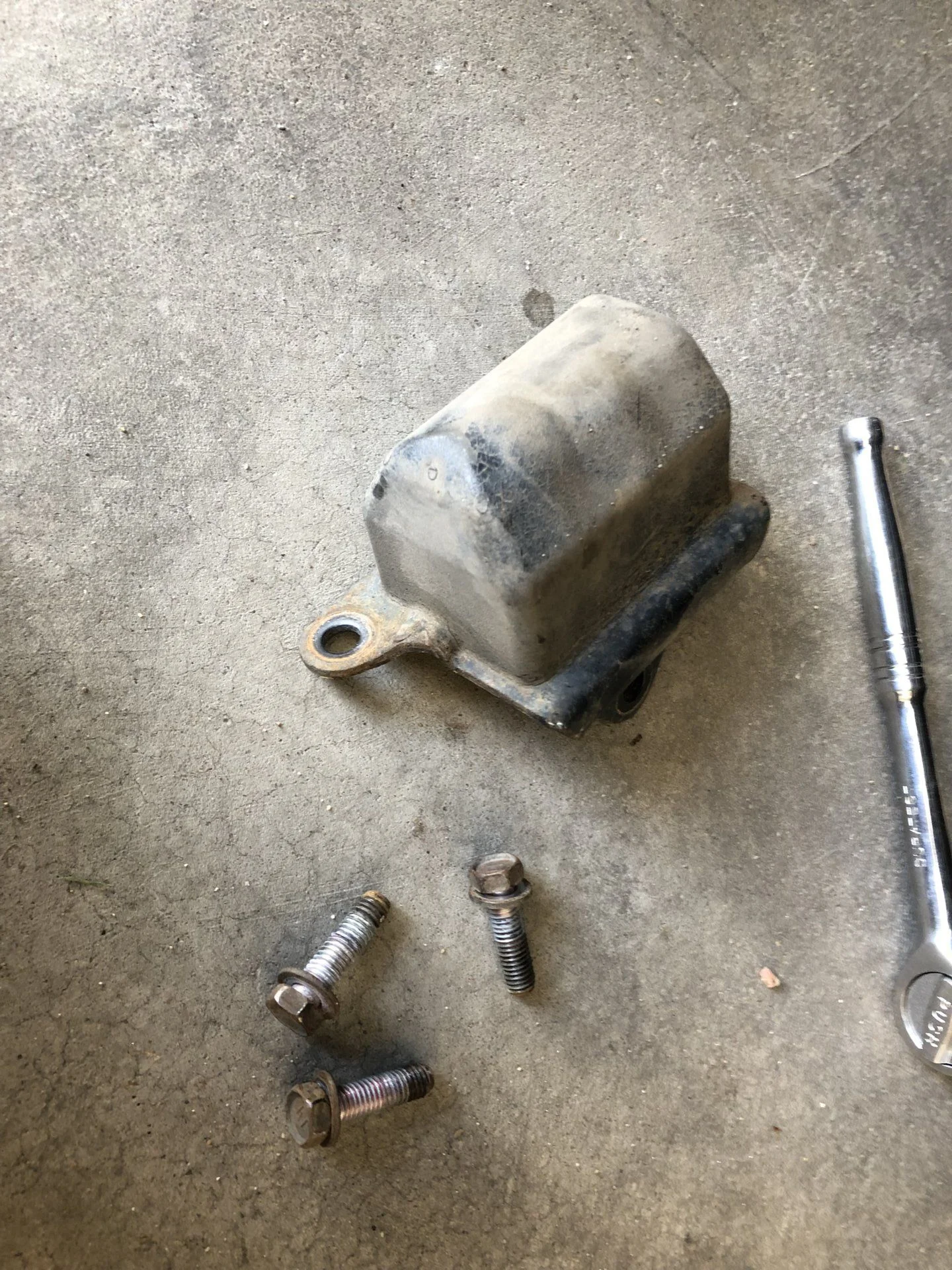

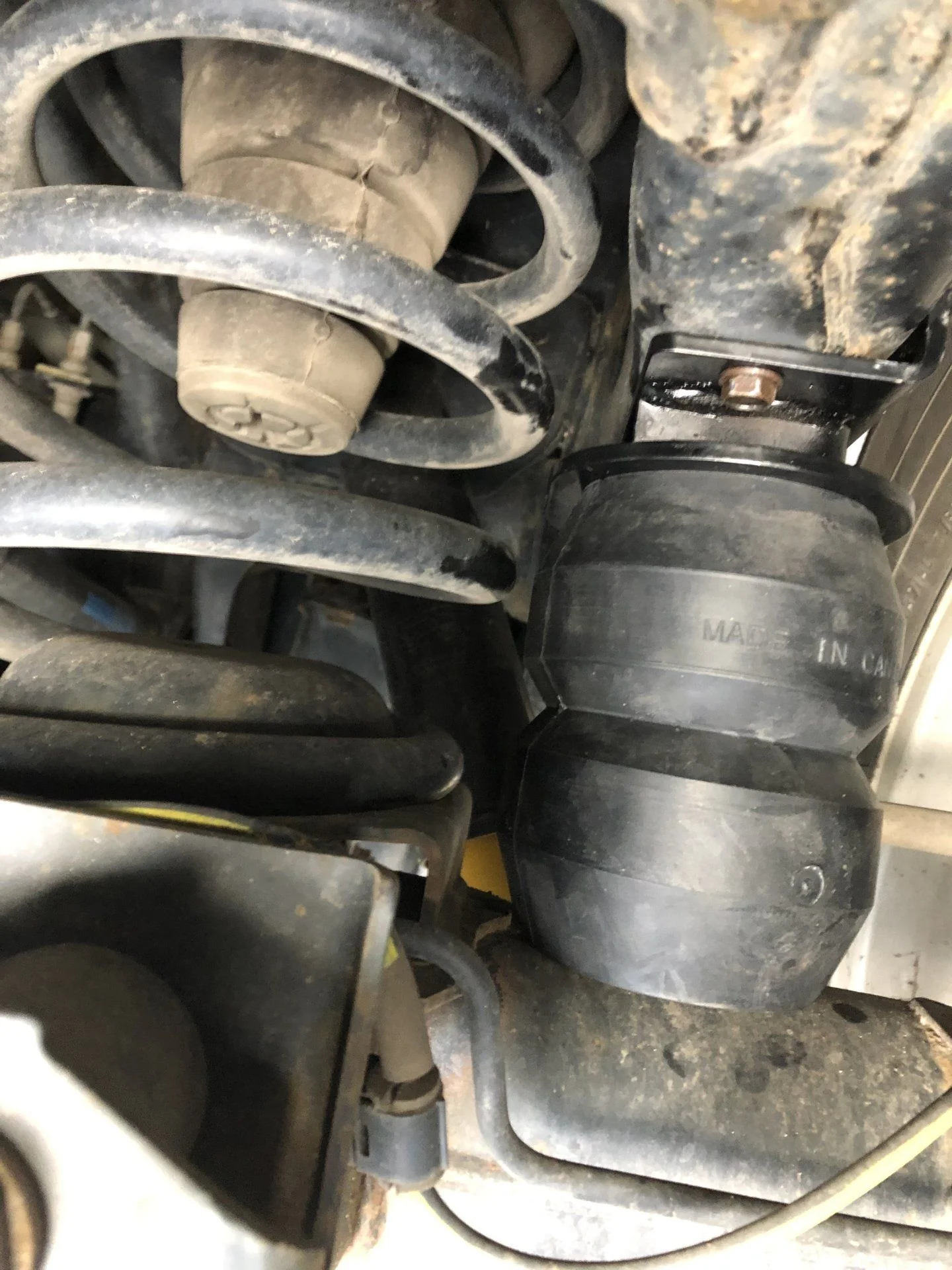

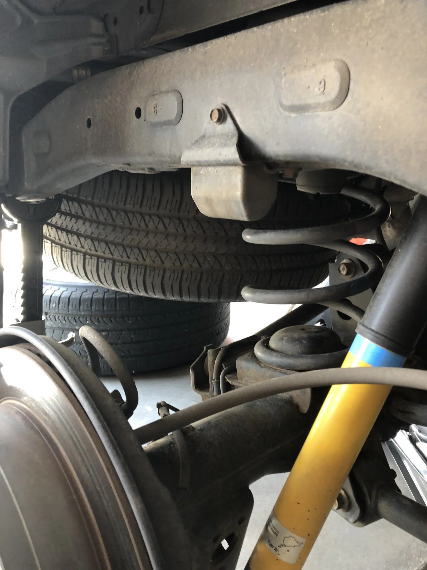

Install: Install was straightforward. Removed existing bump stops on the frame and added the Timbrens. The existing bolts were fairly difficult to remove, presumably due to the exposure to dust and sediment and some light corrosion. I was able to bust loose but I was very nervous about busting a bolt. They went back in slightly better after I greased the heck out of the bolts. The only concern I had is that the driver side Timbren rests against the spring - the mountain bracket is within millimeters of the spring while the Timbren is in full contact. The passenger side still has at least a centimeter or two clearance. See pics.
Performance: There is supposed to be 1/2 - 1 inch clearance from the bottom of the Timbren to the axle. After lower the vehicle, the Timbren is resting on the axle. Because of this, I could feel the Timbren engaged under zero additional load. It does provide a firmer and bouncier ride all the time. At first I didn't mind this, but it's starting to now get old after a week. When towing, the Timbren does keep the ride level (with additional help from a WD hitch) and provides more control - I'd say towing performance is as good as promised.

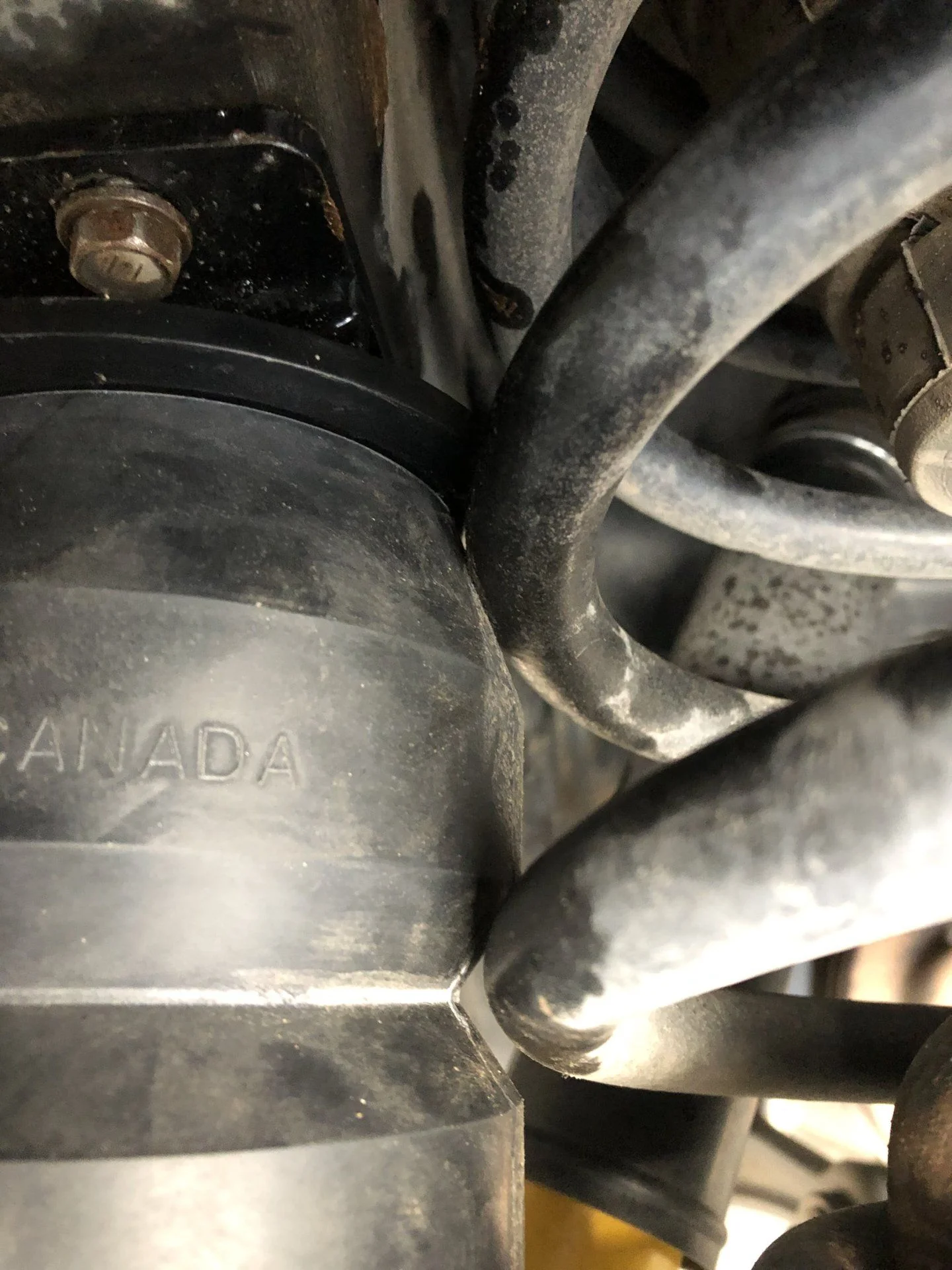

Problems: The biggest issue is the contact with the driver-side spring. Under uneventful driving, this doesn't seem to make a difference, but under moderate cornering and over some bumps, the spring does catch on the mounting bracket for an unsettling ping and vibration. This was more noticeable while not towing and over bumpy/rocky dirt roads, but it occasionally did the same while towing. And, as mentioned early, the unloaded ride is more bouncy than I prefer. I suspect the Timbren rests full-time on the axle because of some sag in the stock spring (117k miles).

My guess would be the springs sagged over time. With the rear being a 5 link suspension, the axle will naturally move left and right relative to vertical travel due to the panhard bar.
To remedy the height you could swap the springs for some OE take offs in better shape or something more HD. To correct the contact I would look into an alignment for the rear axle to see how far it’s shifted to the passenger side. Then add an adjustable panhard bar to correct its location.
I'm running the Timbren SES as well, but I'm on OME springs. I don't have any interference. It might be worth making some phone calls to see if OME has a factory height coil that has a tighter wrap.
Very helpful - thanks. I’ll investigate. Honestly never considered alignment could impact as well.
I'm not sure alignment will help in this case as I don't believe there is any ability to adjust the pan hard bar last I looked. A solid axle rear doesn't have many adjustment "knobs" other than the geometry that is built in.
Curious that the Timbrens rub on one side more than the other.

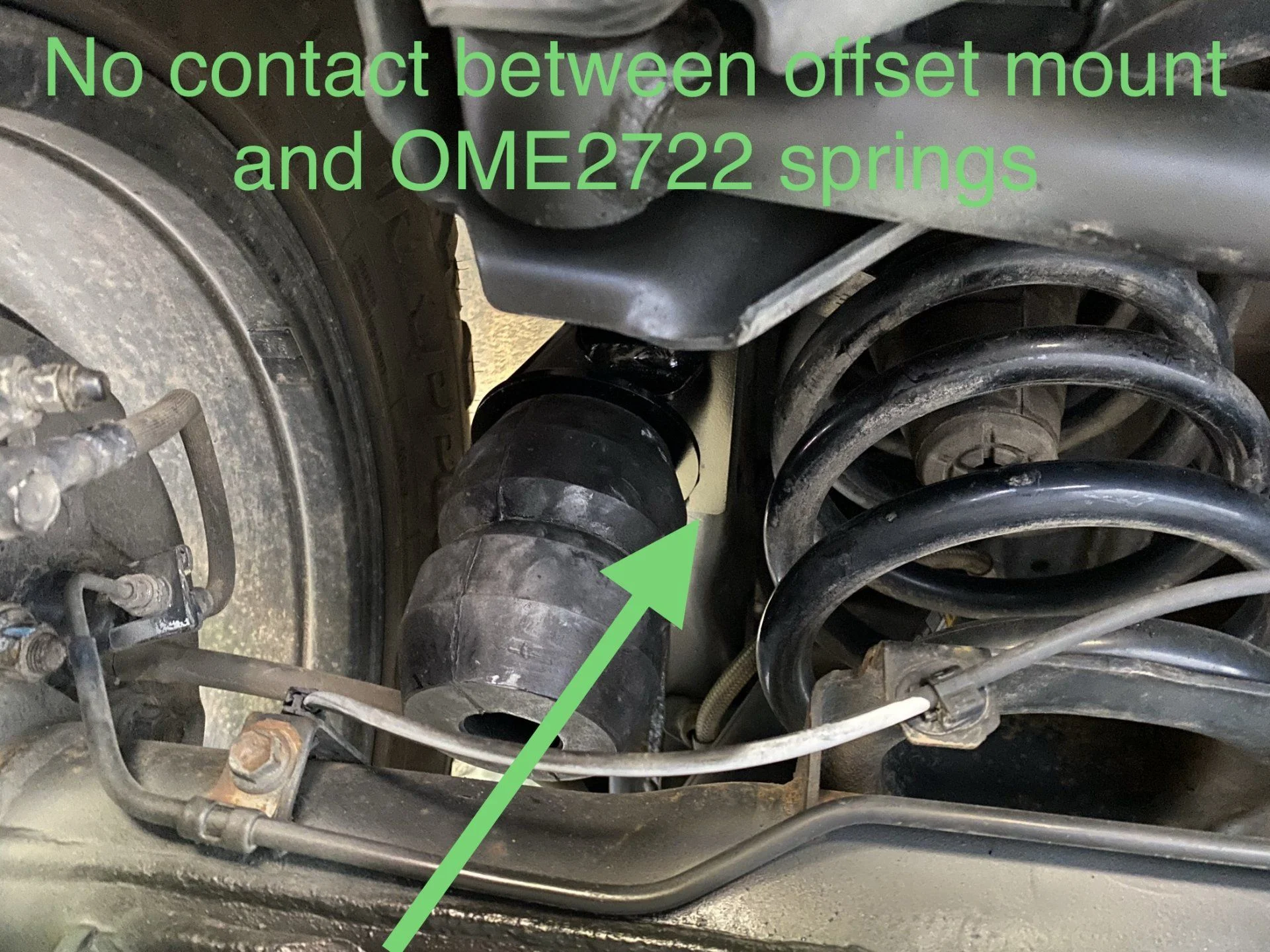

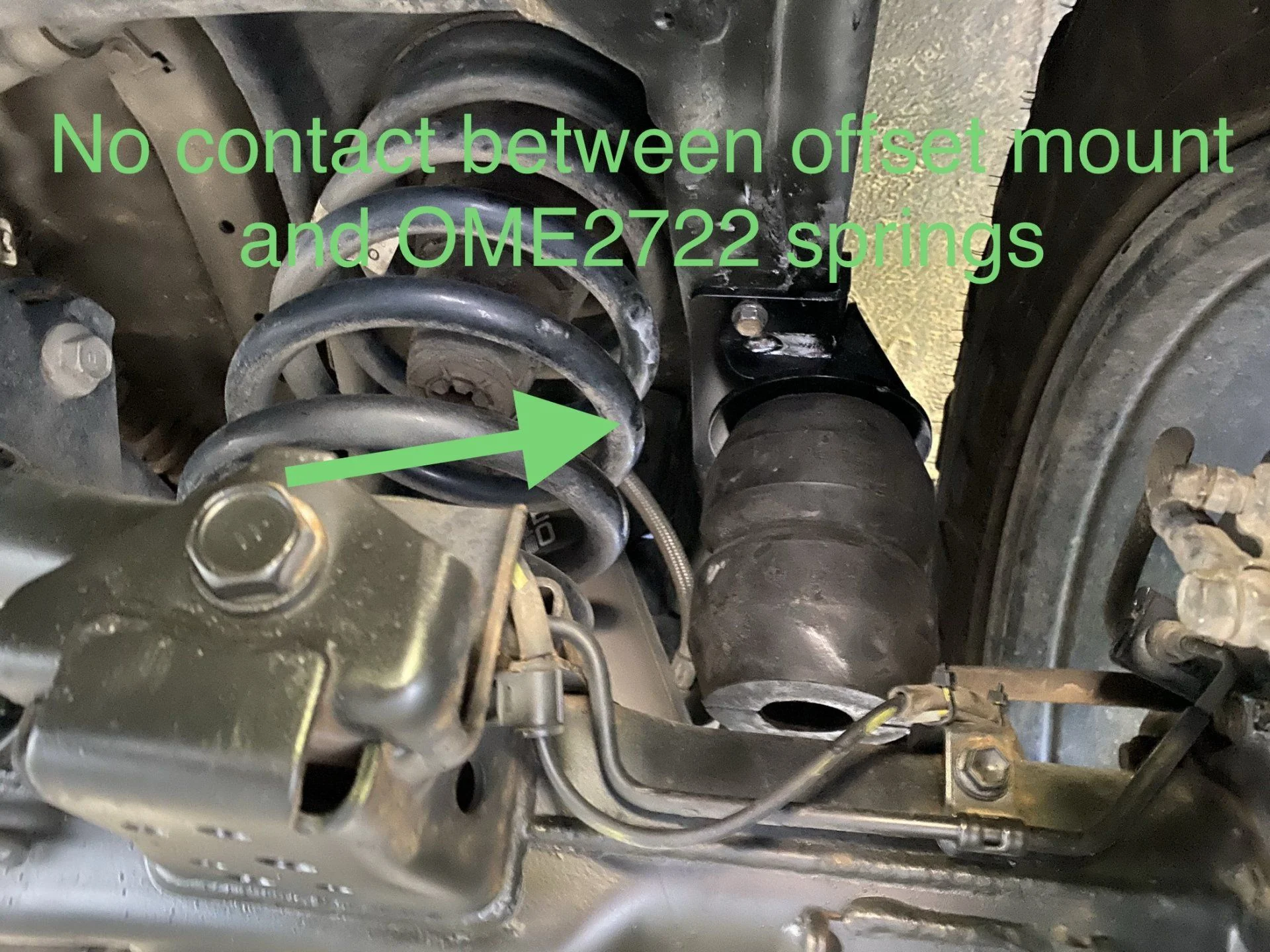

Similar to @ColoradoSequoia , the standard frame mount that came with the SES interfered with the OME2722 springs I have. Like - so badly - I didn’t even leave the driveway. Can’t imagine how unsettling the “ping and vibration” must have been!
I purchased from etrailer as well, but when I saw the issue above, I called Timbren sales and support. They overnighted an offset frame mounting bracket for the SES and they fit perfectly.
I’d estimate there is about 1 inch of clearance for the new offset bracket. Also I’d comment that the bracket shape itself is different enough to also help with the spacing.
I’ll be hooking up a travel trailer in a few days. Will report back on any observations from the SES but am not expecting any issues.
Not sure why etrailer is still selling the incorrect bracket - Timbren seems to know the correct fix.

Closing the loop here...I had a similar positive experience as reported by @kevinfoutch.
All works beautifully. Timbren CS is excellent.
