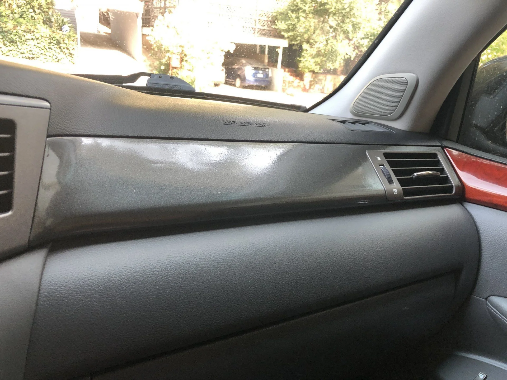

It isn't clear from your description whether the surface is smooth prior to painting, or if you're trying to fill in imperfections with paint.
Are you using a primer? What paint are you using? What's up with the JB Weld?
If it were me, I'd use several light coats of sandable primer (with wet-sanding in-between) and get it super-smooth. The grey sandable stuff from Rustoleum is good, although I find that the green self-etching primer is best for adhering to surfaces (even plastic). I'd use a coat of green first, then use the gray sandable stuff to get the smoothness you want.
Actually, I'd vinyl wrap that sucker and be done with it. :)
Thanks for the reply. It's definitely just not getting smooth with my sanding. Looks and feels smooth to my touch, but once painted imperfections show through.
The JBweld was serving as a sandable surface - effectively a primer. Paint is Superwrap glossy 'sprayable vinyl'.
I think you're right though, some type of covering is likely the answer!
Take a quick look at this site. See if anything fits.
A third attempt with JBweld as the sandable underlying surface proved good enough to call it a day for now. Not perfect, but that’s my fault.
The fact that it’s not red in color to match the wood trim on the door is OK with me because the driver’s side does the same thing- the red wood door trim dead ends into a gray AC duct, so now both sides sorta match.

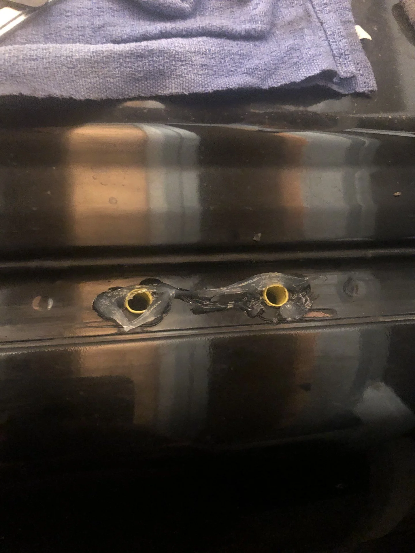

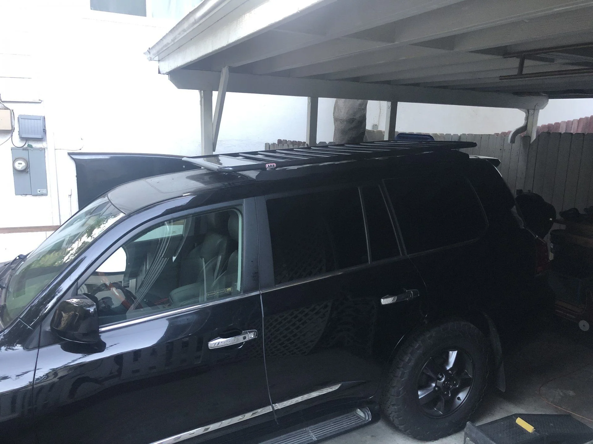

Finally got my ARB flat rack in. I bought I through Dirty Parts, in Culver City, CA, in case anybody is looking for an ARB dealer. I've taken my trucks to Dirty Parts for a long time and recommend them. Anyway, I didn't last 2 hours from when I picked it up to when I got to installing it.

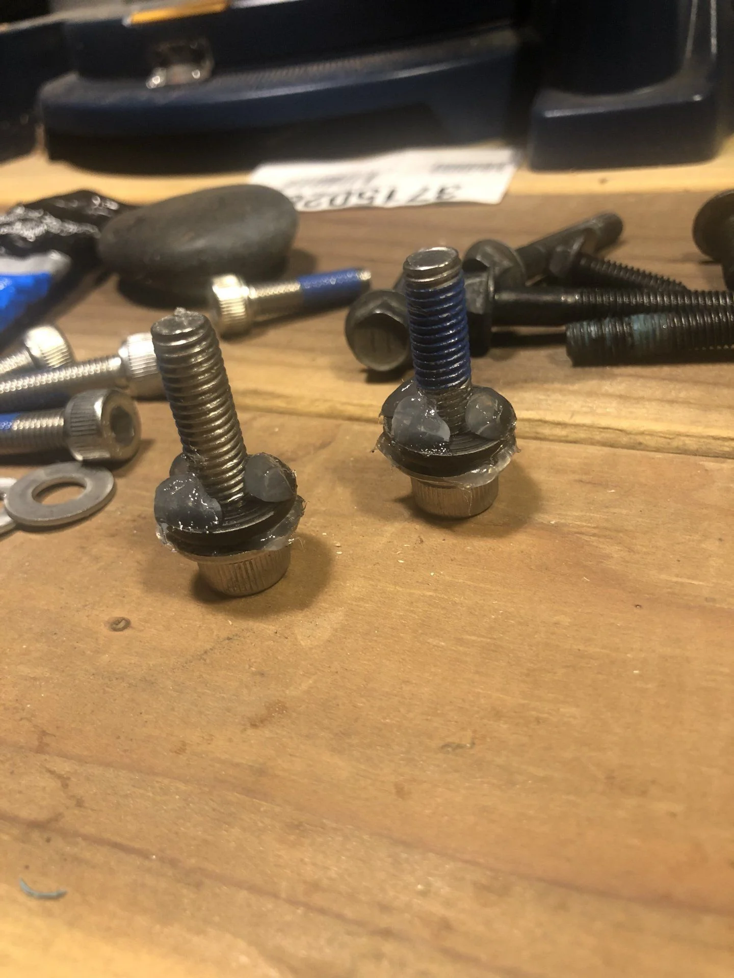

The only issues I had was knowing how much sealant to use. Hopefully it won't leak? I ended up using way more than what is shown in the photos below...
This is the 73" ARB Flat Rack, in steel. Dirty Parts advised that in SoCal's climate, there is really no need to shell out for the aluminum version, unless I'm concerned with weight, which I'm not. The rack feels super stout, the powdercoat finish is high quality, hardware is very nice, etc. Directions were not great/a bit generic, but it's pretty straightforward. It's probably a 2 - 3 hour job for one person if you've never done it before.
Just make sure to follow the directions about loosening both bolts first so the captive 'nut' doesn't fall into the headliner!

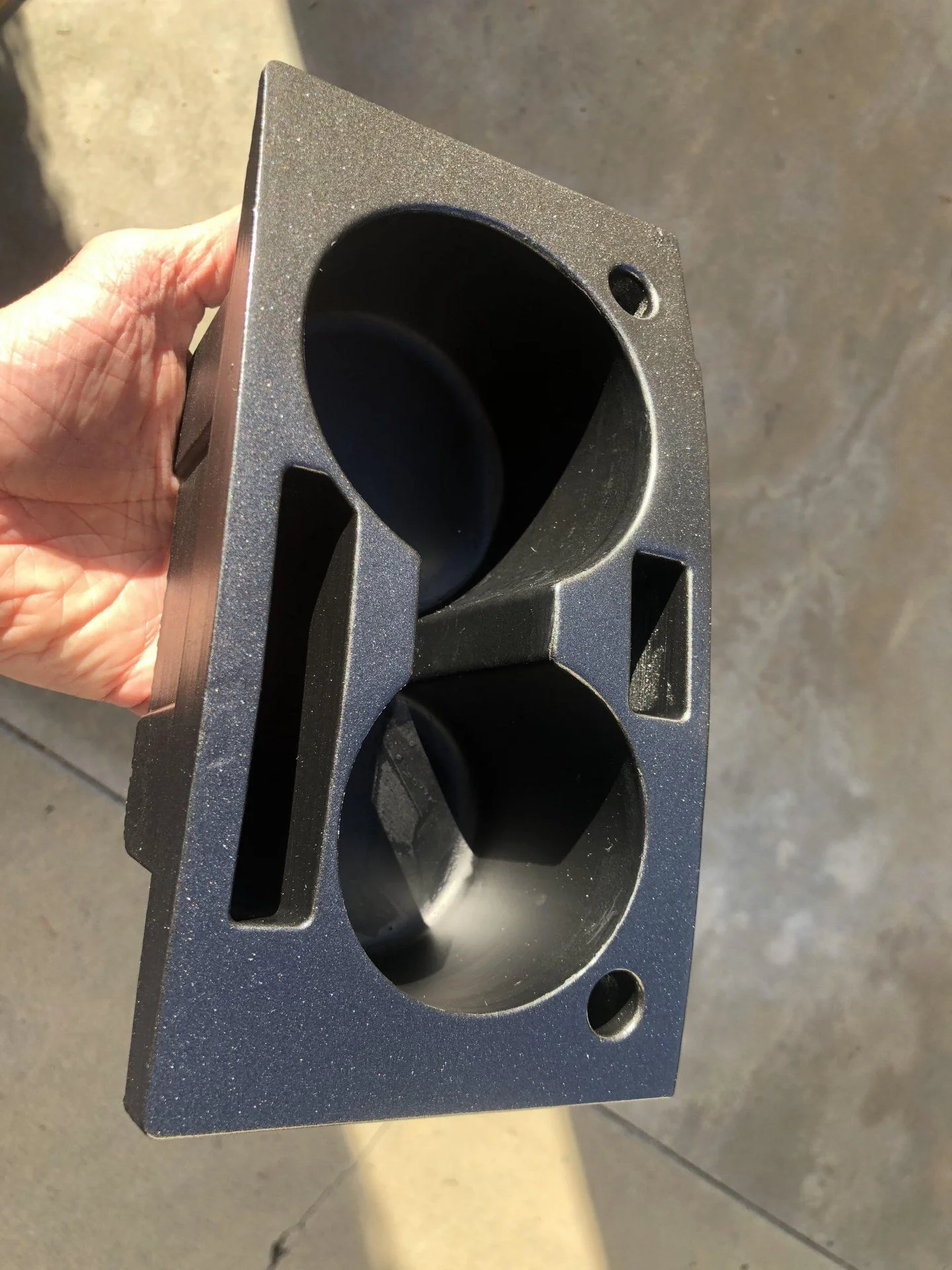

Got a 3d printed cupholder from BH3D Printing recently, and just finished putting a few coats of Superwrap on to shine it up a bit. For anyone who has removed the cupholders - any removal/installation tips? When looking at the FSM it looks like there removal of the e-brake trim precedes the removal of the cupholders. I do have a trim removal kit, but was wondering if there were any words of wisdom before I tried as I don't want to scratch anything up...
Just pull it straight up. What are you doing with the old one? I need a replacement .
Thanks for the reply. So just pull the stock cupholder straight up, with all other trim left in place?
Assuming the BH3D version works out I don't see any issue parting with the stock one.
What year is the truck? Might be a little tight sense it's the first time but yes. You can use the cover when it's open to pull. Gingerly.
Copy that, thanks. Truck is an 08. I'll let you know when I have the stock cupholder out.
Out of curiosity - are you going back to the stock cupholder from a BH3D version?
I put a crack in the oem one I have now . It looks like a silver colored plate in the 14. BH3D is good Sh$t.
You will see the E brake handle & cable. If your cable is at all stretched the adjusting nut is right there under the cup holder. I know there is another thread around with the same info.
