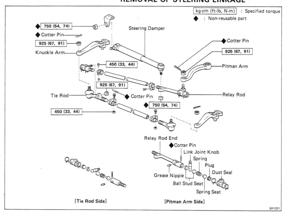

I’m getting ready to replace my tie rod ends with the kit from SOR. This is the first time I’ve ever done this! I have a tie rod end removal tool…a torque wrench. Now….what else should I prepare for?
Also, does anyone know the torque specs for these castle nuts? A quick google search revealed nada.
Thanks!
torque for the nuts is shwon in the rectangular boxes. See the legend at the top of the graphic for the units associated with each number. Looks like Tie and Relay rod ends are each 67 ft-lbs. steering damper ends are 54 ft-lbs.
A pipe wrench or a pair of large channel locks comes in handy for turning the tie rods to dial in the alignment.
Be prepared for the old TREs to not want to come out of the tie rods. As always, heat, PB Blaster, and a solidly-mounted bench vise will help get them free. I applied anti-seize when reinstalling.
