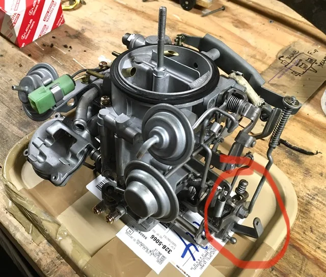

It seems like there are a lot of things that can make the throttle sticky. Maybe yours is different but I had this issue off and on for years and did not figure it out until I had my carb rebuilt by Marlin.
The hanger on the carb for the throttle return spring was bent, not a lot, but enough. Probably like that when I got it, and the throttle would stick like you described every so often. I did all kinds of s*** to fix it (not realizing the hanger was slightly bent), including lubing the linkage, replacing all the springs, and even shortening the long shaft on the linkage. None of it really worked.
I pulled the carb (for other reasons) and shipped it to Marlin, and when it came back the hanger was even more bent. Not his fault - it was packed well but FedEx really threw the box around and that hanger is really vulnerable.
ANYWAY… I re installed the carb and ran it like this and it really stuck, right from the get go. Finally noticed the bend and once I straightened it out (should be plumb and level on it’s two planes), the problem went away, never to return.
PS: I also made sure the return spring at the carb was the actual OEM spring. I think this matters. It’s NLA but I got a used one from Cruiserparts for $10.
Pictures would help a lot. I’ll add some when I get a minute.
Adding some pics for @FishTown:
Here's a nice clean rebuilt carb with a bent spring hanger, courtesy of Fedex. Yeah I should have noticed but that hanger was bent when I got the truck in 2010, so it never really occurred to me. If you have your carb off and it's moving around the garage, and especially if you ever ship it, this gets bent really easily.

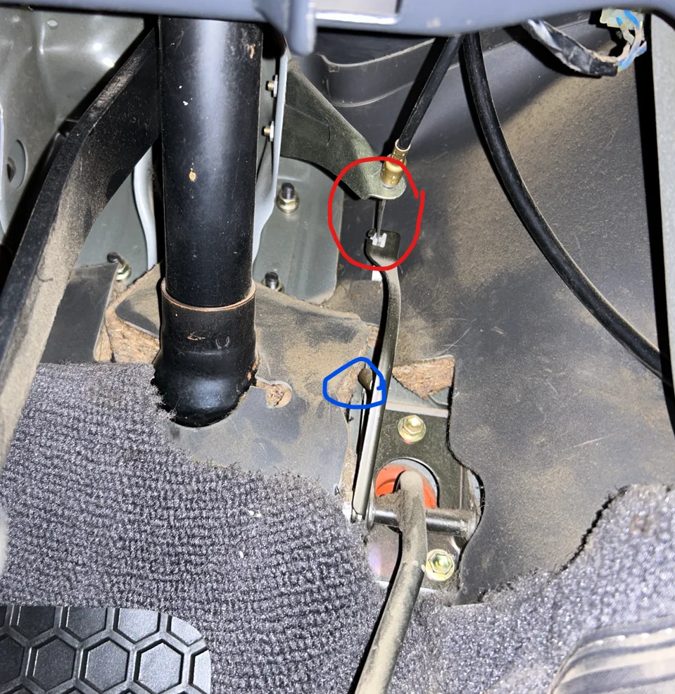

I keep looking at your "missing parts" video and it's really hard to tell what is going on there. Yes there is a hole in your firewall, but I can't really tell what's going on with the upper arm of the accelerator pedal. It looks like there might be something that may be restricting movement.
Below is a picture of my accelerator pedal linkage. The spring is circled in blue. I have a hand throttle accessory which is the cable attached at the top circled in red. If you don't have the hand throttle then you won't have the cable. There will just be a hole at the upper end of the pedal linkage.
