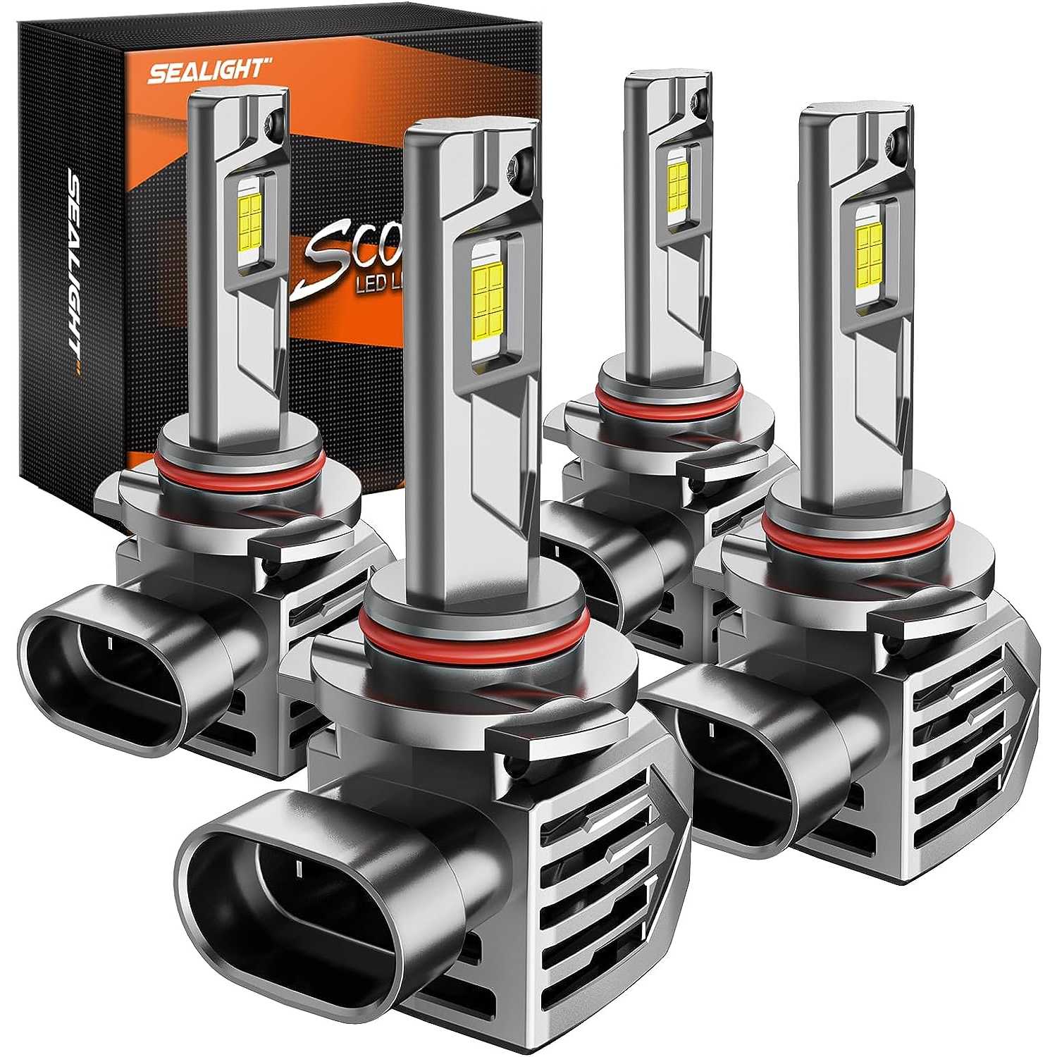

Sealight S7 Set, Total Cost: $172 Usd After Taxes

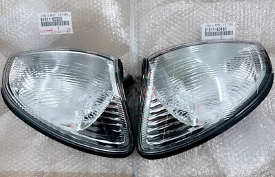

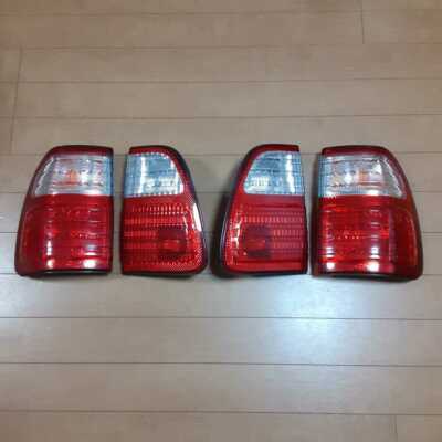

Also Side Note, Does anyone know who i can buy these type of Tailights/Turn Signals From? i remember seeing someone sell the Clear Turn Signals at one point but have forgotten who it was, i have searched on Ebay to mostly find them in the High $200-$300 Range, Info is greatly Appreciated. (Photos are not Mine)

I just installed some Diode Dynamic led bulbs ($150ish).
They suck. The light cut off is pretty crisp with a decent pattern; however, the output is way worse than decent halogen.
Stick with good quality halogens or splurge for the retrofit. I think anything else is a waste time/money.

If you are looking for the clear corner lamp, that may be me. Been selling the clear corner lamps for the past 10 yrs now.
