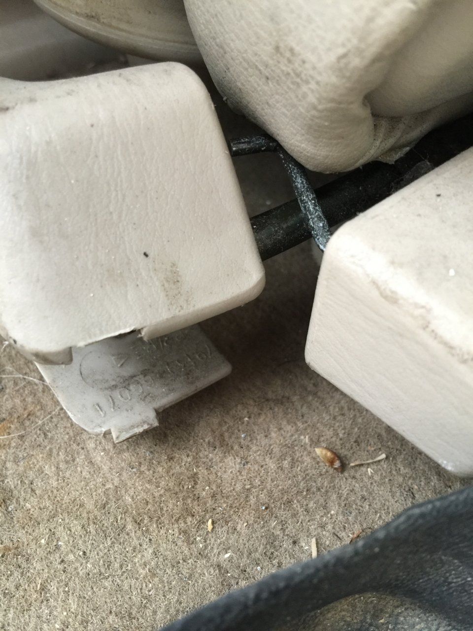

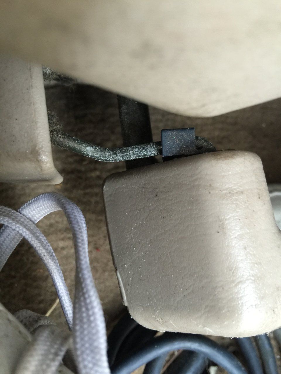

There is a metal connecting rod that goes into backside of the handle with a plastic retainer. One of mine is missing the retainer and the handle won't release the seat to slide back until I put the rod in the hole on the back of the handle.
Rod with retainer:
Rod missing retainer:
Hopefully, you can see those rods and just need a couple plastic clips for the fix.
