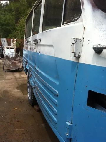

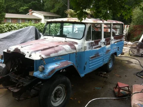

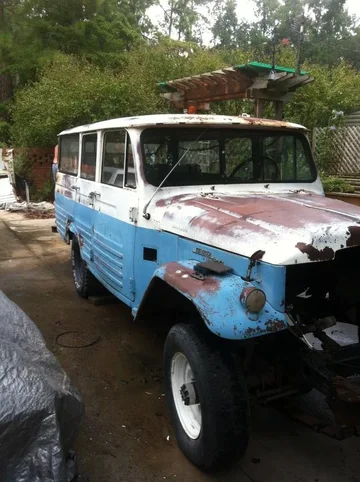

Our final object for the weekend was to preserve the faded patina look of the exterior paint job. It has so much character to it we couldn't bring ourselves to paint over it and instead are committed to keeping her as she appears now blemishes and all.
I picked up some tips from some other car sites on how to "preserve patina" I found that you can use CLR mixed with warm water and a Scotch Brite green pad to remove basically all surface rust and rust stains. After that you apply some buffing compound to bring back the faded paint and then finish by applying boiled linseed oil to protect and exposed metal from rusting again.
You can see our results below :cheers:
Test panel on drivers door
Passenger side prior to CLR
CLR in action, stuff is amazing :cool:
Driver's side
