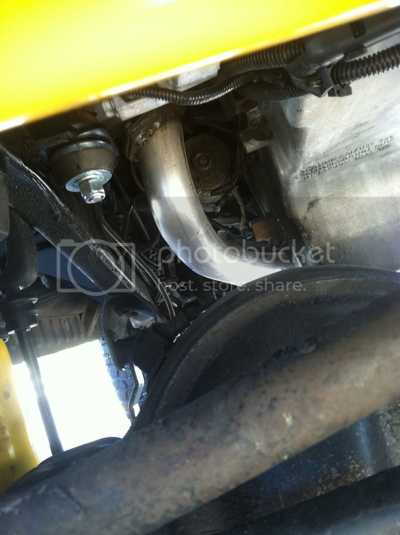

This may be a strange question but is there any reason as to why you have a catalytic convertor? Just wondering I thought there was better exhaust flow without them. My truck dose not have one but if there is good reason to have one then I guess I can put one on.
My truck is not emissions exempt yet here in Boulder County. They pushed it out to 35 years I believe. So I have to have it for that reason. :(

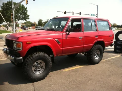

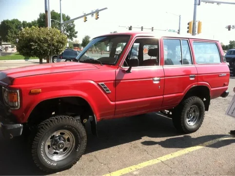

After. BFG KM2's 35"x12.5"x15" Giggity
Nice! What offset are your wheels and are you experiencing any rubbing?
Looks to be factory wagon wheels. If so, was there no concern from the tire shop about mounting a 12.5 wide tire on them?

These are stock FJ60 wheels. I belive they are 3.5" of backspacing. There is some mild rubbing at full lock. I may get a 1.5" spacer from Spyder Trax. But I'm not 100% on getting them yet. The shop had no issues mounting the tires up, and didn't mention anyting about them not fitting on the stock wheels. I would eventually like to get FGhey Cruiser wheels as they are 17's. But if I do get them I will HAVE to get the wheel spacers....so..... :shrug:

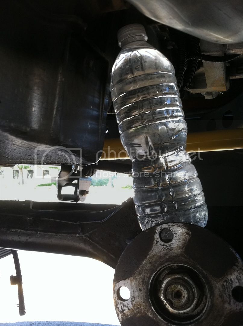

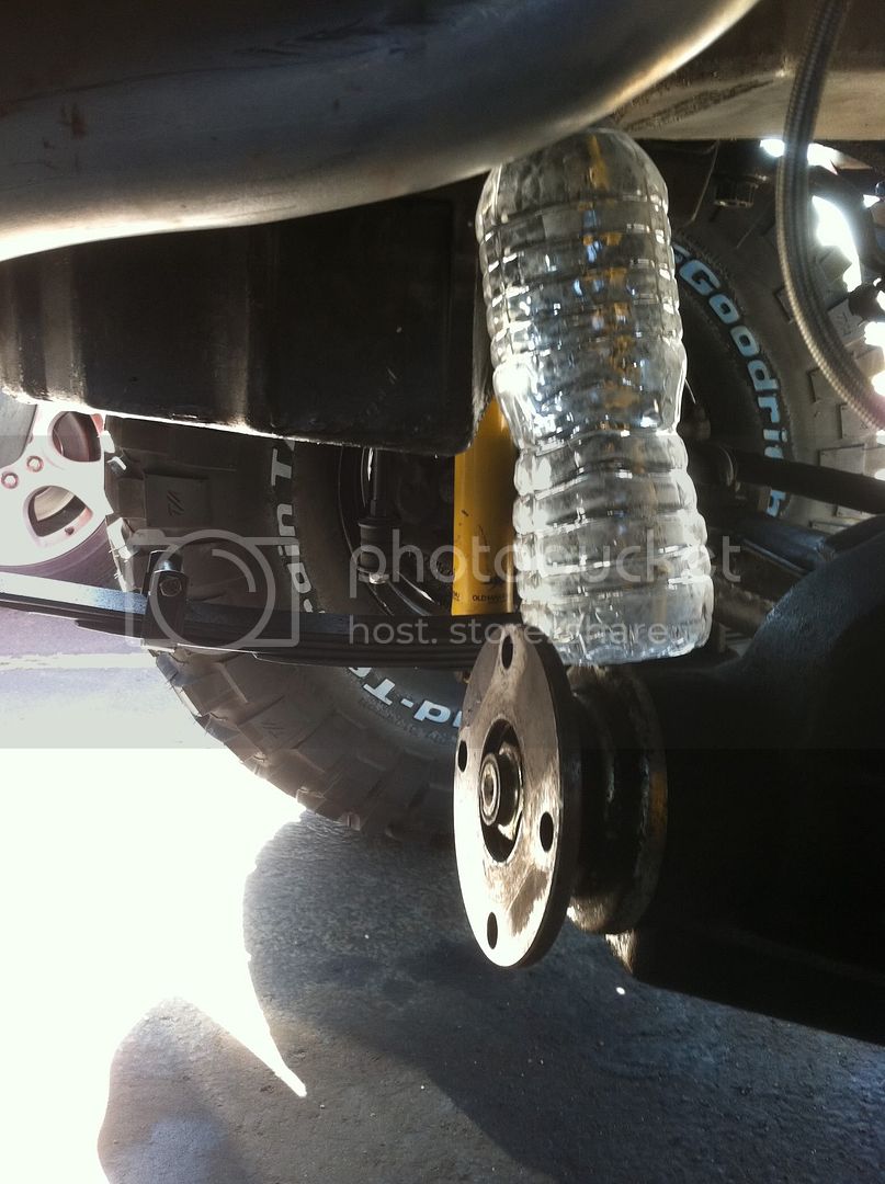

As for distance between the oil pan and the front diff....there is plenty of room between the pumpkin and the pan. But the drive shaft is unfortunetly closer than I would like. I dont have my front drive shaft in right now as I need to get it lengthed because of the lift. Here's some pics for a visual reference. The only thing I had for some sort of size reference was this water bottle. lol
From the front:
Side:
Rear:

On the transmission, I'm useing the H55, so shouldn't be a problem, but the 55's have a height issue with the 5.3. Good to know your lift was enough to solve the problem.

Before the lift I only had maybe 1" between the pumpkin and the bottom of the pan. The lift was a must. I probably could have gotten away with a 2" lift and the F body oil pan. But....why lift 2 when you can do 4? ;)

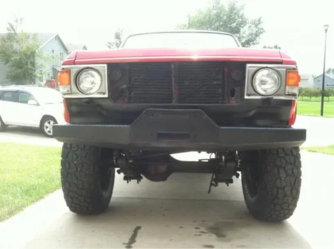

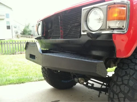

Got the bumper finished up and mounted today. I'm very happy with it.
Hey, I met you on the Seven Mile Creek trail today. It looked like the "Therapy" was working great. You did a great job on that truck, nice job on that bumper.
I was driving the silver and grey two tone 62 with the diamond Rax. It was a good day on the trail.
