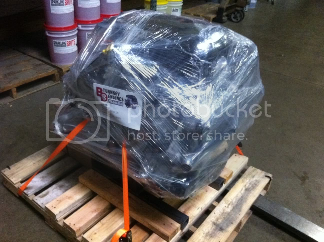

I picked up the 5.3L Vortec from Bryan with BD Turnkey Engines over on pirate. He got me a 2002 out of a Chevy Silverado 1500 with 90,000 miles on it. The compression was good across all cylinders and it had plenty of power to spare. He wiped and reprogramed the ECM to my specifications. Did a great job and shipped me a quality engine.

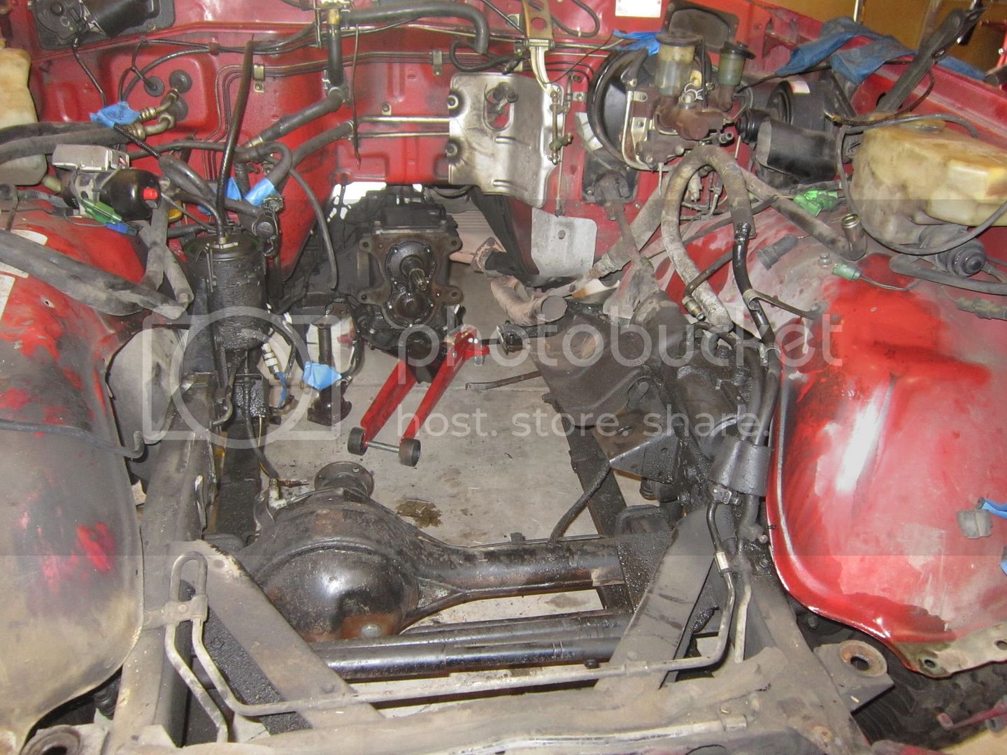

So I pulled the old tired 2F out of the engine bay!!!
She came out pretty easy and "clean". FYI clean is a relative term. lol. I spent a lot of time labeling everyting. That's the blue tape you see in the pictures. Taking bolts off putting them in ziplocs and labeling what they came off of. It took FOREVER but it made re assembly and wiring so much easier and well worth it!!!

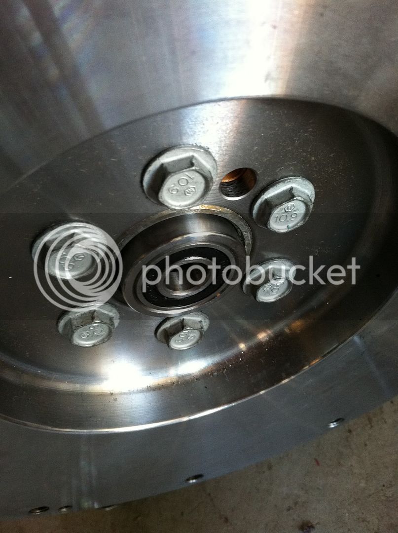

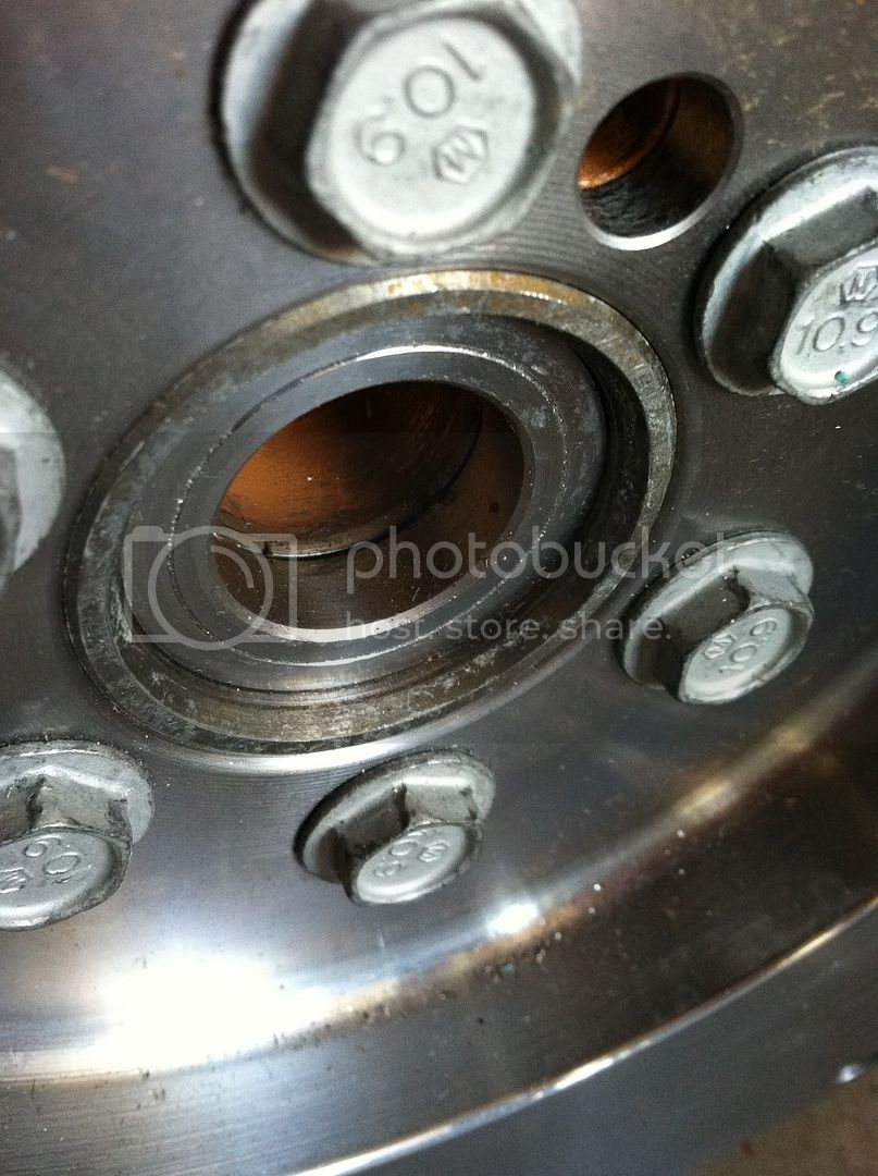

I was a bit lacking in taking pictures as I was doing work as I was motivated to get it done. lol But I did run into a few speed bumps with the Vortec adaptation to the Marks adapter. According to Advance Adapters I needed to put a pilot bearing spacer in before the bearing itself. Well that was a disaster as they were wrong.
bearing spacer installed.
the pilot bearing installed as far as it would go in with the spacer....ugh
as there wasnt any room to get a pilot bearing puller in there to remove the spacer I had to weld a nut to the spacer. Then use a slide hammer to get it out. I was pissed. I reinstalled the pilot bearing as it was intended with OUT the spacer and it worked great.

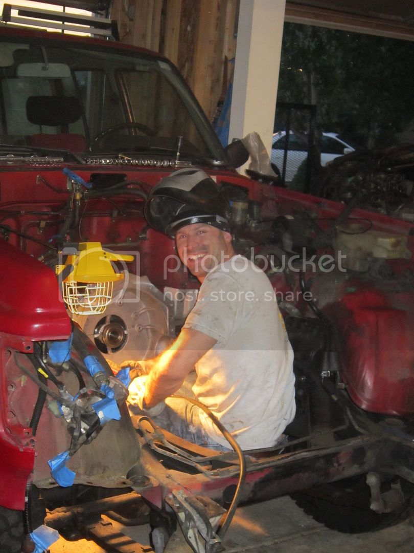

I then did a dry fit of the Vortec to determine the location of the motor mounts.
I then removed the engine after tacking in the motor mounts and permanitly burned them in.

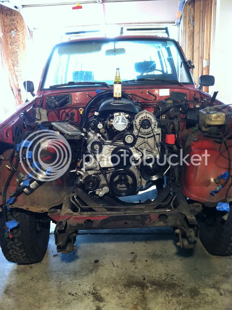

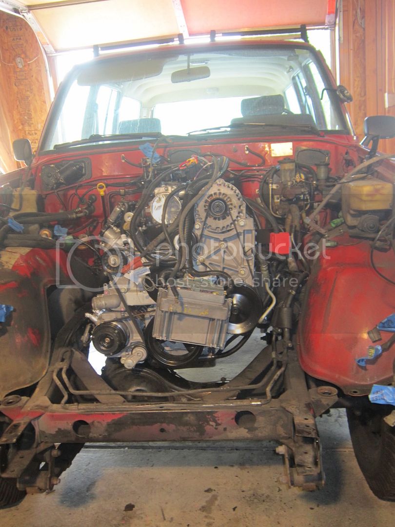

Now that the motor mounts were in the engine could go in permanitly. It took some wiggling but I eventually got it in there and bolted up!!!
This was a big step for me. The only probelm was that with the engine in there was only 1" between the oil pan and the front diff. yarg. So I then ordered a 4" OME lift kit from Man-it-aint-free.

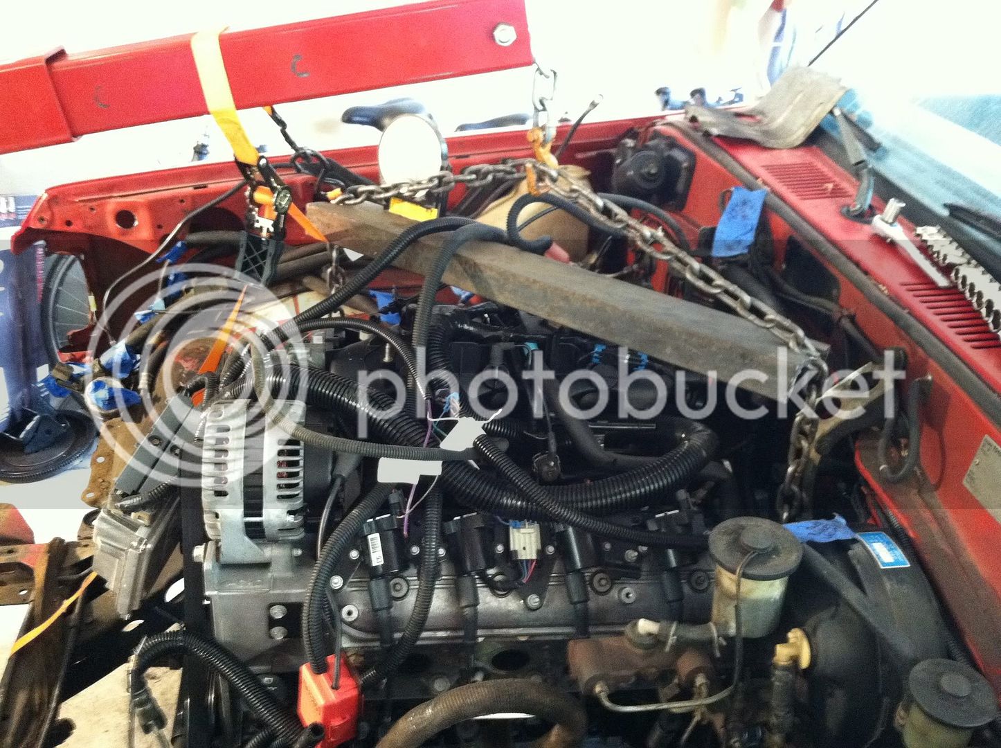

I then spent many hours just connecting plumbing and wires to the new engine. I got a power steering pump hose manufactured at Tubes and Hoses up in Loveland CO. They did a great job. They took the stock connections from the FJ60 gear box and the connections from the GM Power steering pump and merged them into a single hose. They also did the same for my Air conditioning hoses. They do great work and if your in the front range area I suggest you take all your business there. Great guys with solid very very resonable prices!!!

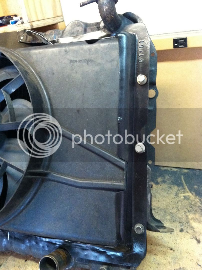

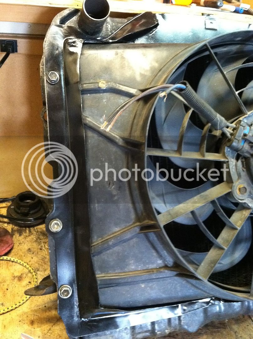

The next thing to address was the fan as the Vortec didnt come with a mechanical fan and Bryan at BD Turnkey Engines had wired the ECM for a high/low electric fan. So I ran over to the local pull-n-save and grabbed a fan out of a Ford Taurus. and FYI the slim 2 speed fans are in high demand and only available in '91-'95 Taurus'. There was only 1 in the entire lot and there were about 35 different Taurus'. lol
After picking up the fan I wanted a way to cleanly mont it to my radiator with minimal fabrication. So I ended up using the stock fan shroud to mount my fan to the radiator.
This worked out great and was allows for great flow through the radiator!!!

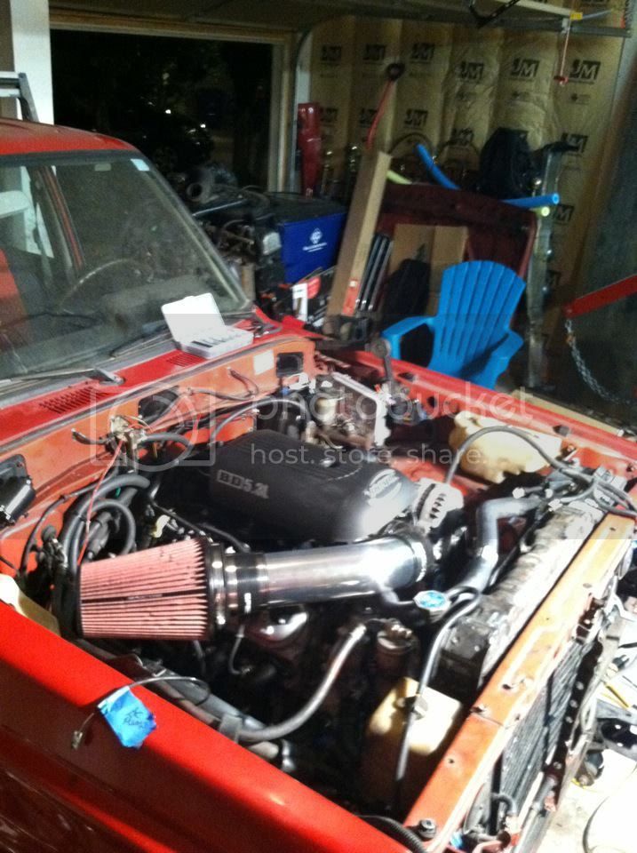

After getting the fan done it was time to button everything up.
as you can see in the pics above I moved the battery over to the drivers side and moved the over flow container to the passenger side to make room for the K&N air filter, which is now placed just behind the passenger side head light. That sucker is huge!!! lol

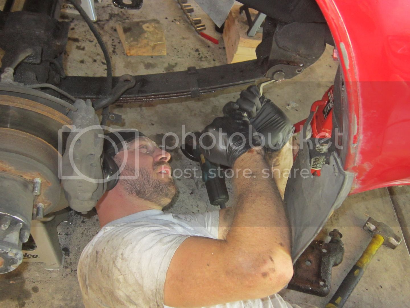

I had purchased an OME 4" lift from Man-a-fre.

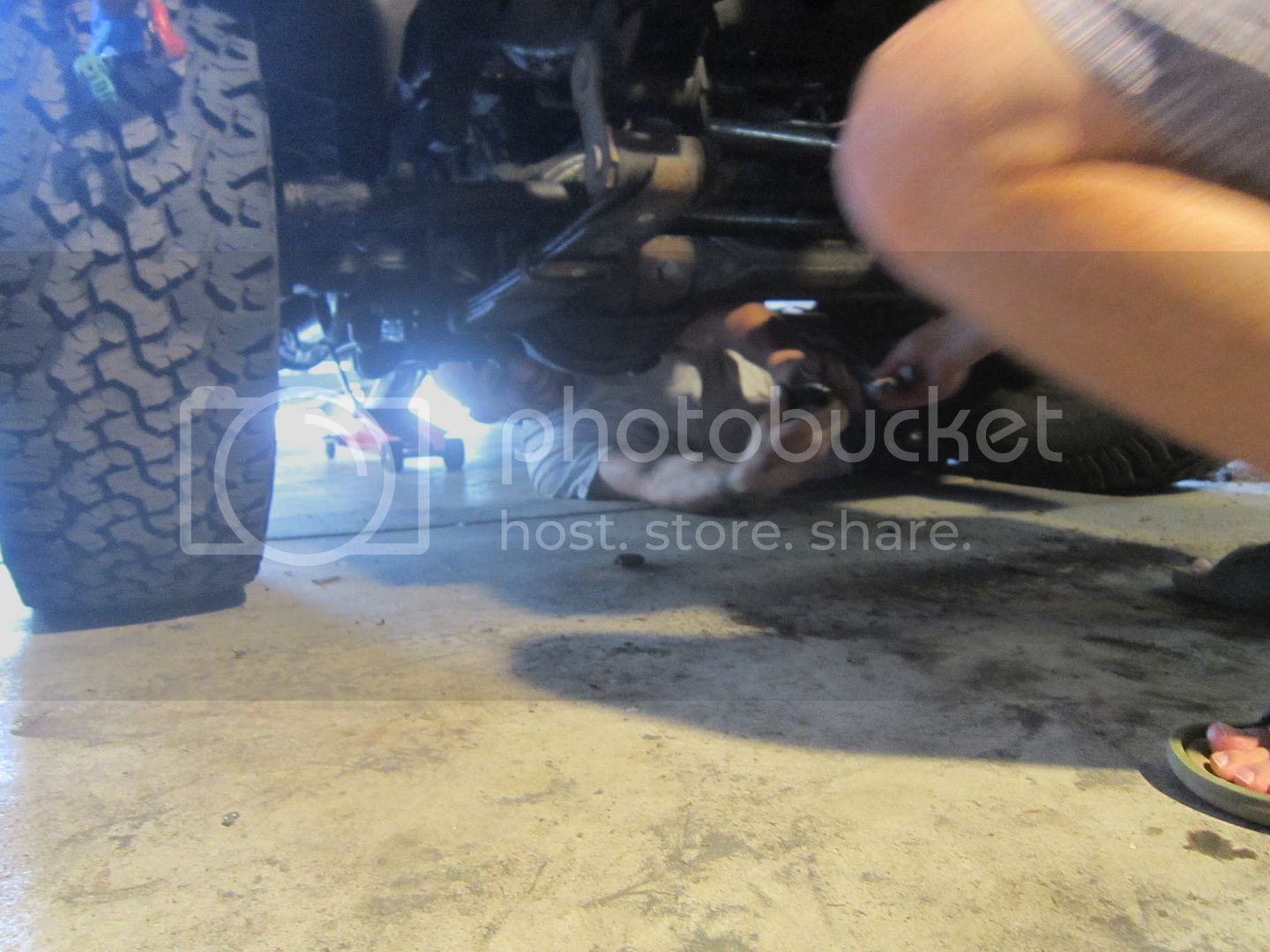

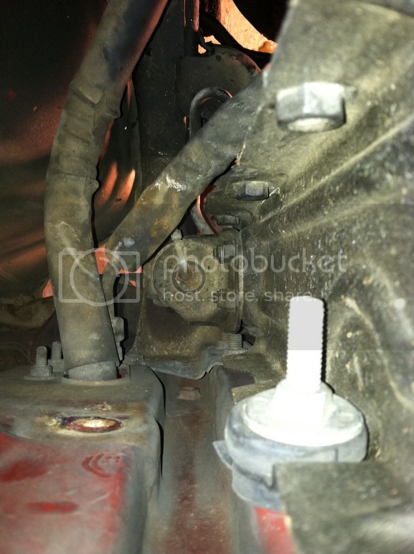

Over all the install of the lift went well aside from a few hiccups. Removing the old springs was the biggest bitch of the entire install. The spring pins were frozen in to the old bushings at the fixed end of the spring pack on both the fronts and rears. I ended up having to cut 3 of the 4 spring pins out.
my son Logan helping me out and handing me tools.
Once I got the rear springs/shocks and driveshaft in I started on the front. I got it all done but with one hiccup. The kit was missing a set of FJ60 greasable spring pins. After some "colorful" converstaion with the owner of Man-it-aint-free I was able to get the spring pins installed a couple days later.
The lift is sexy as hell.

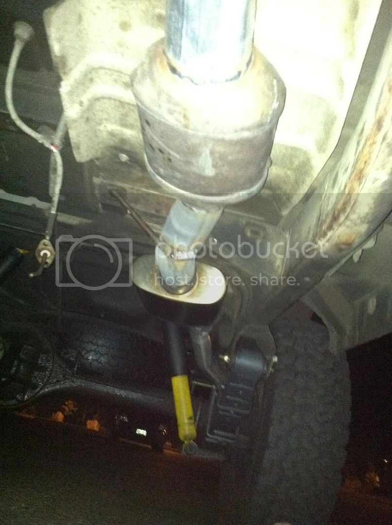

At the point of this picture the exhaust had not been done yet. I ended up taking it to Ken's Muffler here in town. They did a good after I had them re route the exhaust because the mechanic didn't speak very well english and didnt understand what I had said. They put in all the pipe from the headders to the tip. INitally he bent the pipe from the passenger side headder infront of the oil pan instad of behind. When I saw this I explained to him that wouldnt work as when I'm wheeling the differental would rise and crush the pipe against oil pan. So the next day he removed all his old work and rerouted the 2.5" pipe behind the oil pan and under the marks adapter. Then into a custome "Y" pipe that he built with a 3" out, to the Catalyic converter and then to a Magnaflow 3" in 3" out. Then having the exhaust exit just behind the rear drivers tire.

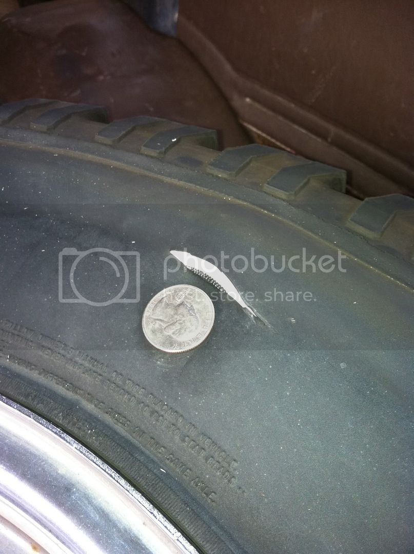

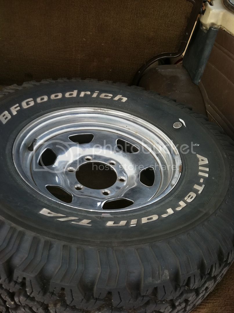

Well I ended up taking my friends car to work that night as I was running late and would deal with the flat Sat morning when I got home at 6a. Well when I got home I pulled the tire off the truck and looked for the hole in the tread, thinking I had rolled over a bolt or screw. Well I couldnt find one. So I went to put the tire in the back of the 60 and that's when I saw the scratches.......fxxxing scratches are you kidding me?!!!! Some ass hat had keyed my truck..
So now that im pissed as hell I need to get to sleep as I have to be back at work at 6p sat that night for a 12 hour shift. I go to bed and end up leavinf for work early so I can try and put some air in the tire to try and figure out where the hole was. Well when I get to the gas station and start filling it up, I see it. a 2' gash in the side wall. Are you fxxxing kidding me?!!! the same douche bag has slashed my tire. Who does this kind of crap? really?!!

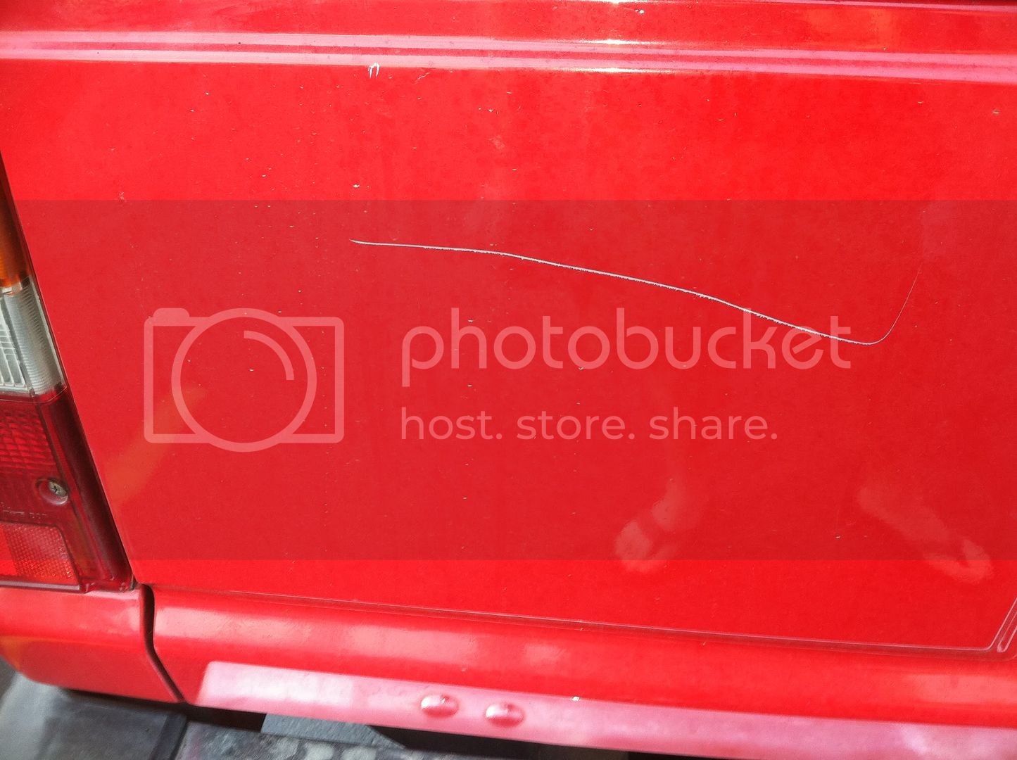

So I called the police to file a report. I fully realize that noting will come of it. I only have 1 suspect and obvsouly he's not going to just fall to his knees and convess his crimes. But non the less I filled the report jsut to get it on the books.
I'm going to try and bait the ass hat and catch him violating my "Therapy" again. I am setting up a motion activated hunting cam and leaving my tuck out side again. hopefully he'll take the bait and I can make him pay for everything.

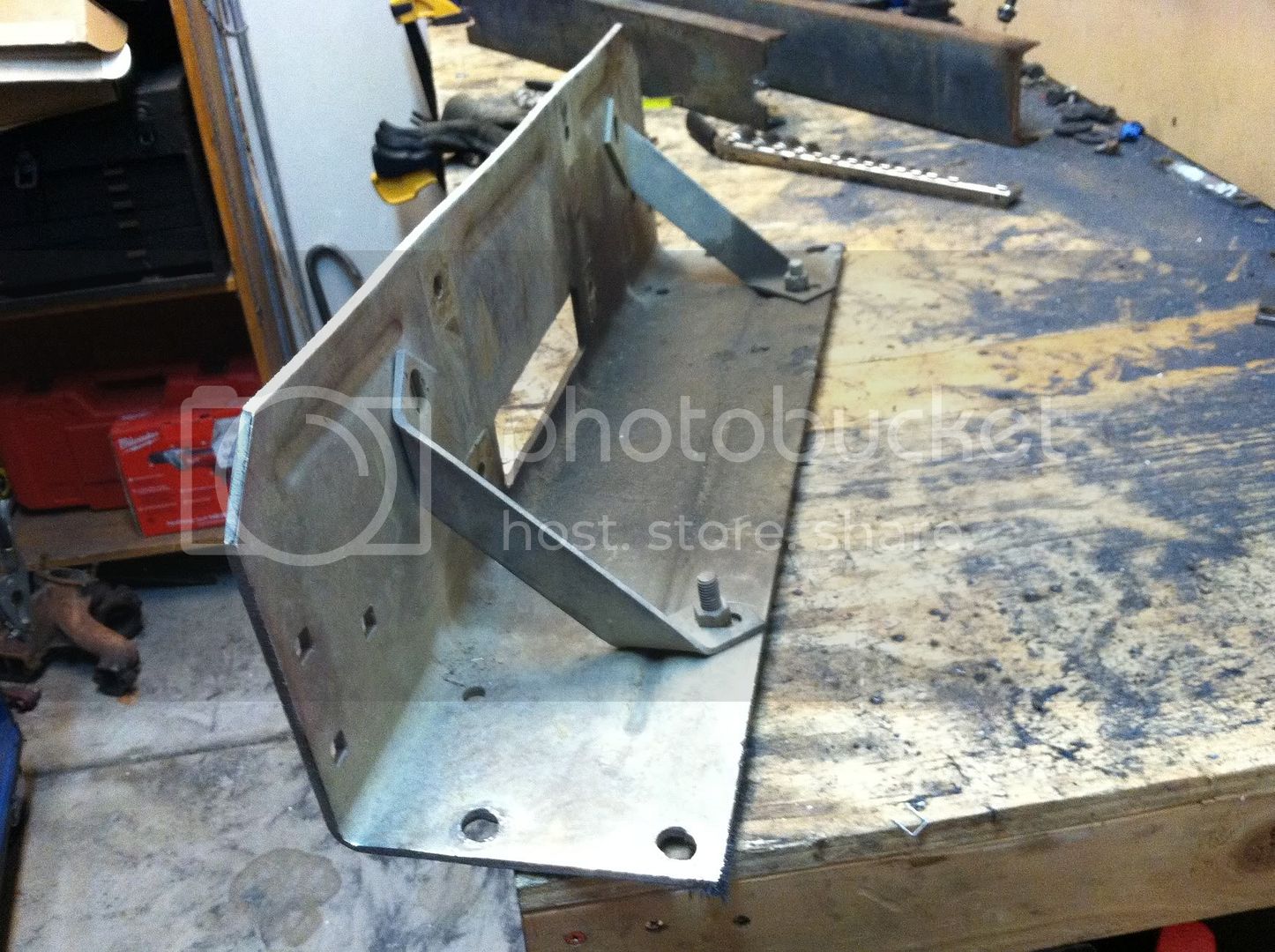

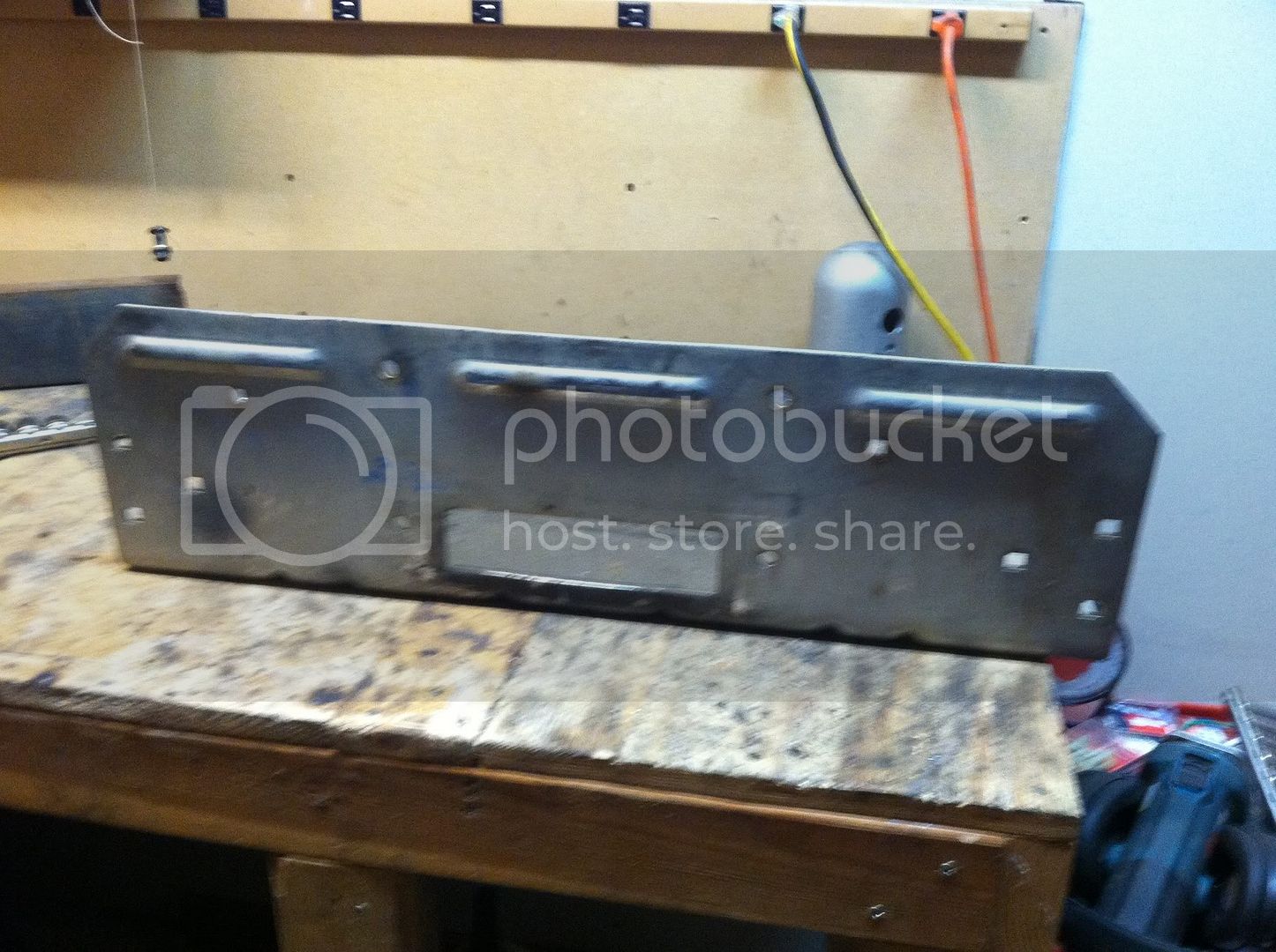

Next on the schedule is window tint, tires, and paint. I am currently working on building a new front bumper for the truck. It will hold my Warn 8274. I acutally adopting a simialr design to the 4+ front tow bumper.
I'm using a stock Heep mount that I'm modifying for this application.

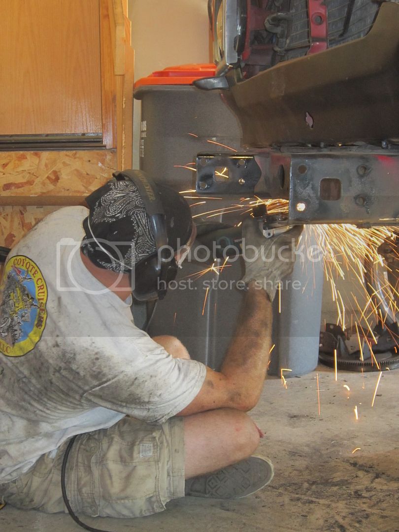

This is how I'm mounting the bumper to the factory rails. I cut and drilled mounting plates that have a bar welded between them and they bolt up to the factory holes that also hold the OME 4" shackel reveral on.
Here's the winch plate modifyed and mounted to the new cross bar.
I have now built the bumper extensions but have more plating to do on them and finish welding. More pics to come in the near future.
