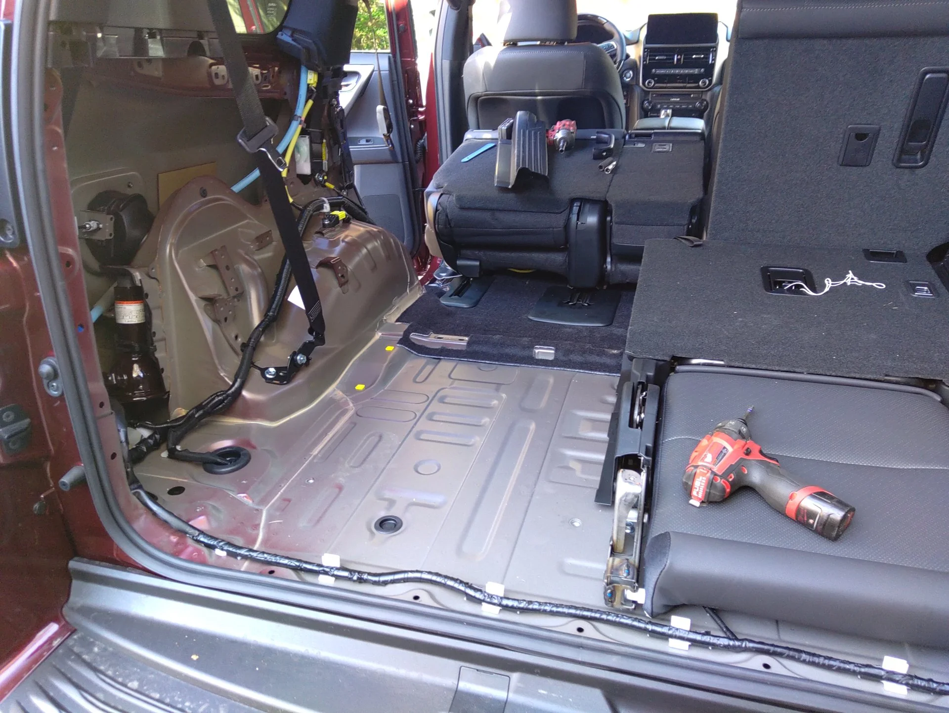

Getting it aligned today, and I'm currently at Home Depot getting the wood needed to remove the third row. Turns out that it's kind of hard to fit a sheet of plywood in the GX. Got the parts needed to hook up my trailer, so I can go back and get the plywood. 🙃

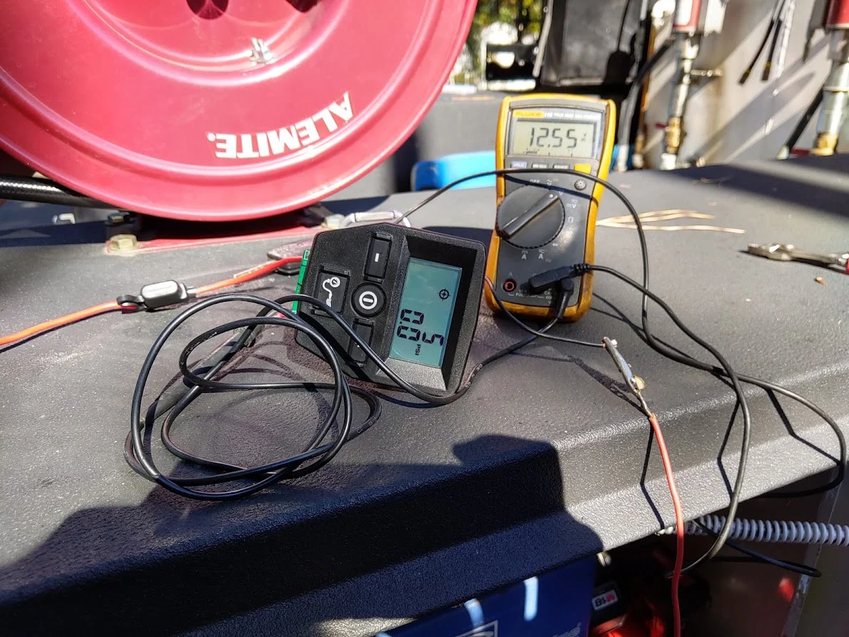

Since I'm working Saturday, I took today off. I killed some time testing out the Milwaukee tire inflator panel. Tearing the thing apart was simple, so was the wiring. Red and black from battery power, and red and black to motor. There were a couple of catches, though. The thermistor that was attached to the motor had to be peeled off, no biggie. I used a 1/4" air line union to adapt the rubber line to the air line I'll be using, a lot of massaging and lubrication was involved. There is a third wire that goes to the battery pack, this is a temp sensor circuit inside the battery. I measured the temp sensor resistance at room temperature and measured 15 kOhms. So I wired up a 15 kOhm resistor from the temp sensor circuit to battery ground and viola, no error messages. I'm getting a good 12V while "pumping" and a good 0V when commanded off. Hopefully this means that I can slap it on a relay and be good to go. After testing, I heat shrunk everything.

I get you're probably going to use the compressor for your rig, but not sure what product Milwaukee is or what your end game is with it?
With all due respect, did I miss something in an earlier post with what you're doing with this project?

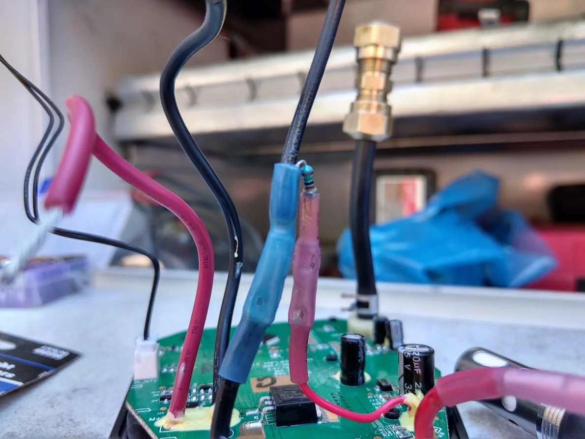

I took this panel out of a M12 Milwaukee tire inflator and I plan on wiring it up to my Viair compressor as a controller. This way I can just set my desired pressure, from five to 120 PSI, and let the panel air up a tire or tank with a push of the button. I plan on mounting the panel and a quick-connect fitting in the cubby that's in the cargo area above the jack.

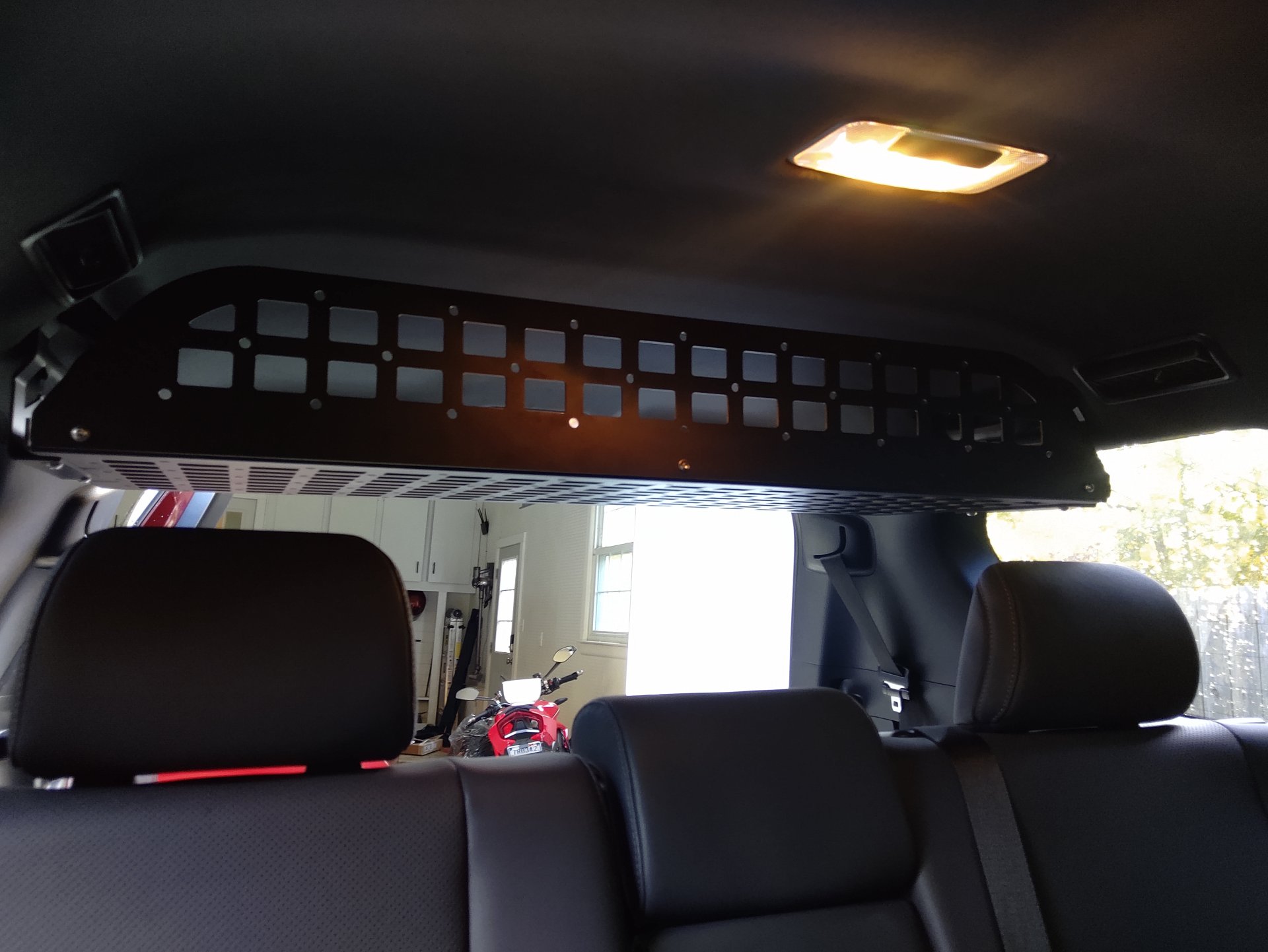

From order to doorstep in four business days, thanks to Victory for getting my upper shelf shipped quickly. I'll be installing it after work today.
Shelf is in.
I'd give it a seven out of ten.
+Beefier than I'd thought it'd be.
+Easy install.
+Tons of extra hardware.
+NO LOGO!!! It's just straight Molle panel, no Victory branding anywhere.
+Well-packaged.
+Shipped quick.
-Powder-coating is kinda sus.
-Rattled. I used some double-sided tape in between the vertical plate and the main panel to solve this.
-Why does every single damn aftermarket company include SAE fasteners unless otherwise needed? Putting SAE bolts on an entirely metric vehicle is just ridiculous.
-It sits about three inches too far forward. The third-row vents are partially blocked and it absolutely interferes with second-row headroom. I kind of knew that this was going to be the case, but I'm not afraid to drill new holes. I can see why they did it, since it lets the shelf sit perfectly in the center on the brackets. That's not going to stop me since I never really planned on putting anything too heavy on it.
For the price paid I was expecting something a little less flawed, but I'm going to be happy with this after a few tweaks.

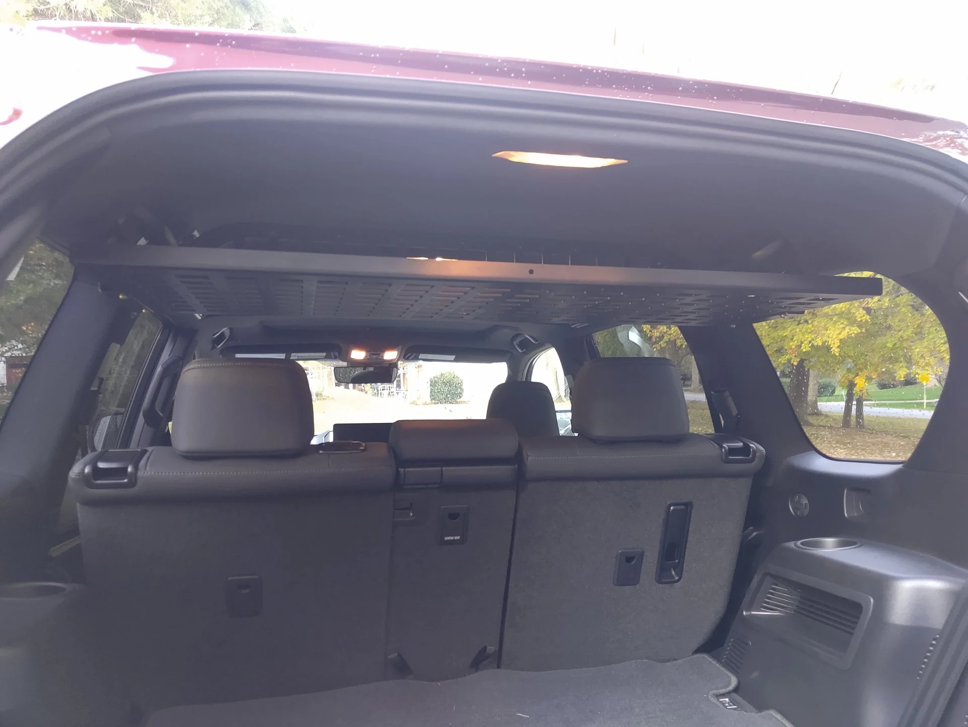

"Three Inch Mod" to the shelf is done. I don't know if anyone calls it that, but that's what I'm calling it.
The spacing for the bolt holes was *exactly* six inches, which made drilling holes three inches back a cakewalk. Final drill bit was a 9/32" bit, and all the holes lined up perfectly.
With this and the double-sided tape to fix the rattle, now this product is perfect in my eyes. Taller people will still hit their heads in the second row if they recline all of the way back, but if you're shorter or keeping it reasonable in the second row then it's no longer an issue.
Victory most likely will not endorse it, but whatever. I don't forsee an issue as long as it's not loaded like ass.

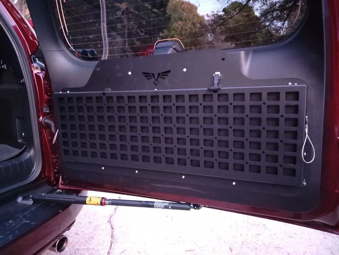

Victory fold-down table installed.
+Not too heavy.
+Doesn't rattle.
+VERY good install video.
+Exactly as sturdy as you're hoping, maybe a little bit more.
+Perfect access to door cubbies.
+Perfect clearances to load floor.
-SAE hardware. See above rant.
-I was shorted a latch, still didn't rattle, though. Time to test out the customer support.
-The final step, installing the table top, was absolutely infuriating.
-There's gotta be a better way to attach the latches than the tiny screws that are included.
Overall, worth it. Obviously I haven't really tested yet in the elements, but I don't foresee any issues with it. The MOLLE panel was slightly bent, thanks to UPS, but it was easy enough to get straightened back out. A few notes about pulling the upper side panels on the rear door: 1) Pull the panels towards the window, not towards you. Found that out the hard way. 2) Pull the little white plastic clips out of the door and then place them on the panel before reinstallation. There's a clip sitting inside my door now after I was completely done. I'm not going back to get it unless I absolutely have to.

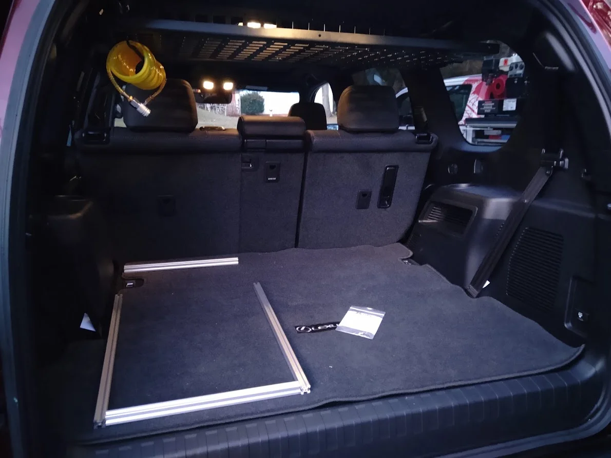

Here's the planned footprint of the fridge setup.
Ran out of daylight again, but the air compressor is completely wired up and plumbed. It wasn't what I'd call fun. I'll take pictures and write everything up tomorrow, but for now here's what my day looked like.
