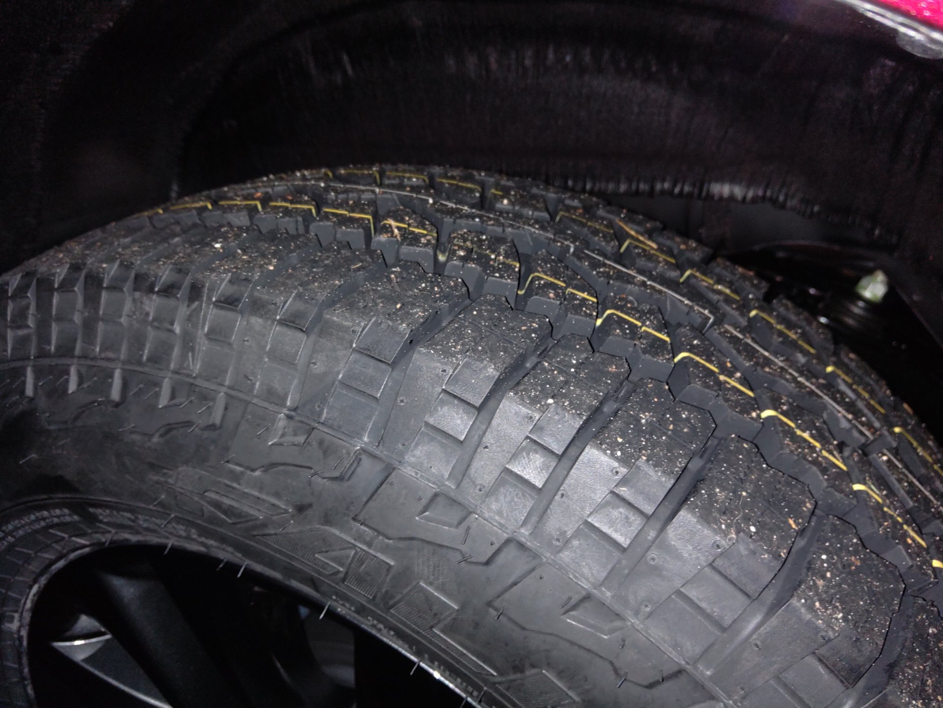

Soooooo.... .the dealer put the wrong tires on. They put on Falken Wildpeak AT3WA's and not the AT3W's I asked for.
I hate being that guy to complain about such a small difference, but it wasn't what I asked for. I brought it home anyways, but I don't know if I really want to keep them. I guess it would help if I knew just how much of a penalty I'm taking off-road.

What's the difference? And shame on Falken for making two different tires with nomenclature so close...

From what I can tell, they're the OEM tire on certain Ram 1500 trims and on G-Wagons. They're made overseas and they're more road-oriented. People seem to get good life out of them but the reviews are hard to sift through since they're so easily confused with the real things.
I'm thinking that I'm going to keep the AT3WA's. The big reason: load range C.
The regular AT3W comes as either a SL or an E range tire, three or ten ply. I had concerns with both, but the AT3WA splitting the difference at six plies seems like the "Goldilocks" place to be. It's not as aggressive as the AT3W's, and it will not clean mud out as easily, but it should be a good all-around tire.
I'd keep them too. Even with slightly less aggressive tread, you'll likely still get better traction when aired down in a load range C vs E, and it will ride better on pavement.

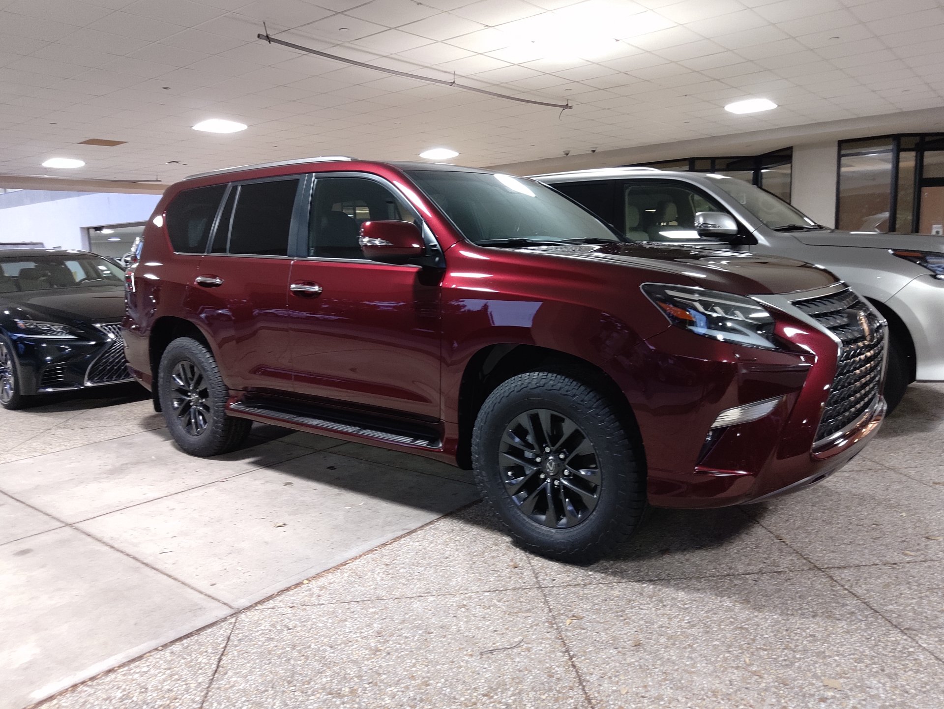

Dobinsons lift installed. 2" front, 1.25" rear. I absolutely love it. It rides better than it has any right to, in my opinion better than stock.
Front spring: C59-350
Front shocks: GS59-700
Rear springs: C59-505
Rear Shocks: GS59-705
No UCA's.
