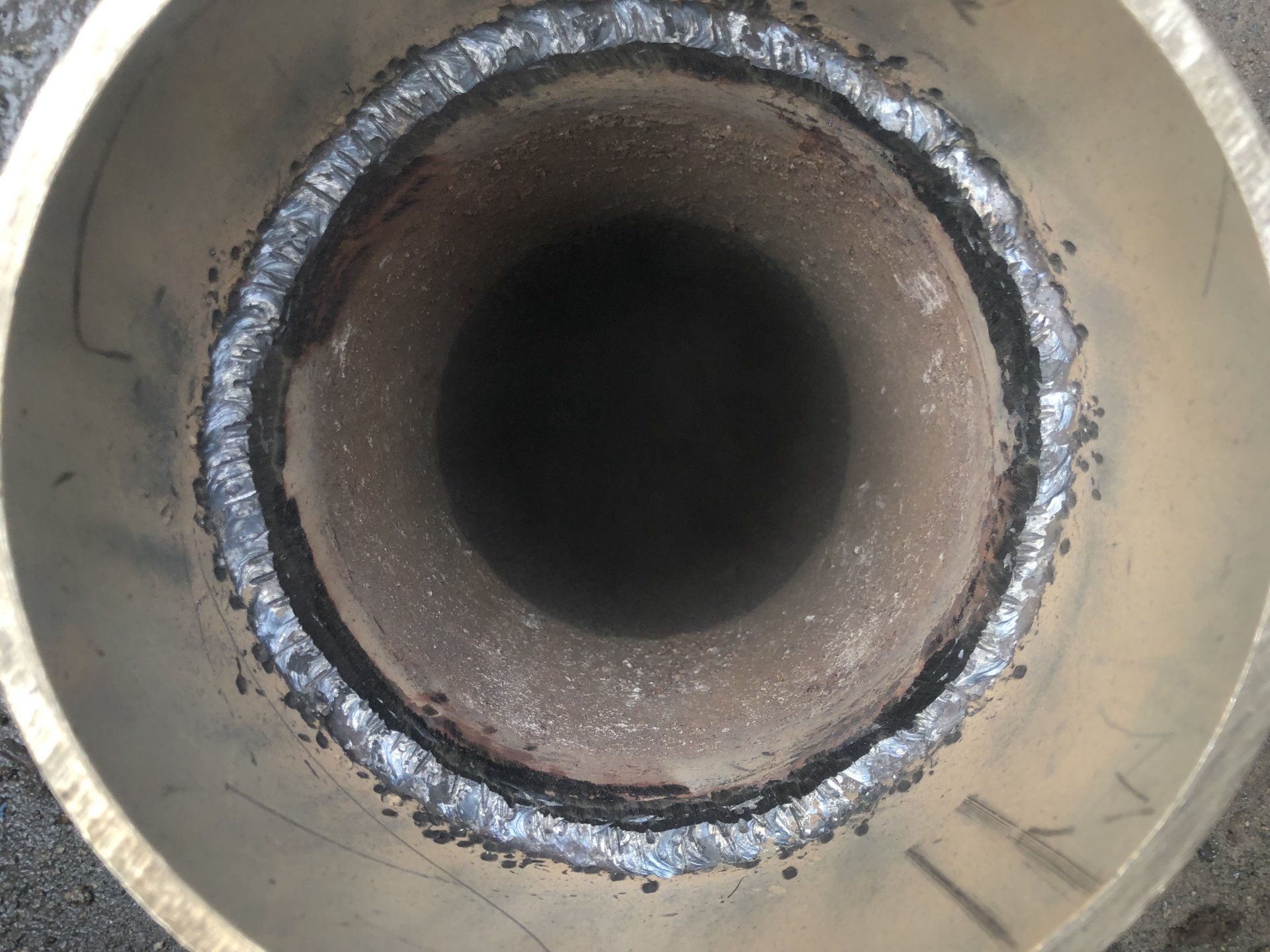

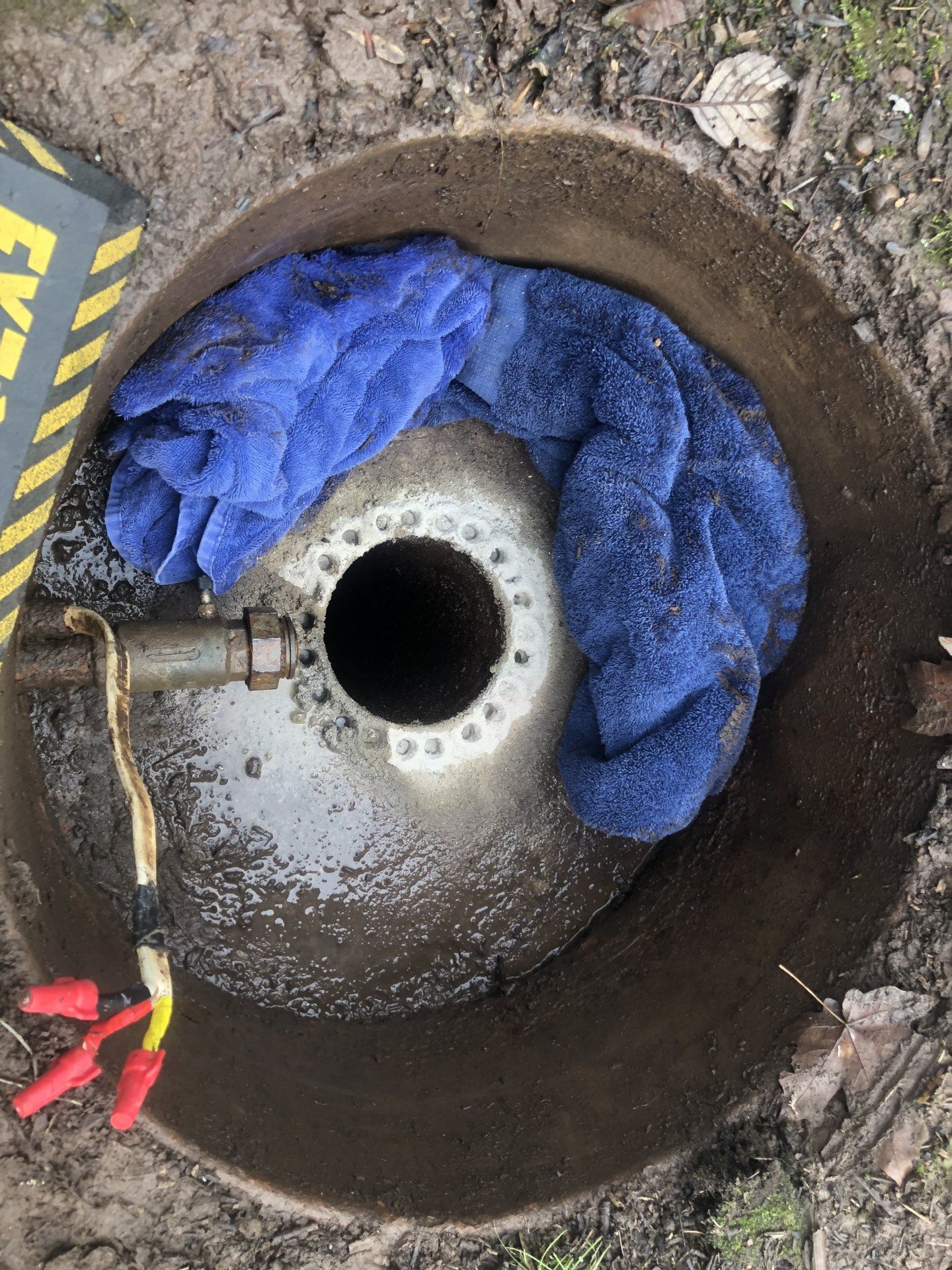

Water well has been getting dirty water into the well. They called us for a remedy. The well casing is a foot below surface in a concrete culvert. When it rains it fills with water and has been draining into their well.
Pulled well pump and the well casing was cemented to top of casing with no way to weld an extension. Used 1/2” concrete bit to drill holes around the casing to get some steel to weld a slip coupling on.
Used slag hammer to chip concrete and make a channel for ring to slide into.
Got enough steel to slip the collar 1/4” around casing.
Welded on the steel slip ring.

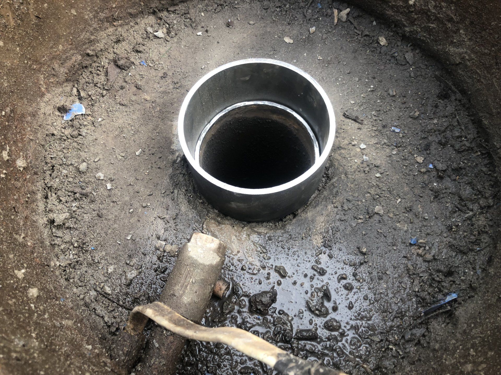

Added 2’ of 6” well casing to get well casing a foot above surface to meet code.

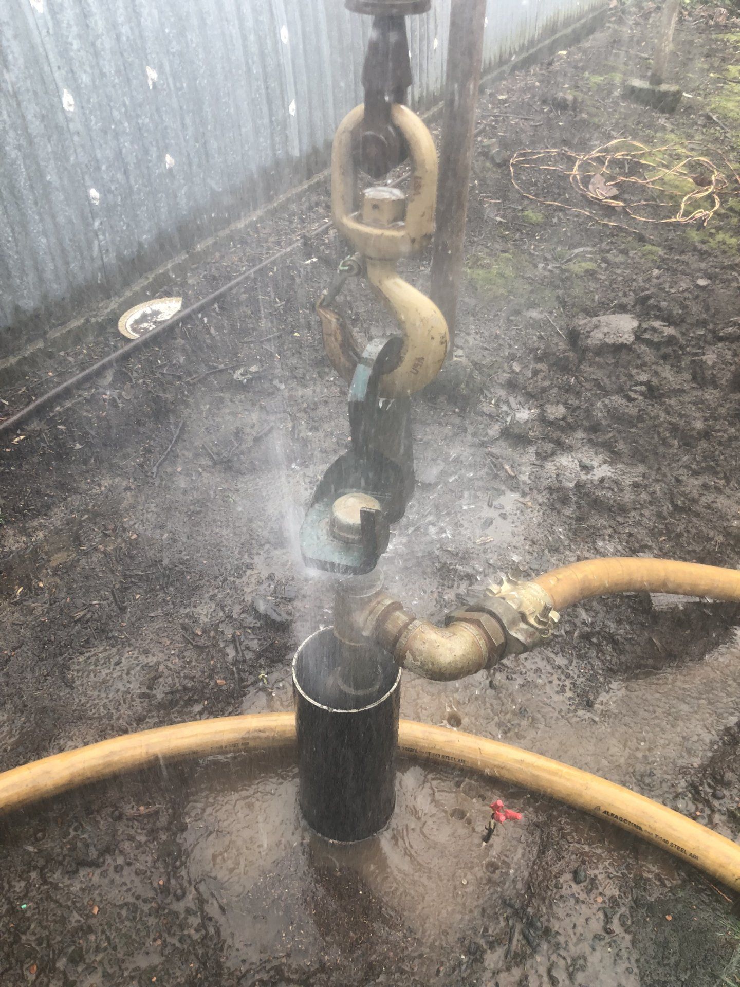

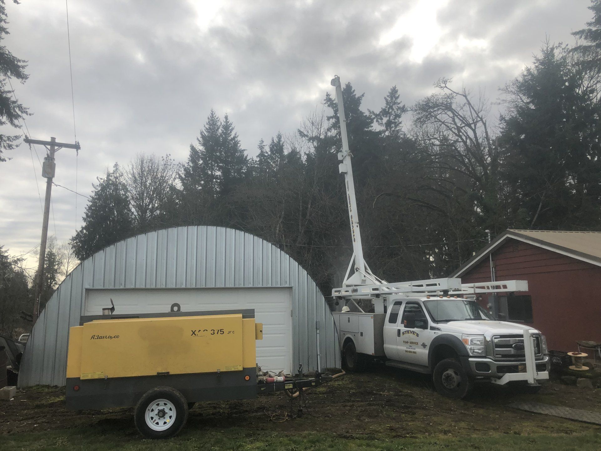

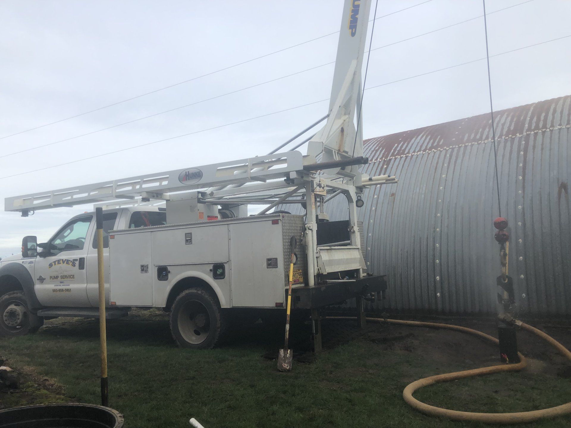

Installed 2” galvanized pipe to bottom of well. Hook up to our 375 CFM air compressor and start blowing out well. The first surge is always a good one. Well was drilled in the 1950’s so it had a tremendous amount of we’ll scale and sediment buildup.
Slowly lower pipe deeper deepening well down to original depth.
Blow well until water starts cleaning up and maximum depth is reached. After an hour of surging the water flow started to pickup and really cleaned up.
