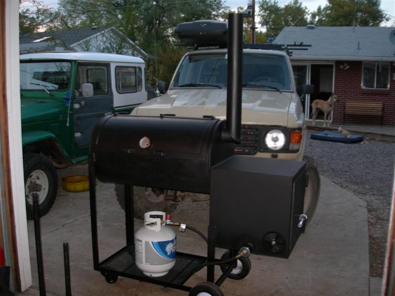

Here's my rig...
I threw it together late last summer. My goal was to have something I could burn logs in since I always used those smaller side box smokers from the HW store with briquettes.
I started using charcoal, then moved to hardwood lump coal, and then moved to this. I could never seem to get the other smokers to draft right or have even heat.
This one has a big plate/water tray underneath the cooking surface, so the firebox opens up under it. this channels the heat across the bottom of that plate, then back across the meat on top. It seems to work pretty well and heat evenly. I also added a propane lighter for the firebox.
So I gotta question.... I have been just throwing logs in there and lighting them off with the propane. When the temp gets to 250 or so and stabilizes and the logs are burning nice I throw the meat on. When I need more heat I just throw in a fresh log.
Is that the right way to add wood? Should I be lighting it first?
Also, I have been using pecan and apple since that's what I saw first at the wood place here in Boulder. I like them OK. Any suggestions?
I have only done 20 racks of ribs or so and a handful of shoulders. I am still learning the smoker. That's as far as I got then it started getting cold here.

Looks like a nice setup!
I dunno, it snowed a foot or so here a few times and it was kind of a pain. Maybe I am Lazy :D But now it is dry and getting warmer :)
REAL nice set up Rover - Adding the plate below the smoker is a great idea - keeps particles to a minimum and supposed to help reduce carcinogens through the "reverse flow" process - adds more even heat, etc.
I don't have a reverse flow, but I know that guys that do burn wood and charcoal in them. You could also always try to stack wood on the far left and push charcoal closer to the smoke box opening. As far as lighting it - I think you could always do a little charcoal in a smokestack lighter (weber, etc) dump it in and then put your wood on top or to the side if hot enough in the box. Also, electric starters are REAL popular for charcoal, but I have never used them.

If I had your rig - I would probably do a large weber full of any all wood charcoal. I'd sit a log (2-3 chunks) of my first wood on top of that weber as it warmed up. I'd dump it - let it sit for 10-15 mins or until decent temperature in the smoker, and then throw in another one foot long log of hickory on top right before I put in my meat. If I was doing a pork butt for 6 hours or so, I'd put peach/cherry/fruity in about 2 hours in. Not sure how efficient your box is, but may have to do more charcoal at that point as well, or add more wood and even earlier to keep heat up.
Nice!
I think your wood adding method is fine as long as you are able to maintain the temperature.
The baffle under the food grate is the only way to go, especially with your chimney on the same side as the firebox. I modified my commercially made smoker to have a smoke baffle.
One design thing I would have done: I would have built an ash pan so if you get a big ash buildup during a single session you can pull it out quickly.

The ash pan is something that I wish I had done... I have to shovel it out after it runs for about 12 hours. That's a great Idea.
As far as lighting the thing goes, the propane log get's it going initially.. Jamie, are you saying I should pre burn the logs like one would with charcoal?
Yeah Yooper, the temps stays up fine when I throw a log in there... I usually have a decent bed of coals going, something like 4 logs worth. Then after that I usually throw a log in every hour or two. When I add the logs the temp stays up nice and usually gets hotter since there are more flames.
The big baffle pan works nice for catching grease and holding water also. I like to throw water in it and it will tend to boil a bit and keep it moist in the smoker. When I built this thing I knew I wanted a good baffle in it to circulate the heat a bit better.

And your smoker looks that clean? Something smells not so smoky here. ;)
Otherwise, I'd say it's a sweet rig and you did a really nice job. But I think I would have put some collapsible/removable handles on the firebox, put the solid axle on the other end, and left off the swiveling casters.
