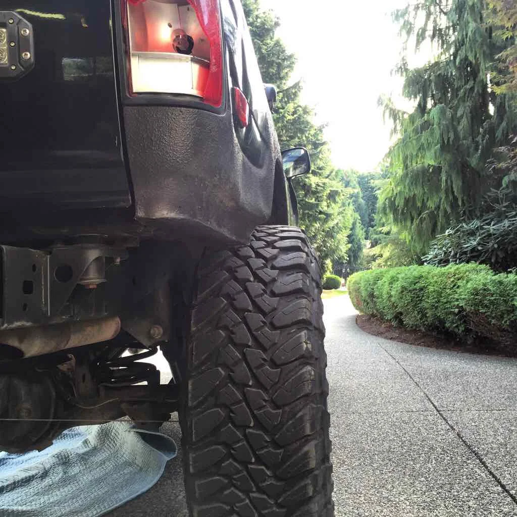

Ignore the broken taillight lol, removed about 3inches from the rear rockers to prep for custom rear tube bumper which is currently being picked away at as time allows, will be super high clearance with taillight protection of course;) hey anyone got a passenger side rear taillight they will sell me?

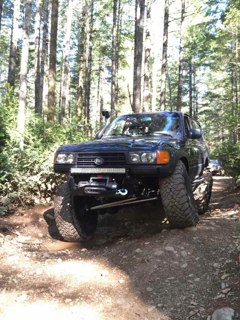

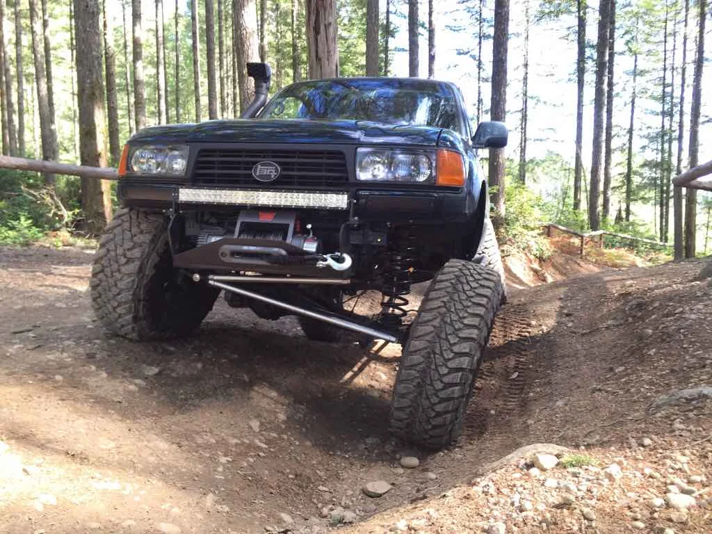

Also got a little flexy testing out the new rear sway bar extended links.

The top of that tire is allmost out of the fenderwell...

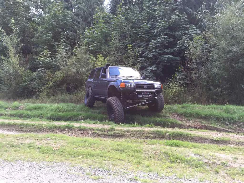

Now it's SHOWTIME.
Let's see some video action.
Have you name that thing?
The Jolly Green Giant or Green Thing...;)
