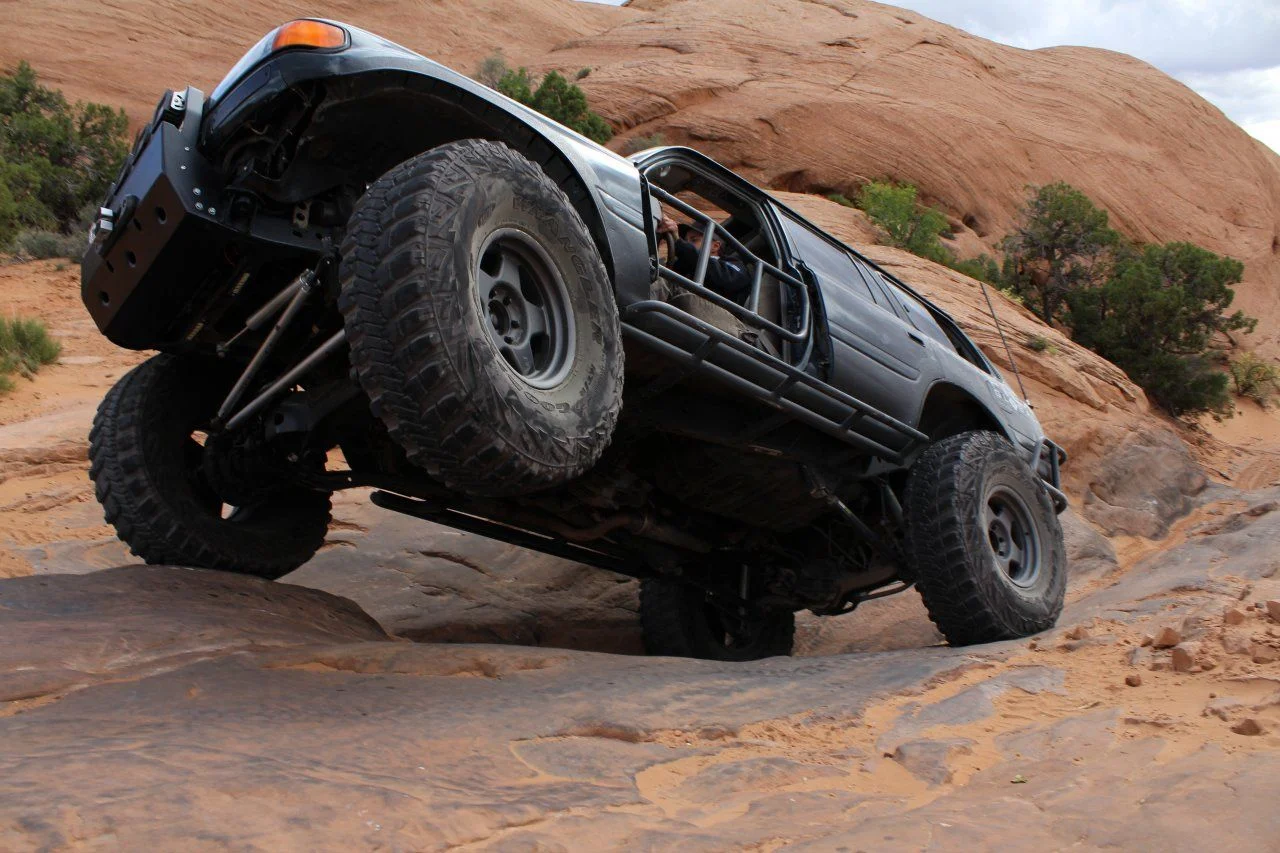

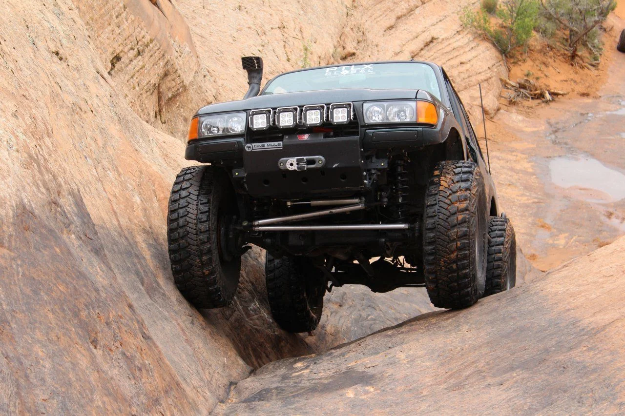

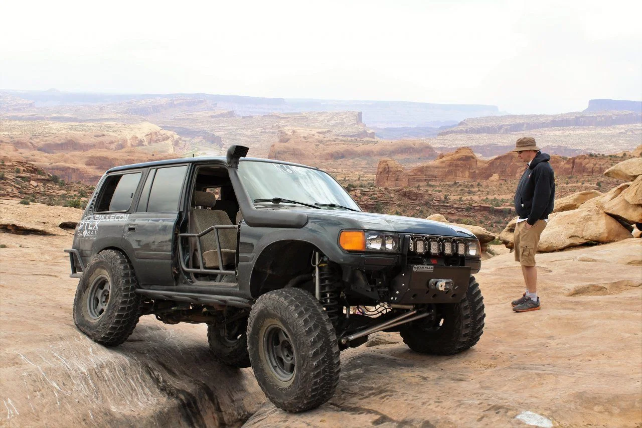

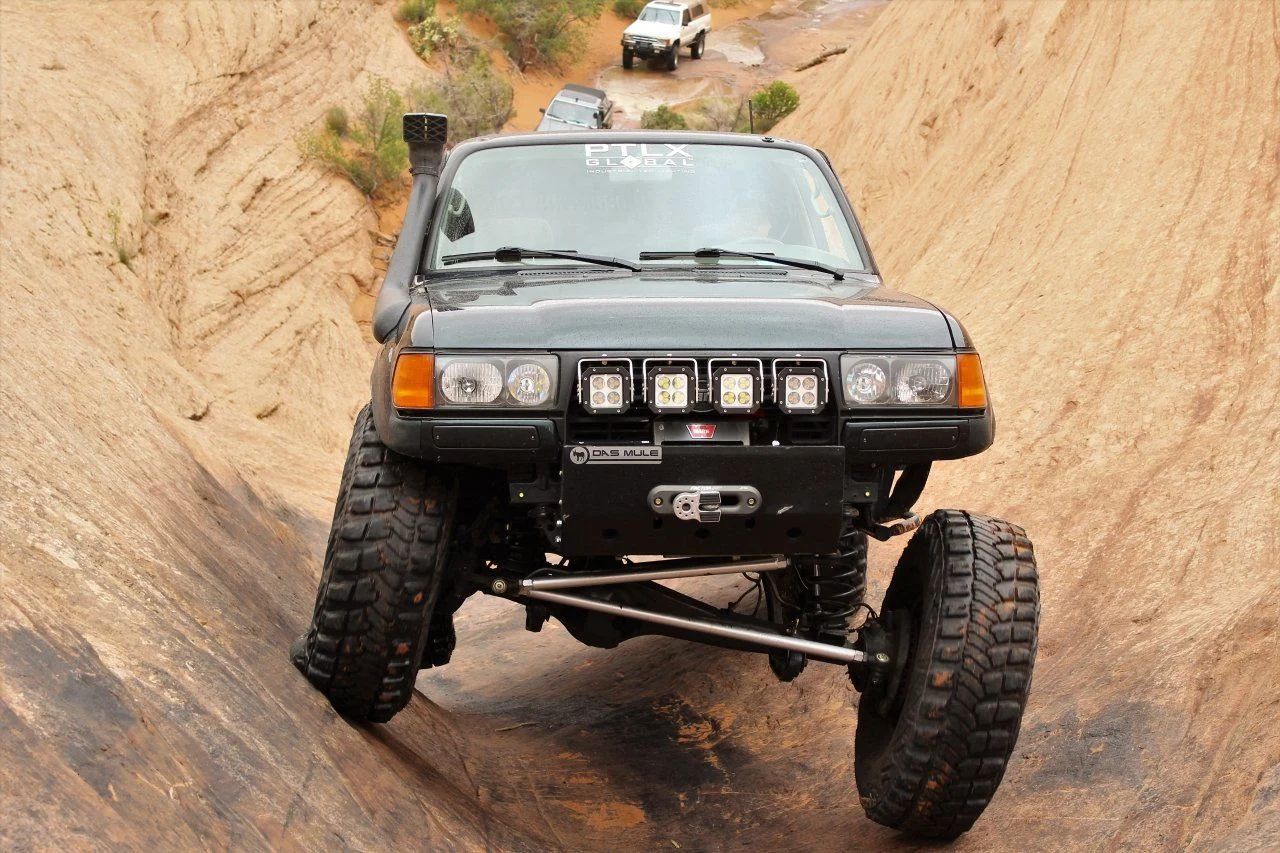

So real quick. Why do you get so much flex out of the front? I'm sure you've covered it in this thread. Have you done anything special?
I believe a combination of things, first and most importantly lowering the frame mounts on the radius arms to get the geometry closer to factory/ flatter to the ground allowing more down travel with less bind, second being the slee high flex radius arm bushings allowing the arms to have extra twist with less binding, and lastly some 14in travel shocks to let it hang! Hope this helps.

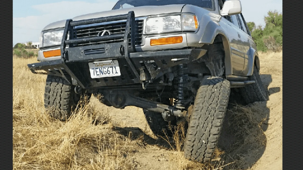

I put on my longer shocks to see if I could drop the top of my tires out of the fenderwell like your rig does, I'm pretty close.
I still just don't know how you do it with 40"s...:hmm:
Had a little bit of shock left but the coil is not pushing down any more because it's loose.
It has to be those 14" shocks you have... or water in those tires.
also @GW Nugget check your tie rod contact with your radius arms, @Apounder has the Chevy TRE's up front so he wont bind. What i found when i was adding some 20mm spacers up front the other weekend is my Tie rod hitting my radius arms prevented extra droop. albeit i am only running OME L-shocks but it still made pulling the coils a pain in the arse. if i hadn't already bought a set of OEM Rod ends to re-do my steering i would have gone with the same kit as Apounder because of this!
I don't want to go in great depth on the tie rod topic due to the fact that it's Apounder thread but I have removed metal in that tie rod contact area. At this time the tie rod has clearance while twisted up. I've also been working on narrowing the control arms in the bushings area to prevent control arm bind on axle brackets...
