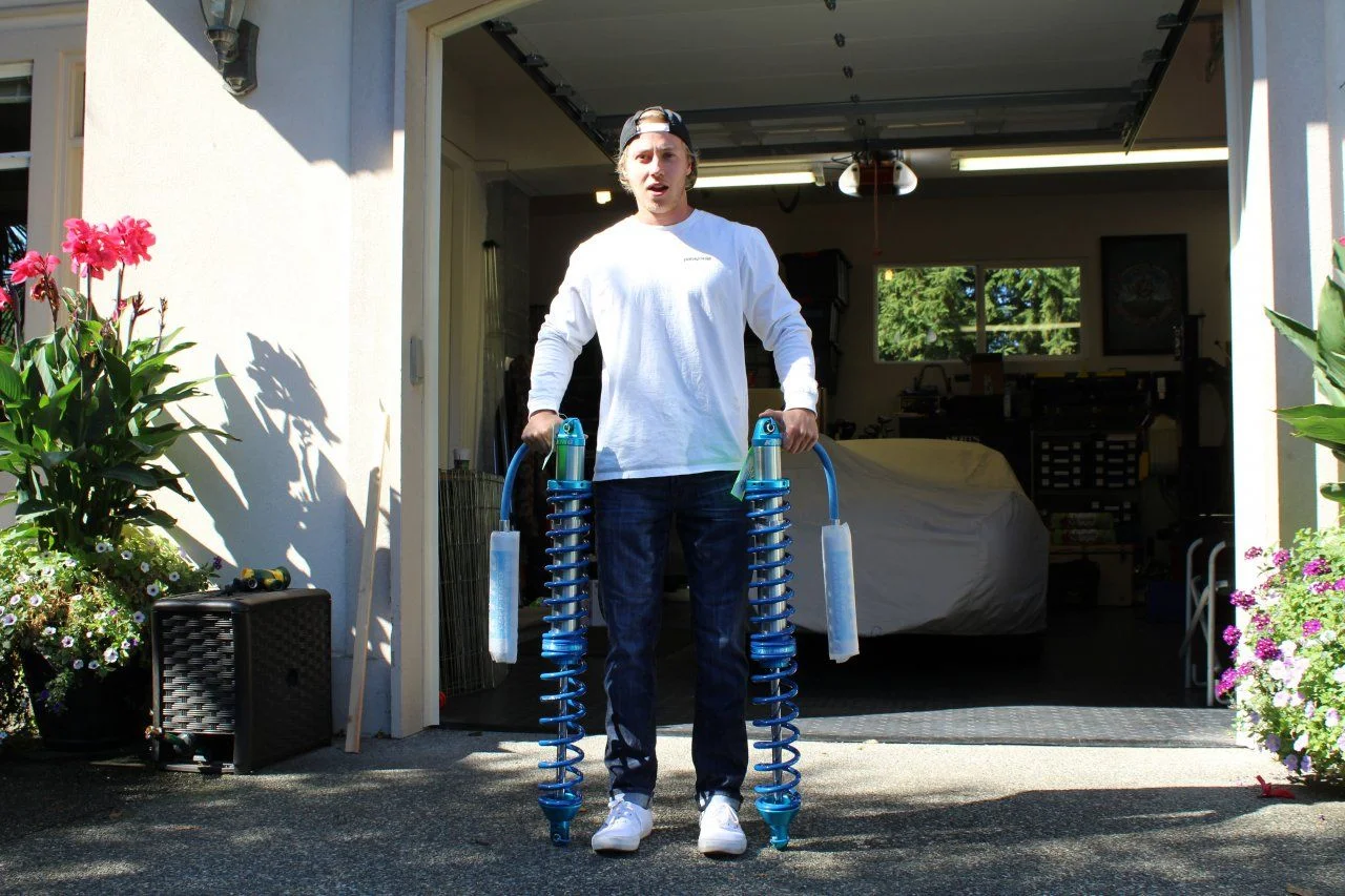

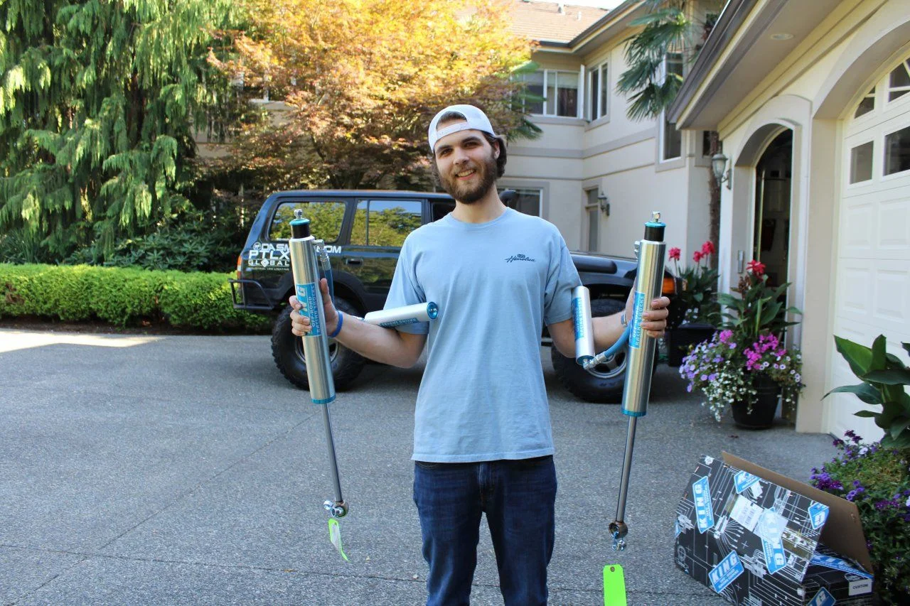

Sorry for the delay! Yes yes yes! New rear shocks are finally here and mounted, custom length king 2.5 resi's with a 12in stroke, now waiting on the 2.5 resi king coilovers for the front with a 14in stroke! Person holding the shocks is a buddy who is 6'3 to give size reference
get a piece of fire hose and cover up those shafts....they will get dinged up. $$$ to get the shafts replaced
NICE, King Eh?
I see the rear coil there is released.
Do you have it mounted on top?
NICE, King Eh?
Do you have it mount on top?
Just stuck on the rubber ring, going to throw some slinky coils in the rear once I remember to call them up and order a set for the rear. What length slinkies would be the same ride height as the J's I have? like the 3in slinky?
just remember to see if the lower and the upper control arms don't bind in the factory mounting brackets!
also, the rear sway bars need attention to as well..the factory bracket up on the frame does not like to be flexed...so beef it up or get some land tank ones.
75mm 7501 is intermediate. Rate is 160/270
After reading several threads, the general consensus is equal in ride height of an OME 863 non J coil but approx 3" taller in free height.

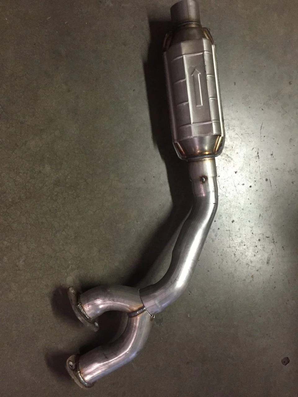

Sooo yeah, haven't done a good job of posting recently here... anywho, made a new Y pipe that runs inside the frame so no more low crap, also the Kings showed up! Tomorrow things shall start getting cut and I will be picking up hiems and tube :o
hiems & tube... does that mean bye bye front control arms?
