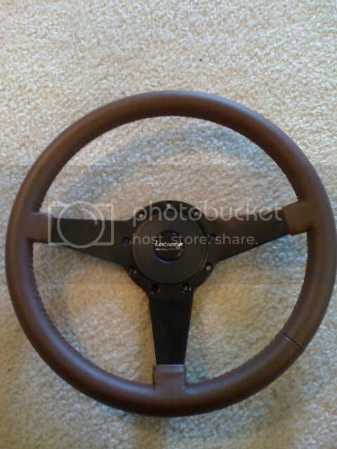

New Lecarra leather wrapped wheel with hub. Need to get rid of that Lecarra sticker on the horn button.

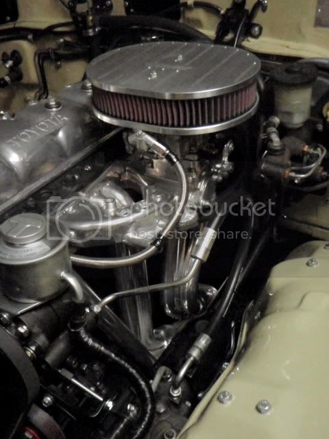

-Stainless Fuel lines, New Fuel Filter (OEM)

I ordered the stainless fuel lines from summit racing. they are spectre brand 5/16". Not too expensive. I shortened them considerably from the stock length- I have no idea why they were that long originally.

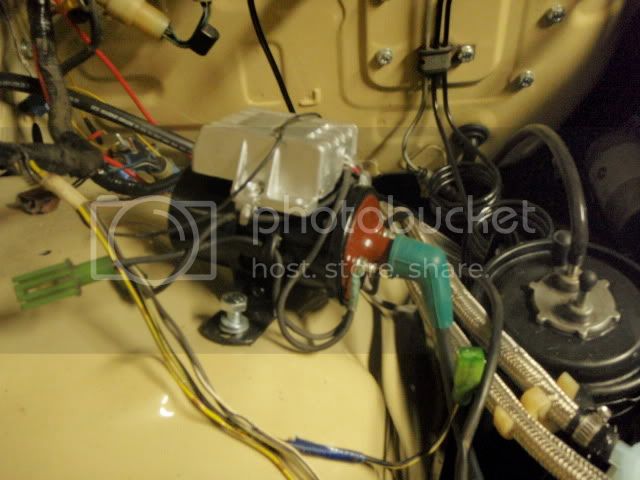

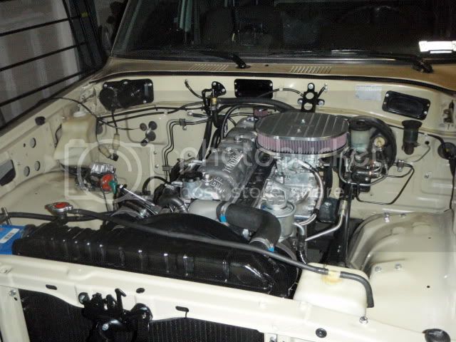

Alright Got the left freshly painted and linexd fender on. Painted the igniter. plasti-coated the coil bracket and got a new coil. working on the wiring harness now.

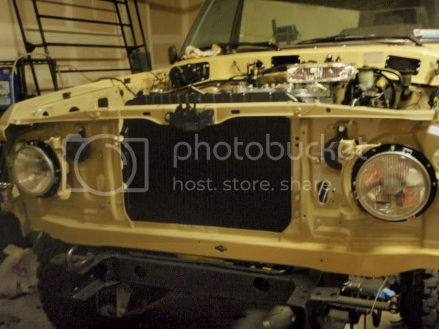

Freshly painted radiator core support all mounted with lights and horns

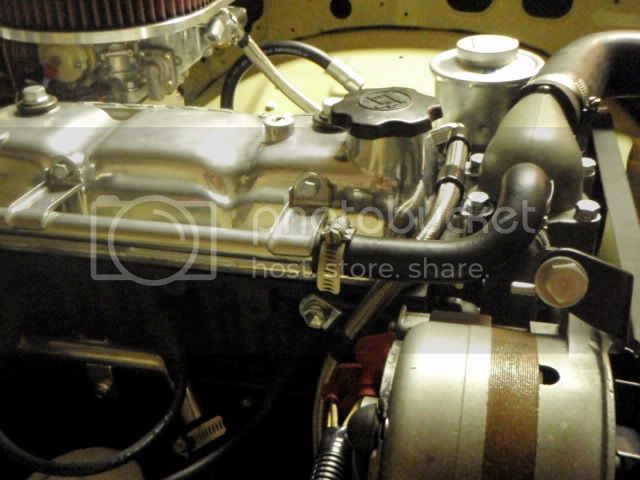

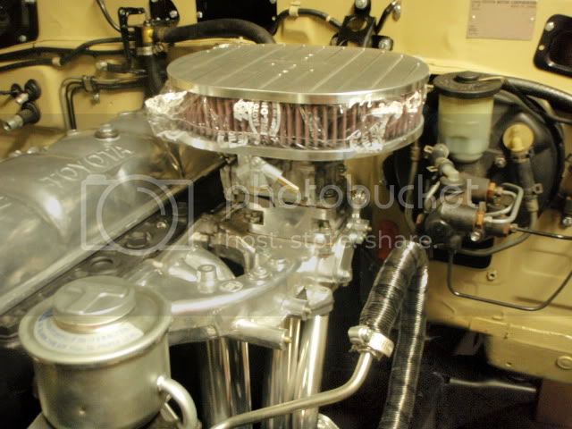

Ceramic coated intake manifold, fluid heat riser and man a fre one piece carb spacer all mounted with my downey headers and remflex gasket. Billet KN air cleaner on top-- That thing was an awesome find.
It looks badass next to all the shiny stuff.
have to take the carb back off as i stripped one of the mounting bolts apparently. Carb mounting bolts are a serious pain in the ass to get too. Steering column will get mounted and hopefully a drivers side fender tommorrow. Only if my wife leaves me alone...

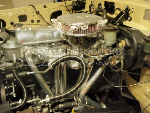

other than that i overcame the impossible and got all the hoses ran as cleanly as humanly possible. Tried to keep the underhood clutter to a minimum.

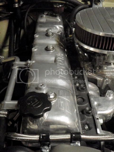

Ill post some more pics after my k&n valve cover filter shows up and is mounted.
Is there a way of running an open filter (like the one you've got on that Weber) on a 2F carb?
Also, what are you doing for the BVSV lines that come off of that thermostat housing? Looks like you plugged up both of them.

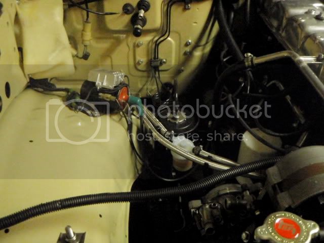

So i got all the wires and hoses ran, I spent almost 10 hours doing all this to get it as clean, invisible as possible. Almost nothing is on the fenders. Here are some pics:
Used electrical wire conduit things for fuel line routing:
Filled all unused bolt holes with flush mount stainless bolts

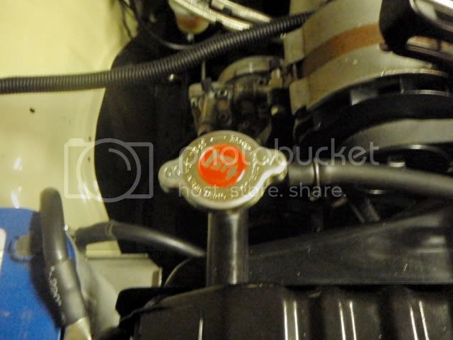

Teq logo on rad cap- just little s***

Just as a side note- if this initial experience with the weber is what i can come to expect for the life of it, i have no idea what everybodys issue is. This thing is extremely simple, very easy to tune correctly and minimal moving parts. Im very, very glad lehiguy and klinetime pointed me in that direction. Desmogging is amazing. I got rid of so much crap. So much. I now know where everything is and what it does under my hood, and can figure out when something is wrong, what it is-- that to me is priceless. Same thing with the weber, the stock carb was a mystery to me, as Im sure it is to many (hence the reason only 2 people on here can rebuild them). Im positive i could rebuild this carb (weber) and troubleshoot any issues that might arise. Again, that, to me, is priceless.
There isnt a piece of smog equipment left on my truck. No need for the bvsv lines.:)
And where in the world did you get that awesome filter?
LC engineering. They sell performance toyota parts, but this is pretty much the only thing that is applicable to the cruiser. Im very lucky i stumbled on it, it is extremely nice. Beat the cheap k+n chrome circle, the black stock millenium falcon with a million vacuum ports i dont need, and the undersized weber filter.
