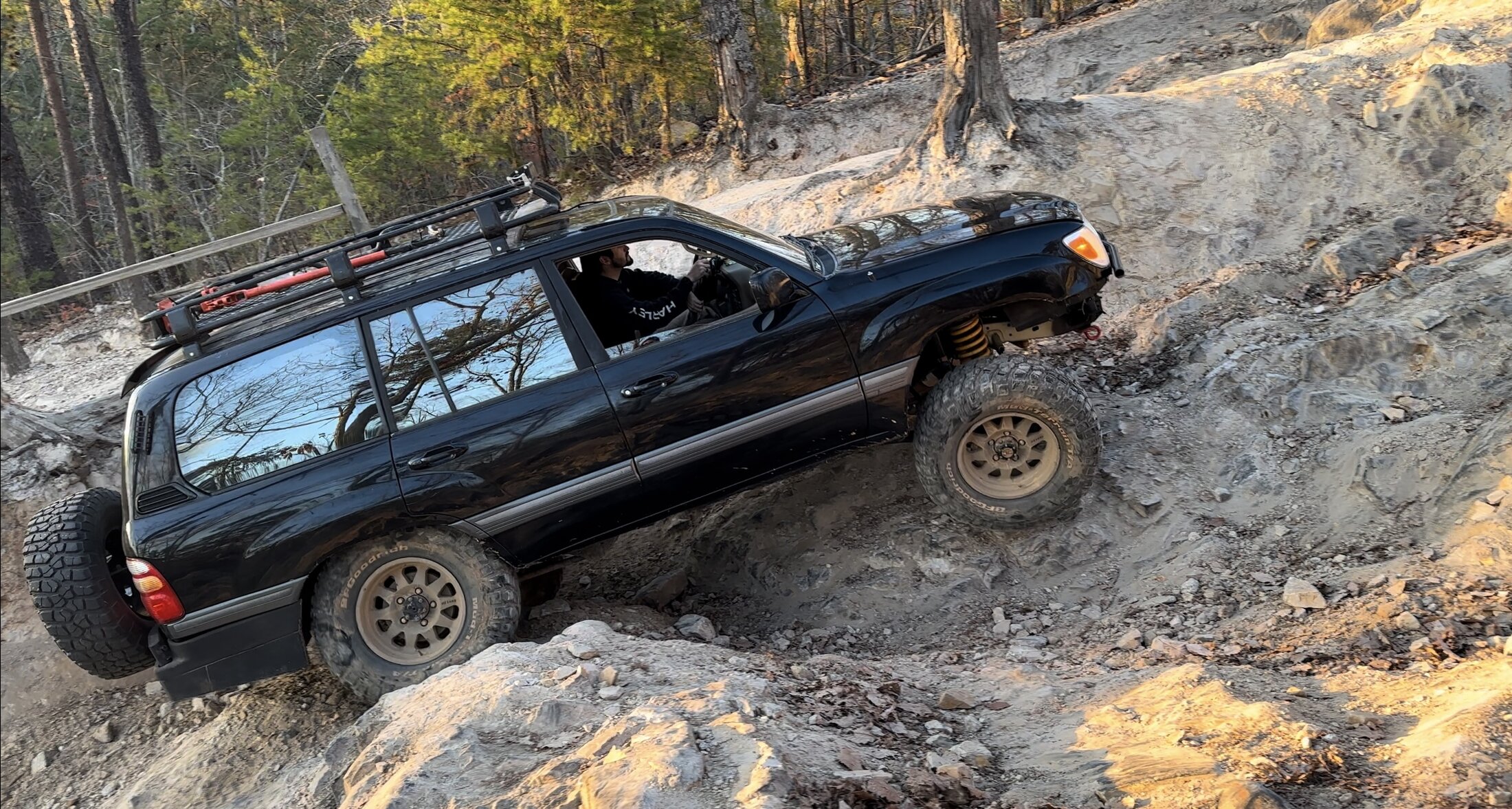

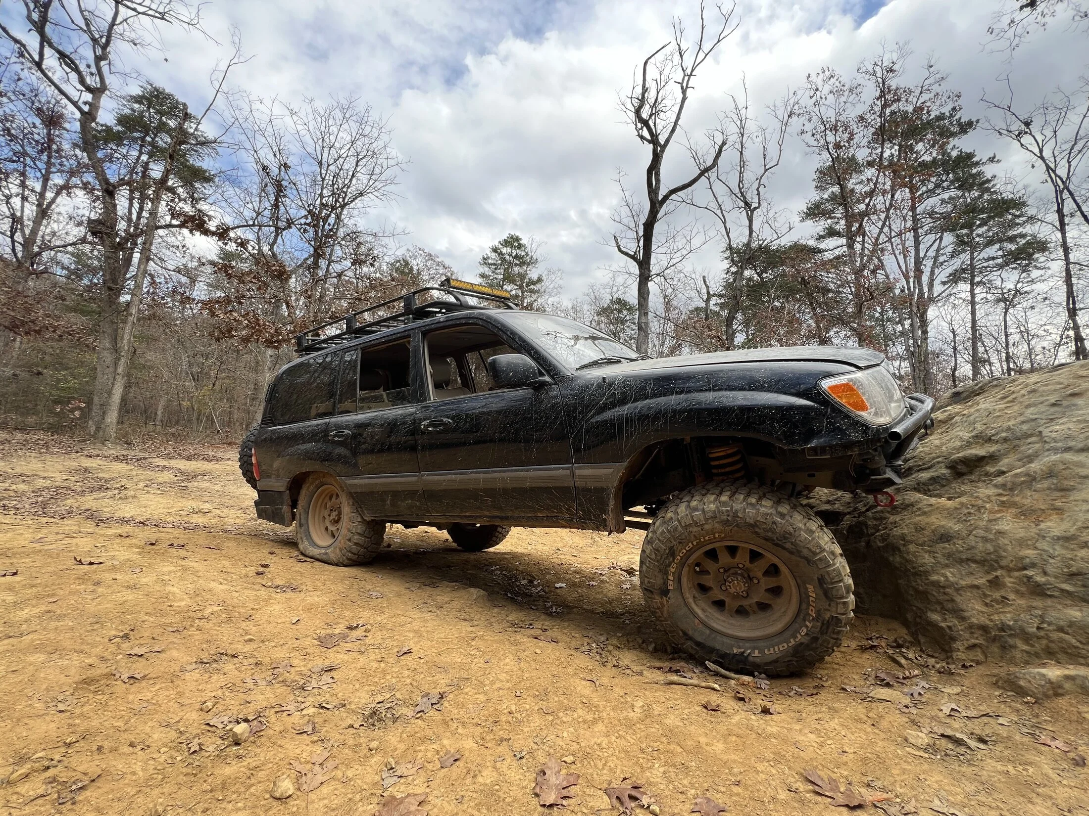

With no working gauges (besides volt meter) I sent it on the Relic Run. Did all the trails at Uwharrie.
No working gauges, no center or rear locker, 25psi in the tires, welds still hot on the truck as I rolled away. Maiden voyage (further than 25 minutes).
Installed the front driveshaft after I arrived lol.

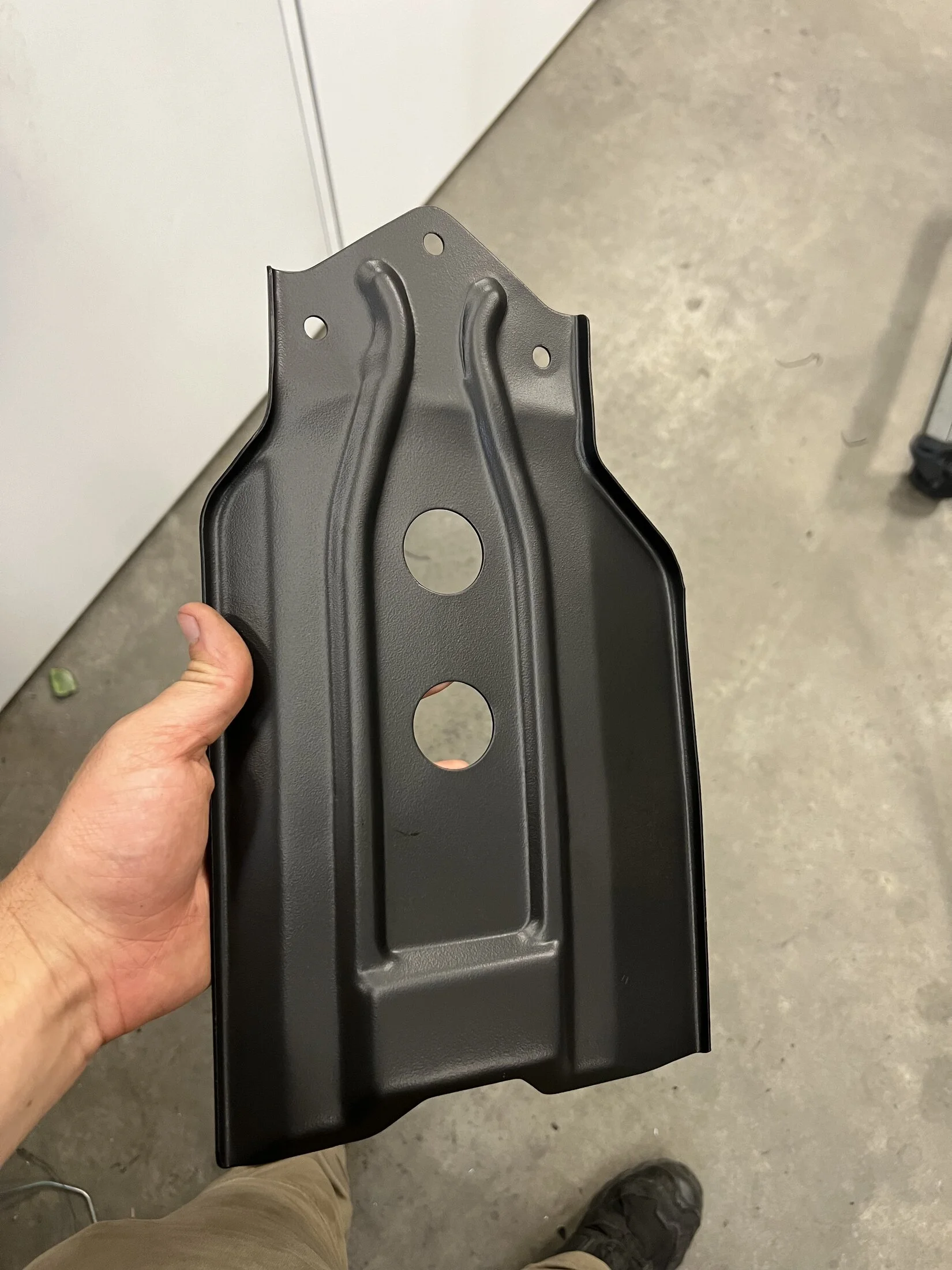

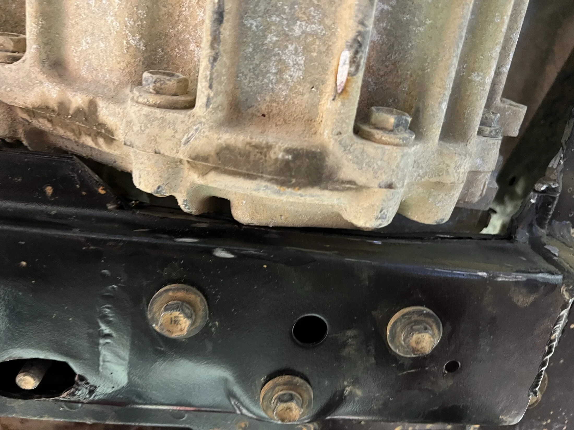

I had to modify the transmission crossmember further after everything settled to prevent the transfer case from rubbing. While I notched it, I powdercoated the cross member and the t-case skid plate. (New home made skid plates coming soon).

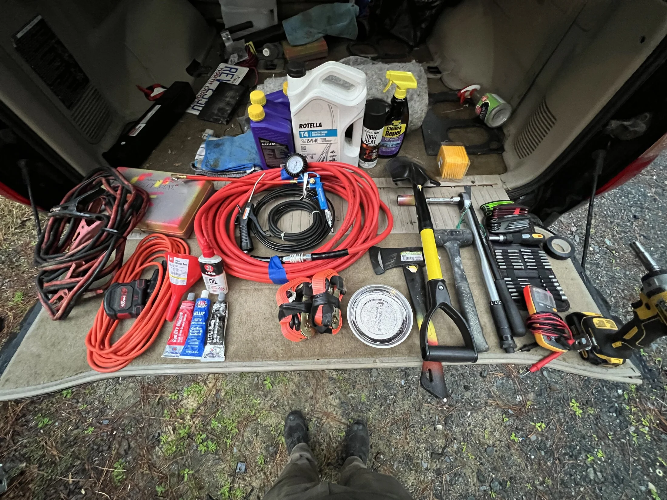

Started piecing together the tool/fluid/parts boxes that stay with the truck.

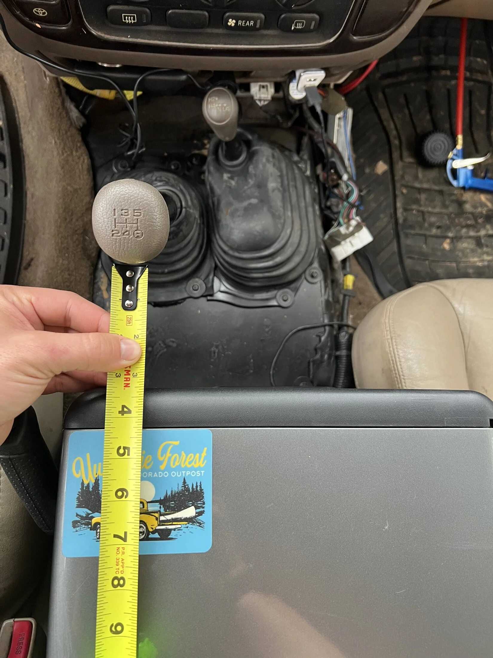

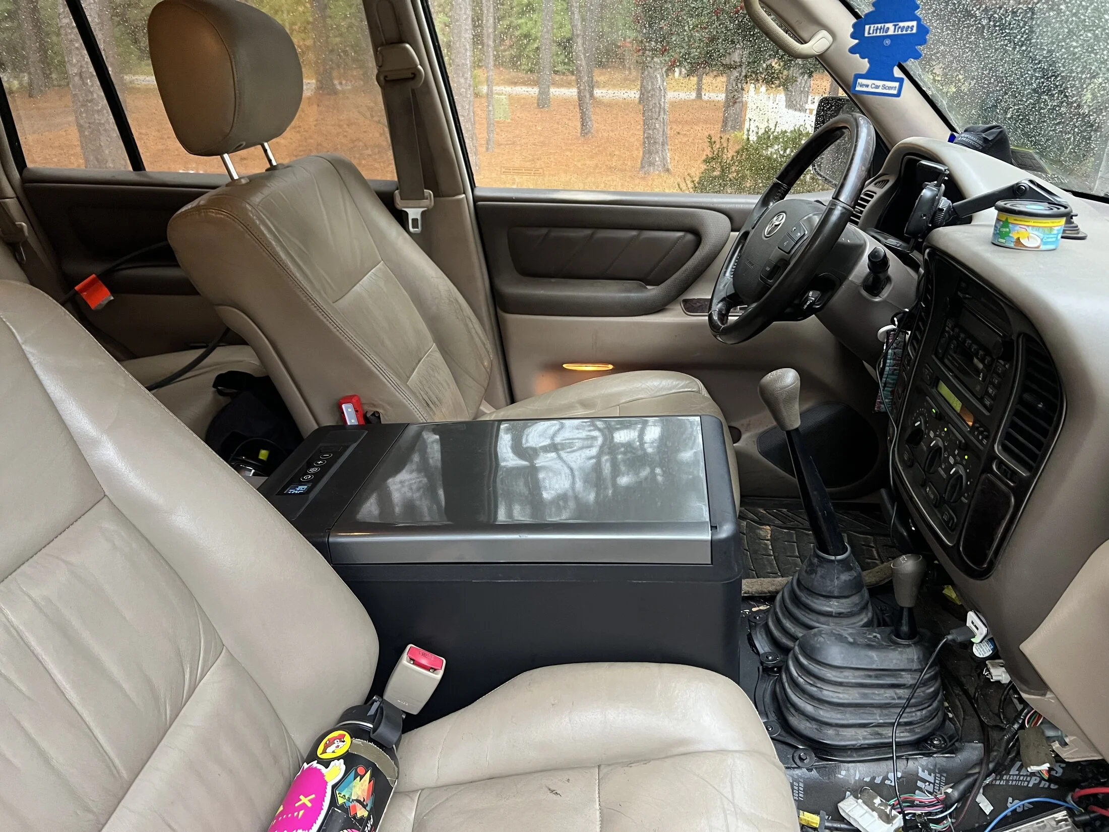

Didn’t want a standard center console and I also didn’t want to plumb in the AC lines for a factory center console fridge. So I built a base platform, and mounted a 12V 23L fridge. (Eventually I’ll get a bigger fridge for the back). It’s the perfect width and height, all you have to do is remove the arm rests.

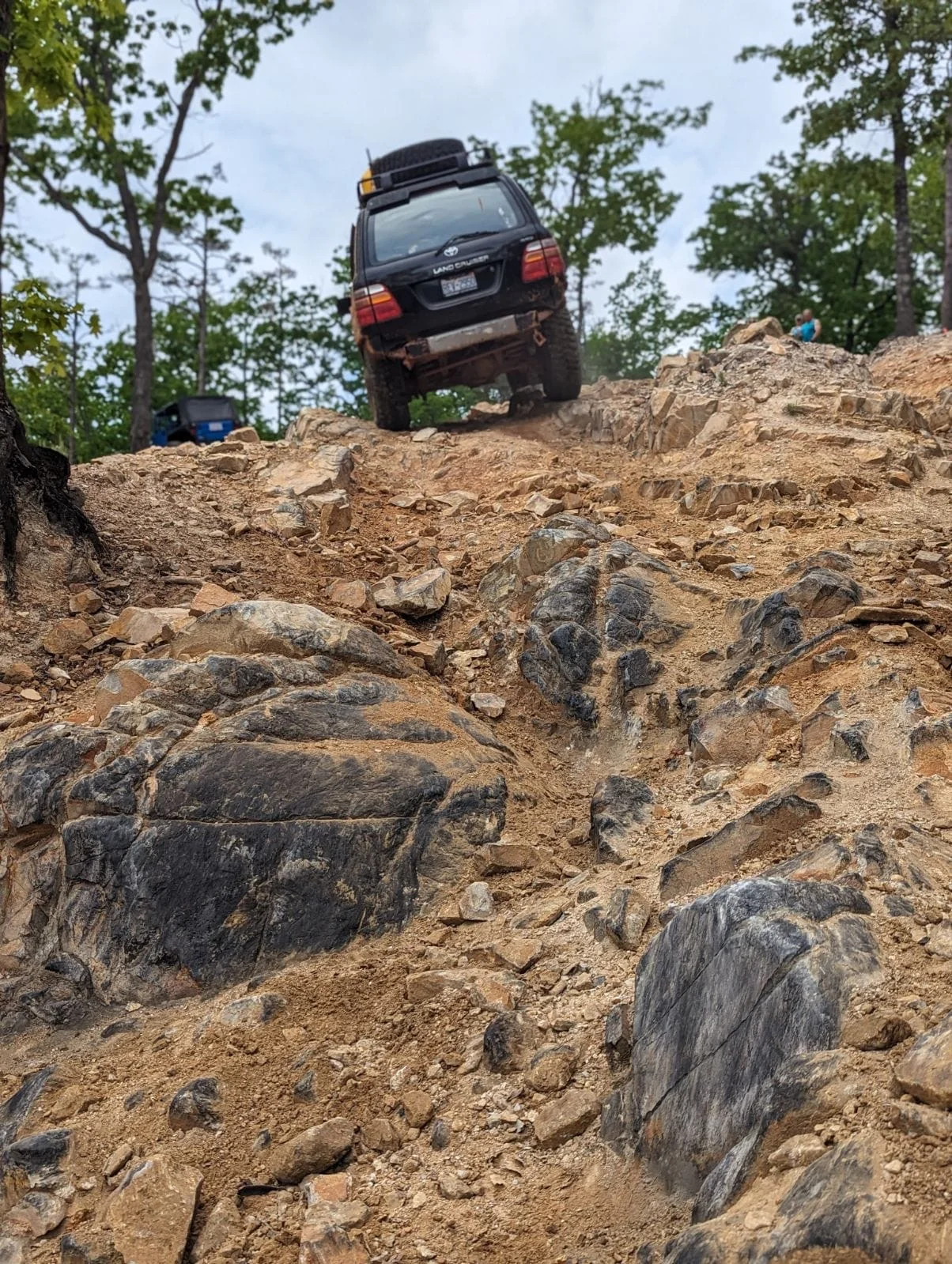

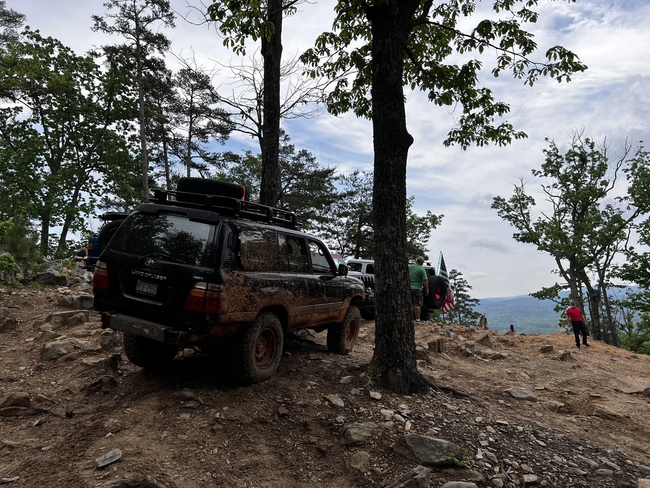

Also, a random trail picture from Uwharrie.
And measuring out the space between the shifter and the fridge for potential cup holder locations.

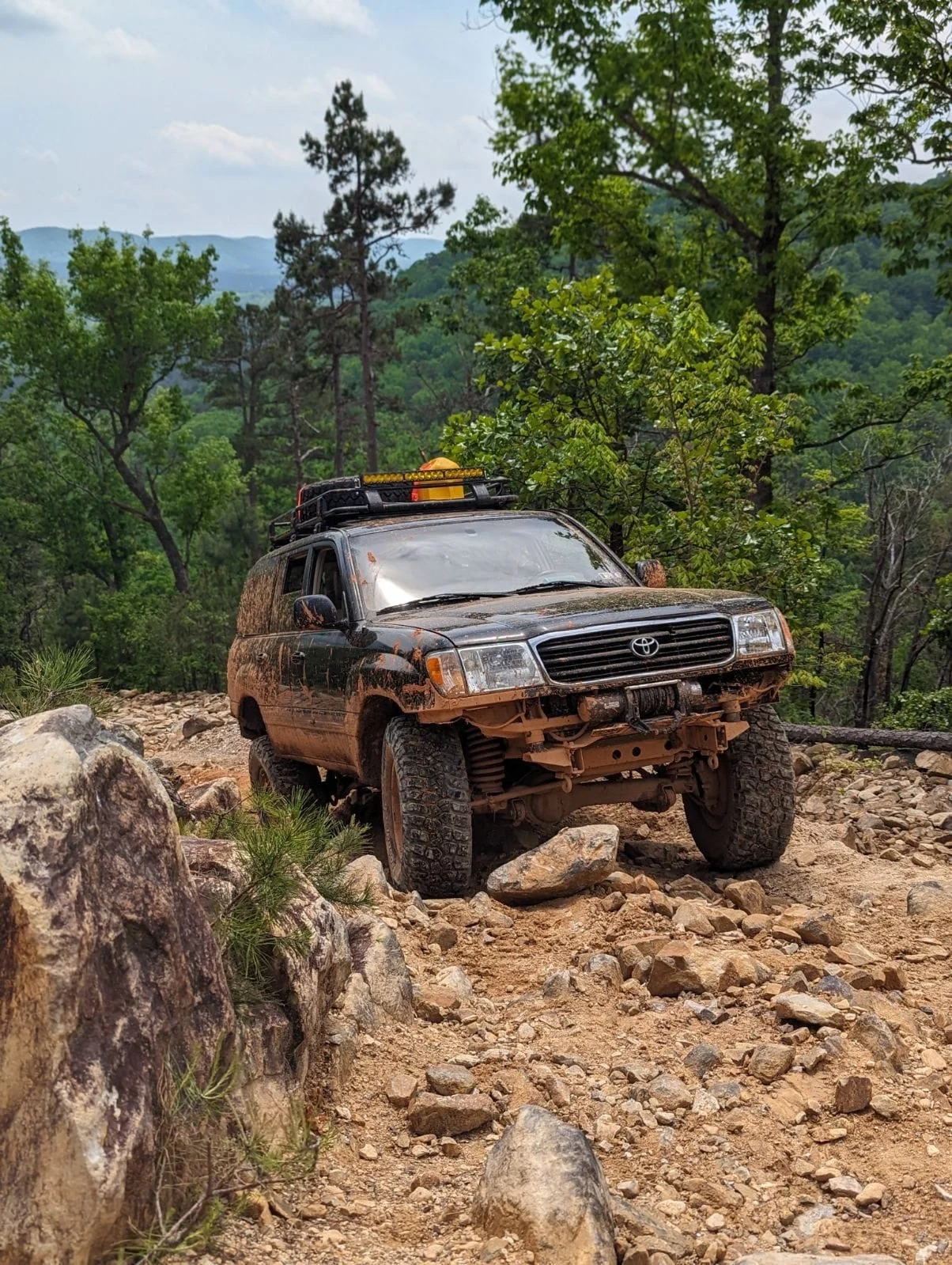

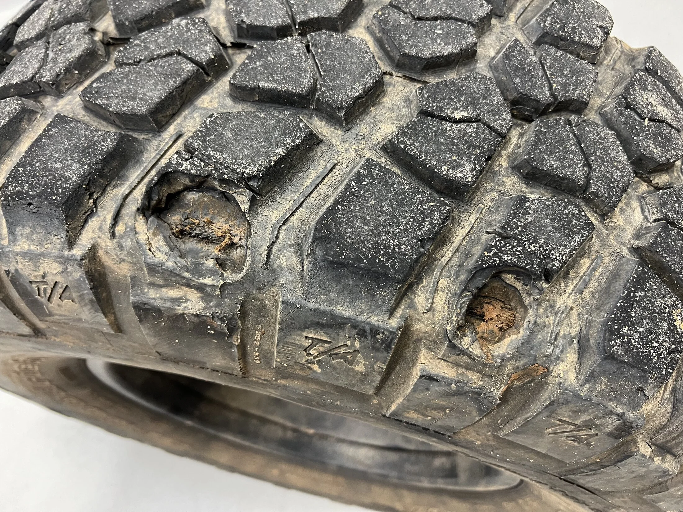

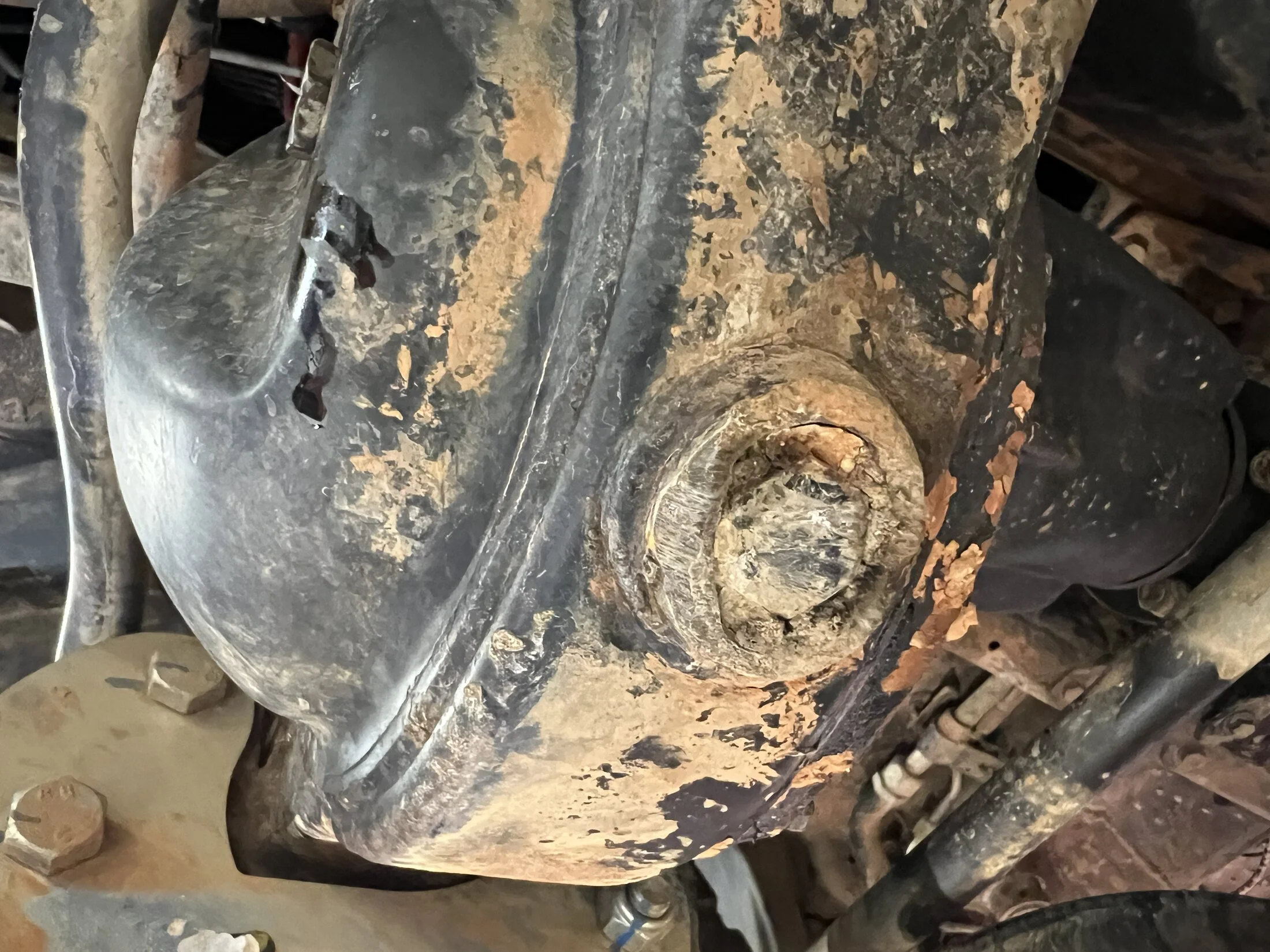

End of the season trail damage overview. Really not bad.
I’ve learned a lot this year about trails, my truck, choosing the right lines, what direction the truck will go in the future, what tools/parts/fluids I need and don’t need to carry, and so much more.
Constantly scrolling the forums and seeing what everyone else has done gives me tons of inspiration.
Everything beyond this will be fine tuning.

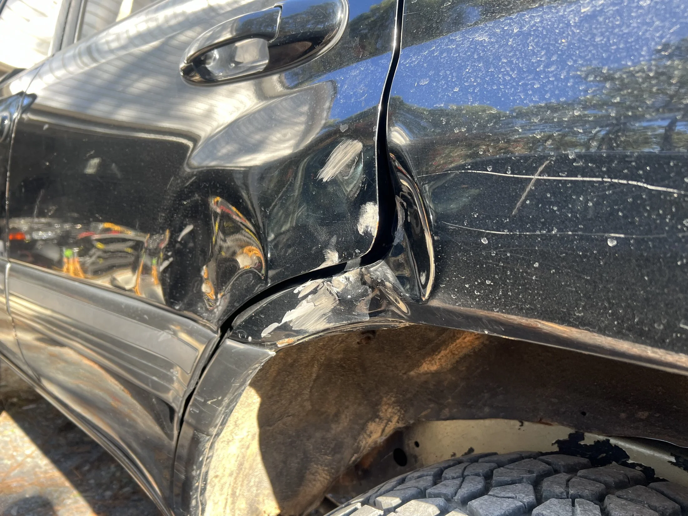

Some trail damage. Going down the front side of Daniel and the dreaded tree got me. Toyota made their glass stronger than the quarters I guess. Glass has deep scratches from tree contact. Also another tree, same day, snagged my mirror and ripped it out of the metal in the door. Didn’t break the mirror.
