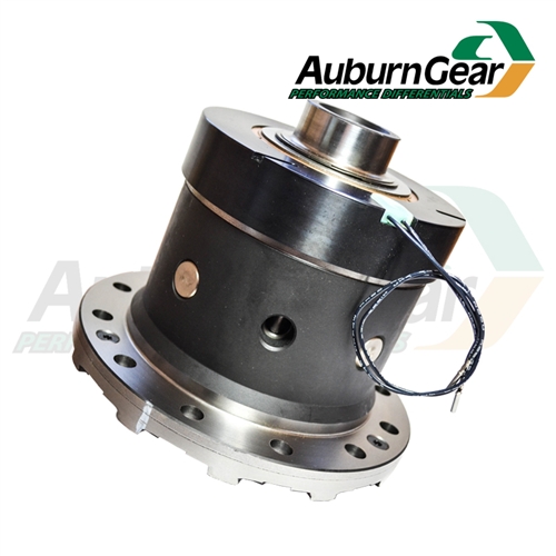

I also purchased some things that I didn’t necessarily need. In the long term I’d like an electric auburn diff up front. I want to be sure I like the 4.11 gear set, as the D60 uses a different carrier for 4.11 and faster gears, and one for 4.56 and slower gear sets but found one of these hard to find Contura lockkng switches. In a full time 4WD rig you don’t want someone accidentally bumping the switch on the highway at speed

You can very easily find "thick" gears to put higher-ratio gears with the 4.10- carrier. (I just put some 5.38 gears on a factory 3.73 carrier this week....)
My understanding is that they make two different carriers:
these guys list separate carriers for ARB, yukon, ox etc.
Just reading some bad reviews on the auburn now, might read some more and go with something else.
