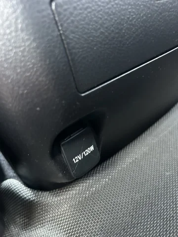

Anybody know the part number for this. Wife cracked the cover and only a matter of time before it snaps off.
Is this on the rear of the center console?
And I assume make/model in your username?
Sorry - yes rear of center console. 2014 LX.
Unfortunately it seems to only come with the whole rear cover. 58923-60160-C0 for black if you have the rear seat entertainment/rear seat heaters, 58923-60150-C0 if you don't have those features.
For the record, the parts diagram doesn't even show the power plug and cover being in there at all, but image searches of the first part number show it being on the rear console cover. In my experience it not being on the diagrams (nor a hole for it) mean's it's all part of the assembly.
To be really sure you might want to work with a parts department.. that way if they get the wrong stuff you aren't forced to eat the cost.
I think this might be it. Looks like it probably fits the unit in the front center console and rear center console. I might order two since both of mine are broken. The hard part will be removing them without breaking the surrounding parts.
