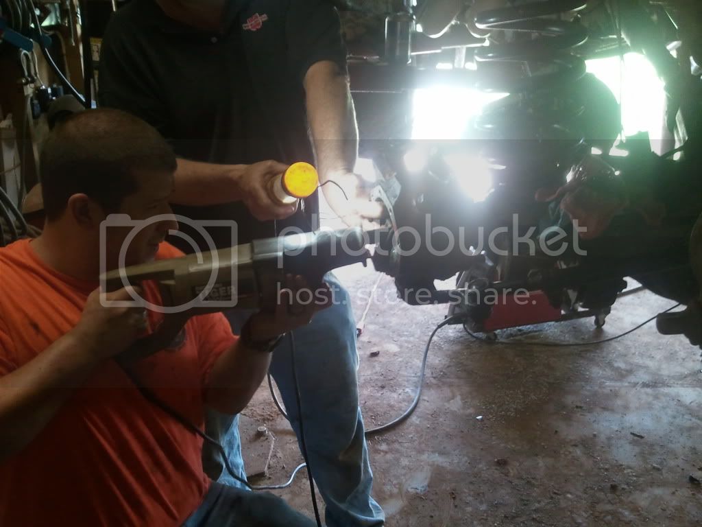

First time I have ever seen someone use a sawsall inside the axle :flipoff2:
I didn't have much going on Tuesday so I lowered your rear bump stops two inches. So that's one less thing that needs to be done before you can go test it out.
I was wondering when that photo would get posted...i thought Ted took it
Thanks for putting those bump stops in, I ordered the shocks today and I am still on a mission to find good extended brake lines...
First time I've ever seen anyone with their fingers that damn close to an active sawzall blade!!!!! :eek::banana::whoops:
I bet something very close to this was said moments before this pic was taken: "Nick, I trust you buddy".
I would be more worried about the lack of safety goggles
First time I've ever seen anyone with their fingers that **** close to an active sawzall blade!!!!! :eek::banana::whoops:
That sounds like some famous last words like, "Here, hold my beer" or "Hey ya'll, watch this!"
