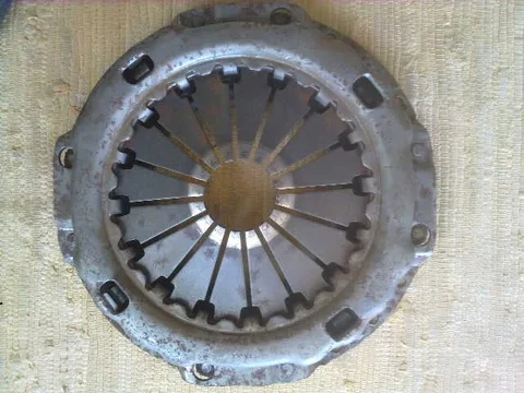

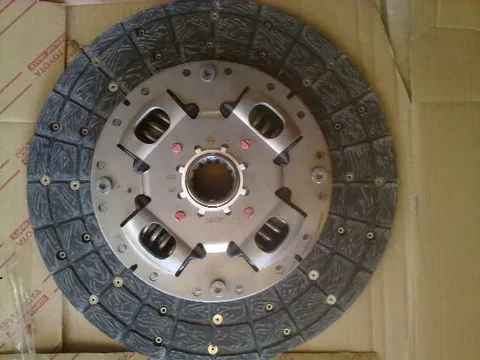

For the sake of comparison and more pics :D here is the TRD pressure plate and factory clutch plate 040920131157.webp
Its a custom clutch I have made and sell to the high boosting turbo guys. Keeping in mind its a daily driver so clutch feel and pedal pressure is addressed.
