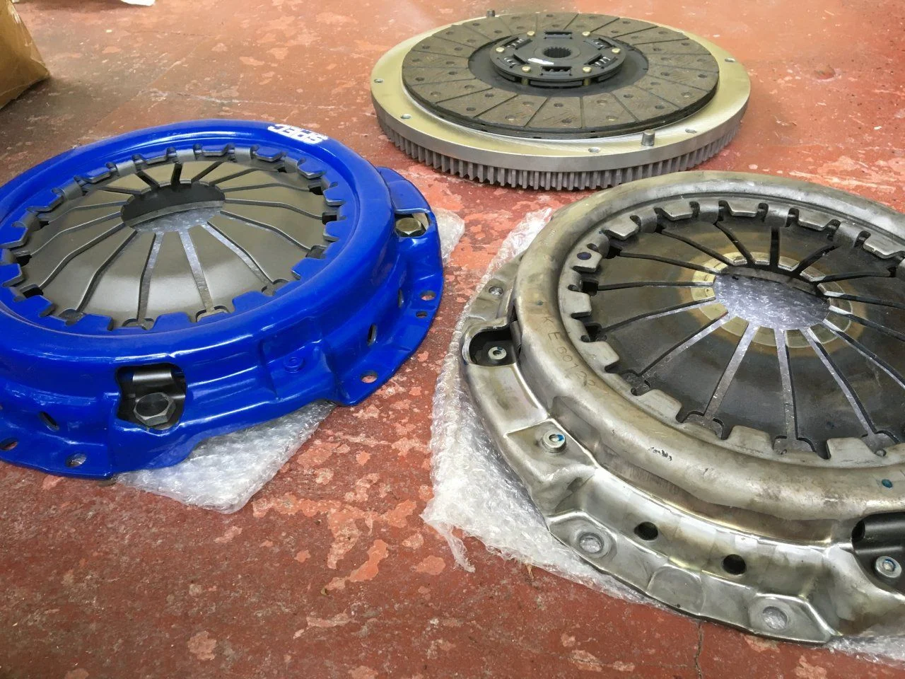

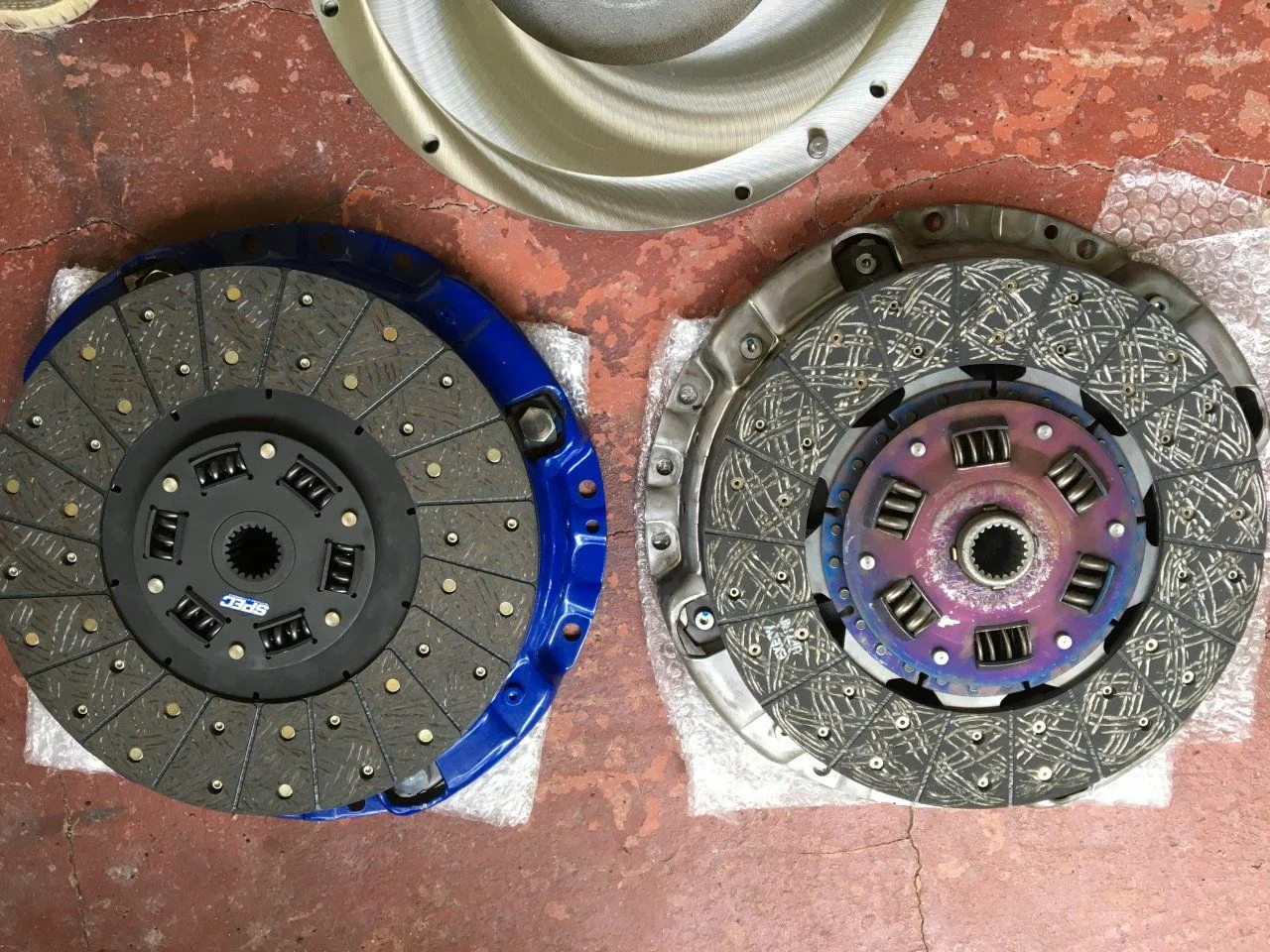

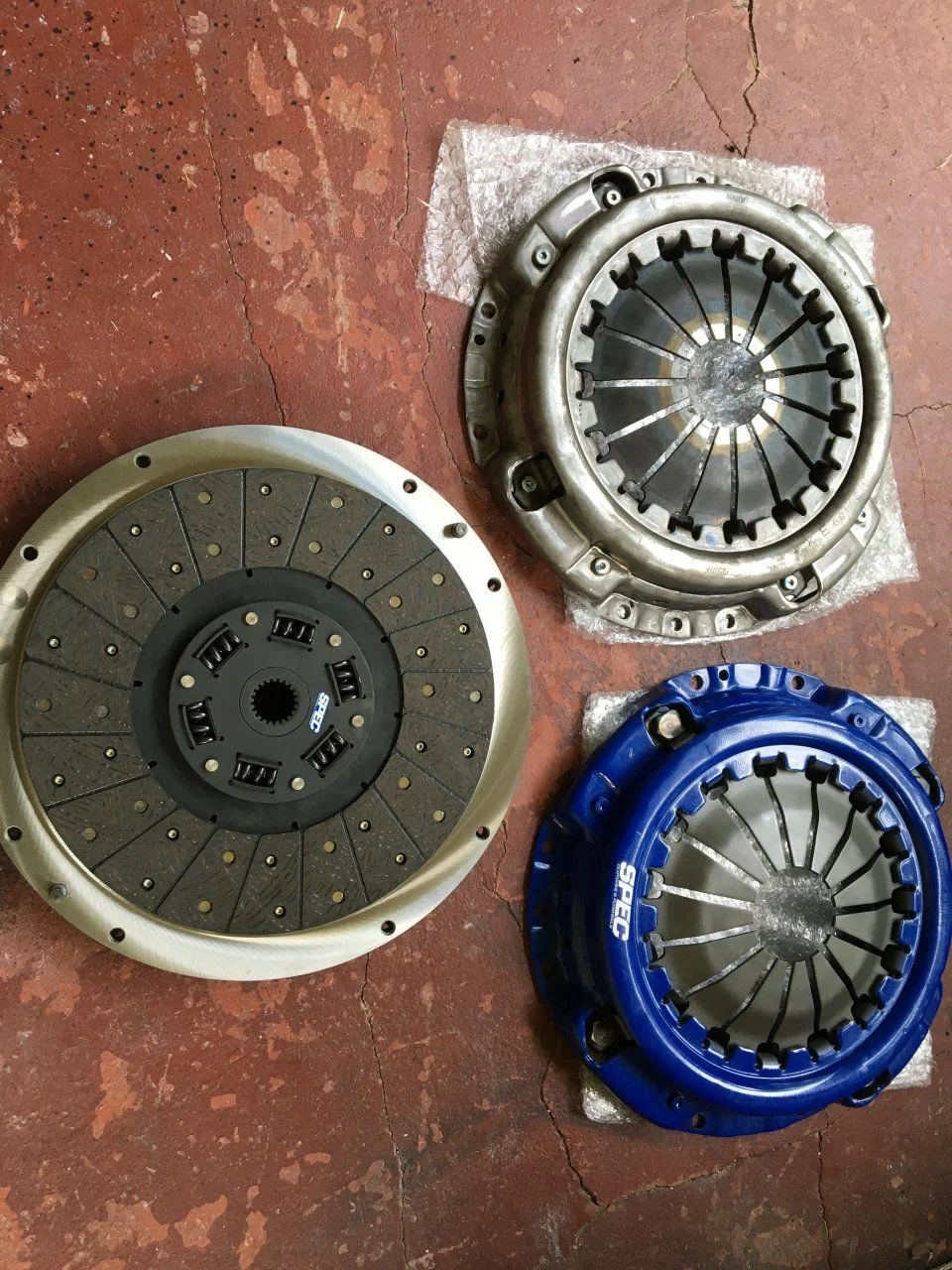

The listing is for 1fz which is interchangeable with the hd-t. I had them make a 21 spline version at no extra cost. I just received the parts today. The cover has an aisin mark. It's obvious that they assembled it and the diaphragm is different.
One odd thing though. The friction material is wider than the friction surface on the fw and plate. The outside diameter is correct but the disc material is 2.5" wide vs 2.125 for the stock parts. Doesn't seem right though I'm not sure it will cause a problem. I may wait until Monday to call them before installing it.
Price is better than other options. Hopefully it works well.
View attachment 1277321 View attachment 1277322 View attachment 1277323
