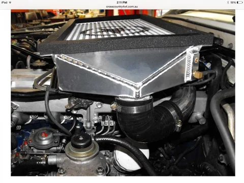

http://www.crosscountry4x4.com.au/4...ndcruiser-80-ultimate-intercooler-detail.html
porn !!!!
altho looks like you will have hard time replacing the oil filter with the IC on ..
IMHO, putting an intercooler on top of an engine makes about as much sense as putting a radiator, oil cooler or A/C condensor on top of an engine. Imagine how well those items would work in that location? As nice as those kits are, I still feel front mount is the only way to go (whether it be Air/Air, or a Air/Water radiator).
I dunno tap. For that kind of price Id expect the plumbing to the intake manifold to work better than that. It almost looks like an after thought. And a top mount without a big fan make no sence. And Im a big fan of top mounts. No pun intended, this is serious stuff here.
Agree .. still bad ass size wise .. for that one you will need 2 fan setup at least ..
agree again .. I have good fans on top of both of my IC
agree .. I just had no other option any of my Cruisers .. was that or my AC and here you can't ( well I can't ) live without AC .. so option was clear, I would like to thing 60% efficient IC it's better than no IC at all ..
