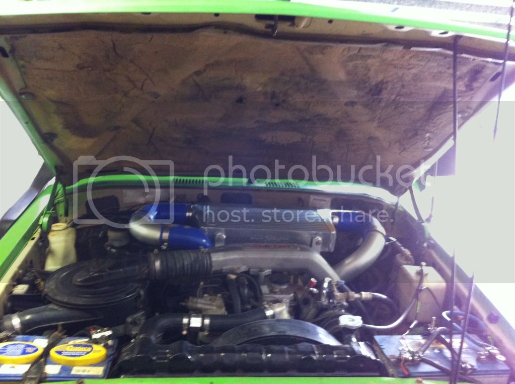

The end result ..... No Intercooler in the engine bay.
IS that door trim you used to seal it up? Bit of a gap, but I found mine quite finiky to seal. Looks like you do have some room for a fan if you decided to go that way. My testing showed very little flow over the core below 40Km/h and my scoop had half the surface area of my core.
another advantage for the RHD .. no brake master to interfere .. ( again .. same as you seen in VD engines ) damn !
that door trim was placed around the cut edge until i put the scoop on, it wasnt for sealing the intercooler to the hood. i have heaps of room under it for a fan or two I have just been busy with a new born + work etc. i did however re route and re wire my headlight sprayers to spray water over the core. hillbilly tech yo
That's a nice job fitting a pretty generous core in there. Be interesting to get some pre and post intake temps to see what efficiencies you get when you chuck a fan on, or even just with the hood scoop. Sealing it to the hood will help a lot with getting good flow over it.
