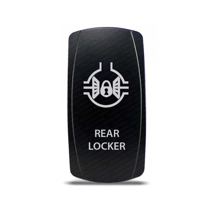

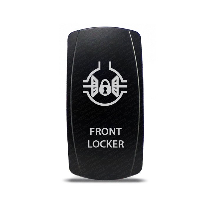

The new switch is completely different. The plates won’t interchange. It has a lock on it you have to push then you can engage. I’ll get a photo for you. I like it better except that it’s larger and did not clip in like the old Harrop/Arb style
I don't want a dial, just an *adult* switch. I also prefer being able to engage front locker without the rear locker. Dial doesn't allow that.
I have to agree. When I was wiring up my Harrops, I thought about how many were pushing the OEM rotory switch and how OEM it would look. That may have value for some, and even has built in safety for the newbies. I guess we're just rebels....☠️
This is the switch that came with my Eaton locker...
^^^Just a little bit to fit the connector to the back of the switch. Ended up being just a little filing at the bottom of the dash. Hoping my front locker switch will fit fine in the slot next to this one.
My old switch clicked right in on the left side hole and was not really close on the right side with the Eaton switch. I had to get rid of all the lip all sides.
No biggie but FYI
Huge fan of matching switches. These are a solid option!
If anyone decides to go this route, I got my switches today and the insert card says 15% off your next order with the code: CH15
Just passing along some savings I didn't get 😶
