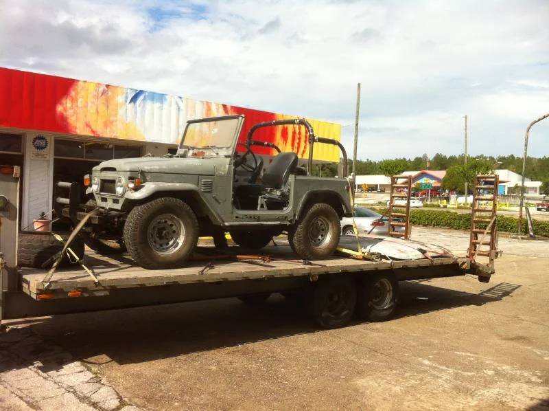

I picked up a "1973" today for a decent price. It's rough but I've seen a lot worse. It has a sbc, center force clutch, shatterproof bell housing, 4 sp and is basically complete. This brings me to my next issue. The title says its a 73 however that Vin does not match the door jamb plate that says its a 2/75. The firewall is dune beige however everything else has been primer grayed. It gets better though. The top and doors which haven't been on it in 25+ years are Pollux orange and supposedly were the originals. I got my handle "arcticmutt" building my last rig that had a variety of manufacturers into it and it looks like ill be continuing the legacy. Lol. I'm pretty sure someone stripped a Pollux orange 1973 for the top, doors and title but all of the rest is a 75. I also forgot to mention the previous owner installed a dodge van radiator, 70's Chevy truck taillights and the fact of the 73/75 cruisers makes it right up my alley. The problems that will need to be addressed first is rear wheel cylinders are leaking, no taillights that work, it doesn't look like a tune ups been done in 15+ years ( runs surprisingly well ), lose the 2 barrel q-jet and drive the snot out of it as I rebuild it over the next few years. I'll try and post pics this weekend.
The sides of the top are pretty much unusable. The top has not been on the 40 in 25+ years and was left sitting behind a barn on the ground. Also the 40 itself was kept outside uncovered so needless to say its going to be a long process. On a good note the bezel was the right direction when I picked it up. The suspension is pretty much original minus the angle iron shackles in the rear.
Scanning through my boxes of parts last night I'm pretty sure Iconfirmed my suspicions. I found rocker panels that match all of the rest of the orange along with an extra cluster assy. Everytime I look at it I keep seeing less and less of the bad things about it and start seeing the potential it has. This is my first 40 and hopefully I will do right by it.
This is the only one I have right now...all loaded up heading home yesterday.

Low windshield wipers and square turn signals say 1975
Sent from my iPhone using IH8MUD at 85mph in an FJ40
Lol. That trailers hauled 3 vehicles out of your yard. We've been here a year now and I hate it. The wife likes the beaches though. We needed to leave to be near some better hospitals for my wife(complications with pregnancy) and I had a buddy in the area. I'd like to make it back up to ak but its not in the cards right now.
According to the block number it is from 1967. What does the frame vin number match? Check the right side frame behind the front bumper.
