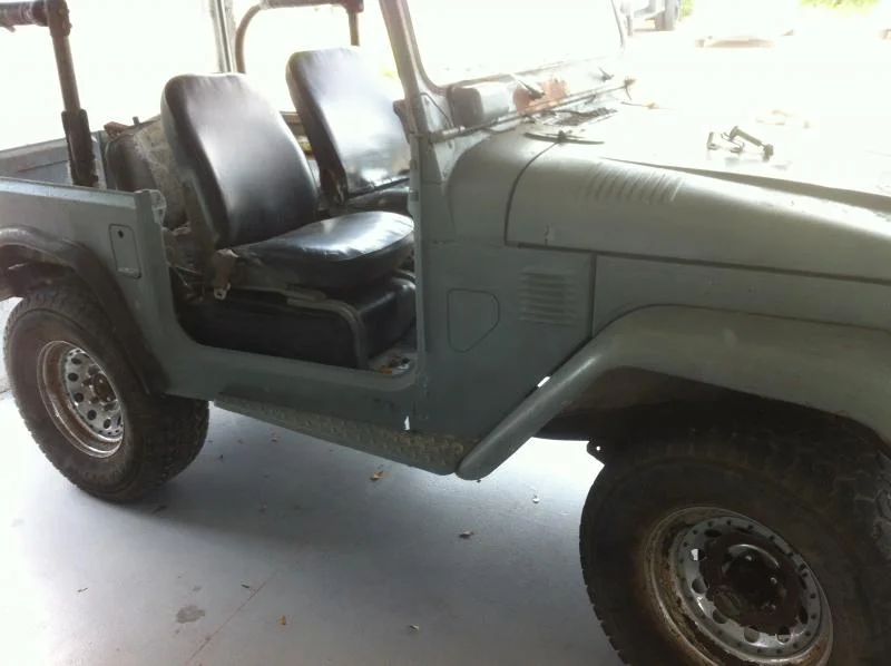

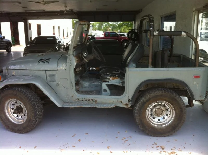

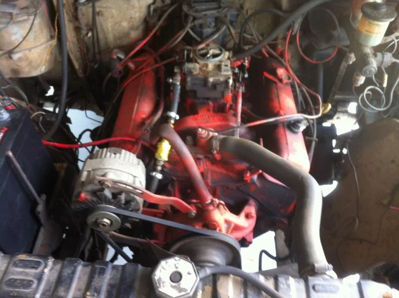

Here is the few I was able to get...the wife wont let me use her good camera in the garage so right now I'm limited to iphone pics.

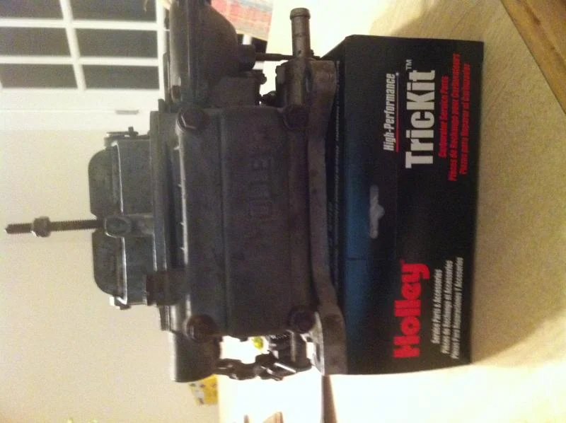

So the quadrajet needs to be rebuilt or replaced sooner rather than later since I cant get it to start now without pouring fuel into the carb. I have a holley single pump 650 sitting in the garage from the sbc that I had in my last project. I'm going for tourque not hp. This carb also needs to be rebuilt but I feel it should give me everything I want for now and I already have it. So, my question is what does the masses think? Rebuild the 2bl qjet or rebuild the holley 650 4bl? When it comes to carbs I try to stay as far away as I can so any help is greatly appreciated
So with the info from my other post and the PO it looks like I have a 67 350 out of a manual camaro with 283 heads. Also I mentioned it not starting once I got it home and the PO said " just smack the carb with a hammer, the float sticks sometimes" smh. This makes me even more convinced of my decision to go to the holley. Who knows how many times they've hammered on the carb.
A little bit of an update. I rebuilt the holley last week (sorry no pics) and have to say it was way easier than I expected. I haven't installed it yet so that will really be the test on how "easy" it was...lol. I will hopefully get a chance this week to install the intake and carb.

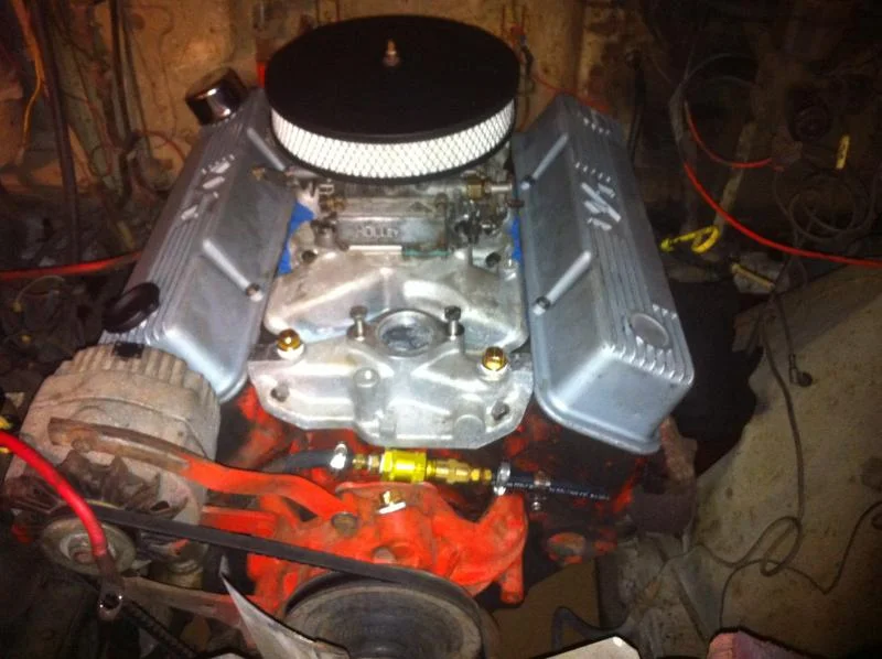

Small update: I seem to never be able to work on it while I've been keeping it at work so I cleaned out the garage enough to squeeze it in and took it home on Friday...the plan is to hopefully have the carb and intake swapped on by next weekend.
On a side I had been searching for a good set of old school Mickey Thompson valve covers (best look on an sbc IMO) for over a month and was not having any real luck, they were either priced way to high or completely trashed with extra holes...A set popped up on craigslist and I was able to get them for a song and a dance and the cool factor was that they came off of the guys 1968 Camaro and he put them on it new in 1972. With the fact that my engine is out of a 68 Camaro I believe these might have just been destined to be together :clap:

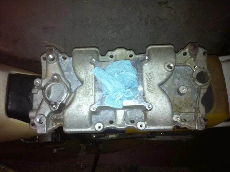

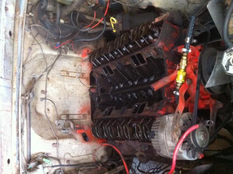

Not a lot to update...finally got around to working on it for a little bit on Saturday morning and was able to pull the valve covers and intake off...found some excessive carbon build up so I am waiting on a scope from a coworker and going to check everything before reassembly...Also just in case anyone pulls this up as reference later on down the road I am going to run acdelco r45 plugs which are the short thread ones...
