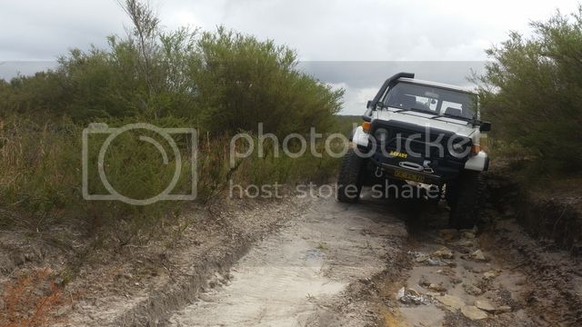

That was possibly one of the times I didn't smash that puddle. Working on my own little mud bog rite out the front of the shop. Lol.

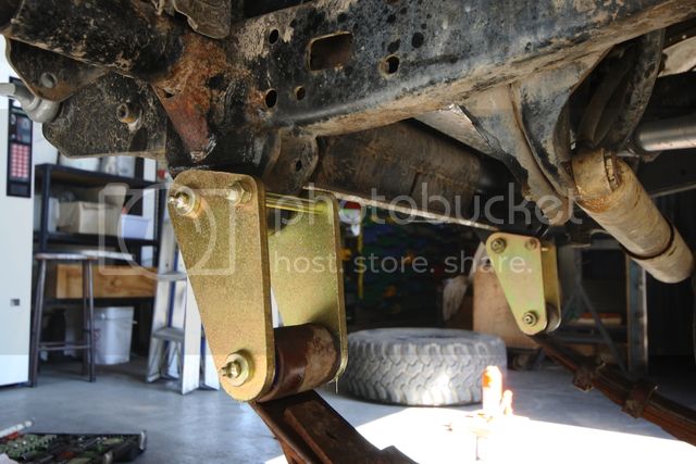

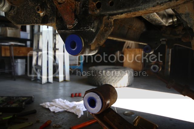

Fitted some exteneded anti inversion shackles,
already had poly bushes installed so changing them out was a dream.
New vs old.
New bushes,
Fronts,
Found out the fronts had plenty of down travel left in the springs and shocks, but the rear was pre loaded by a fair bit.
Im fairly sure the rear pack was a heavy duty tow package.
So i thought id try and soften it up a bit.
i trimmed down most of the leafs minus the ones with clamps.
Actually made a bit of a difference, quite a lot softer out back, think i need some longer shocks to boot , as they where bottomed out with a fair amount of pre load still.

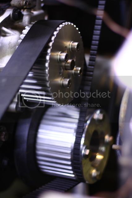

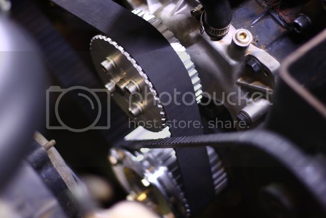

Fitted up a gilmer toothed belt set up.
All lined up fairly well , just need to trim one pulley for the a little more clearance on the power steering belt.

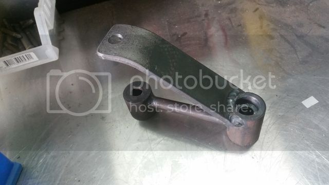

Built up an alternator bracket to utilise two bolts. I just had a simple bolt through a spacer before.
The new one will defiantly reduce any flex or wobble and much nicer spread over two fixtures.

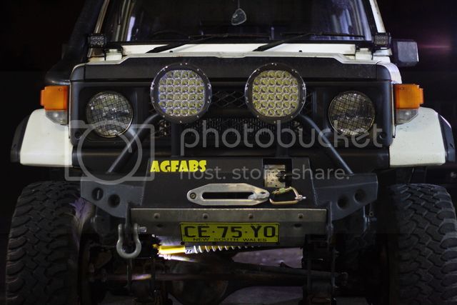

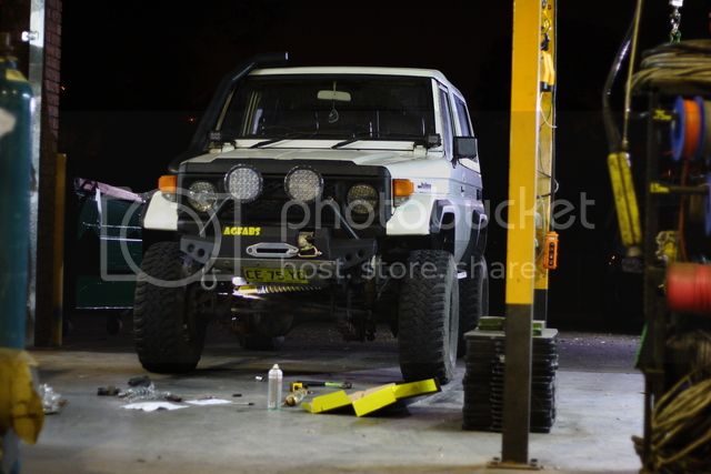

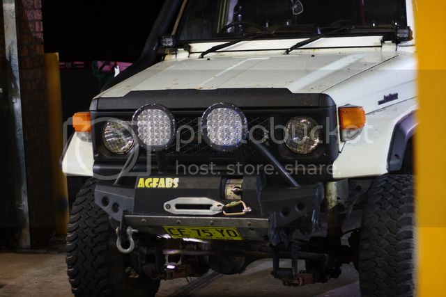

Succumbed to the fact I should mount up the front plate properly. Don't need anything additional for the plods attention.
Kind of works.

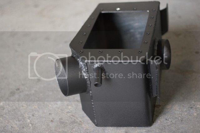

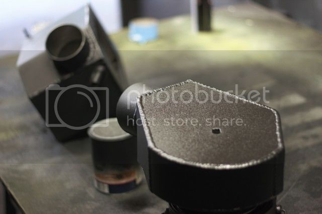

Added a inlet to plumb the crank case breather up to the airbox,
While I had it out I fitted the proper o ring for the carb hat and painted everything.
Need to do something with the rocker covers as they are far from water tight.
I also spaced out the polycarbonate so it wasn't so bent, looks a lot nicer now, still is crushing the seal more than enough.
textured black,

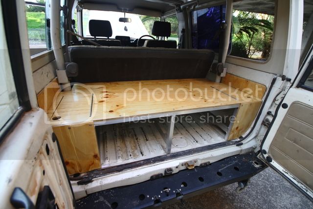

Made a start on some draws to house all the crap in the back,
Nothing massive just enough to hide recovery gear tools and fluids/belts and so on.
25x25x3mm Aluminium RHS
bought out the M8 nutserts.
Was going to clad it in plate but like the softness of timber.
Trapdoors for the side pockets.

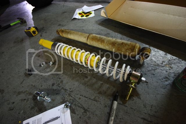

RTC dampner fitted , seems to have helped the front end shimmy out a bit.

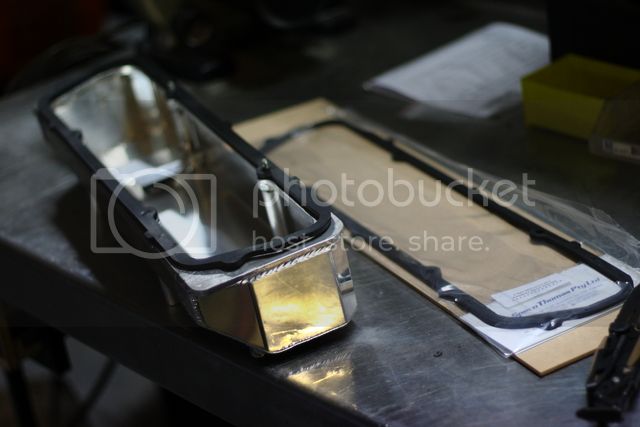

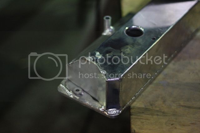

Fitted up some Rocker covers, hit the flywall so had to do a bit of cut and shut,
Also added a breather pipe,
Thick rubber gaskets to boot, had to remove the splash guards from the covers as they were hitting the rockers,
Have a weld on filler cap coming.

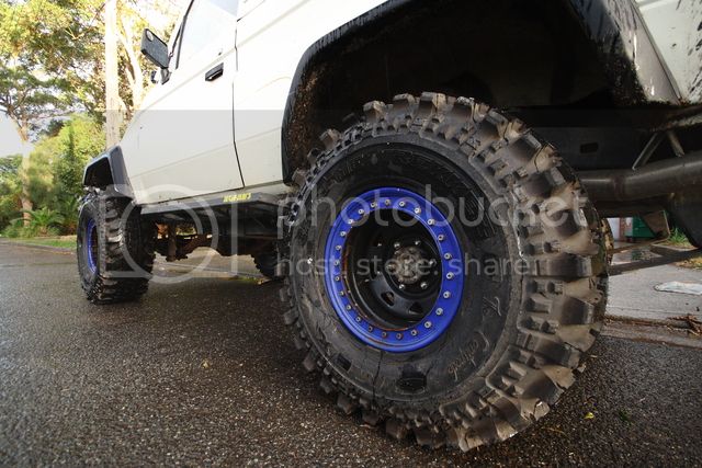

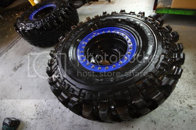

36x12.5x15 Simex Extreme Trekker The Centerpede 2, 15x8 Allied beadlocks.
Basically brand new, little rust from storage but otherwise in awesome condition.
busted 33's and spanking 36's
Getting very tall now,
Already ripped of the lower part of the front flares, trimmed them off, these tyres take no prisoners, will look at some panel trimming as well as moving the front diff forward.
hi, may i know that is the breather pipe for?
