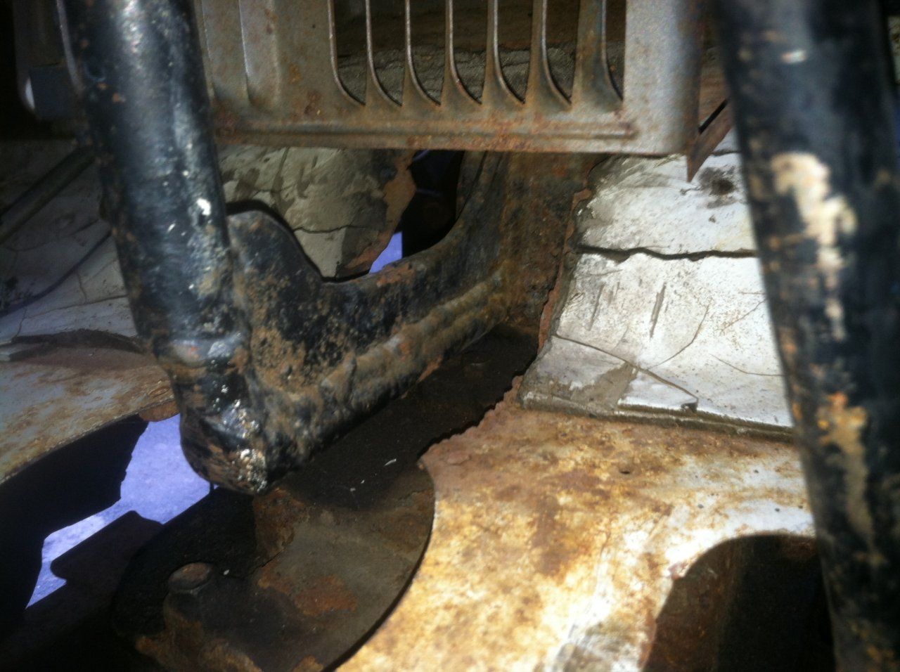

I've also been contemplating patching my fuel tank. There's a dime sized hole that needs to be patched. It hasn't had gas in it for almost 8 months and doesn't smell like gas. I've been venting it with a shop vac for a while and it smells like normal air.
Probably a stupid idea...
To be clear, I've taken an AVGFE class before...so this wasn't just a, "let's see where this goes."
Isn't that the pickup? It runs to a small threaded bung. It's been out so long I can't remember which is which.
I guess it is. That's the earlier, 18 gallon tank, isn't it? I don't really know about earlier tanks. I assumed the pickup would have some type of screen on it. It's a little hard to tell in the photo, but that is the deep part of the tank, isn't it?
Yep that's the deep part for sure, you're looking at the bottom.
