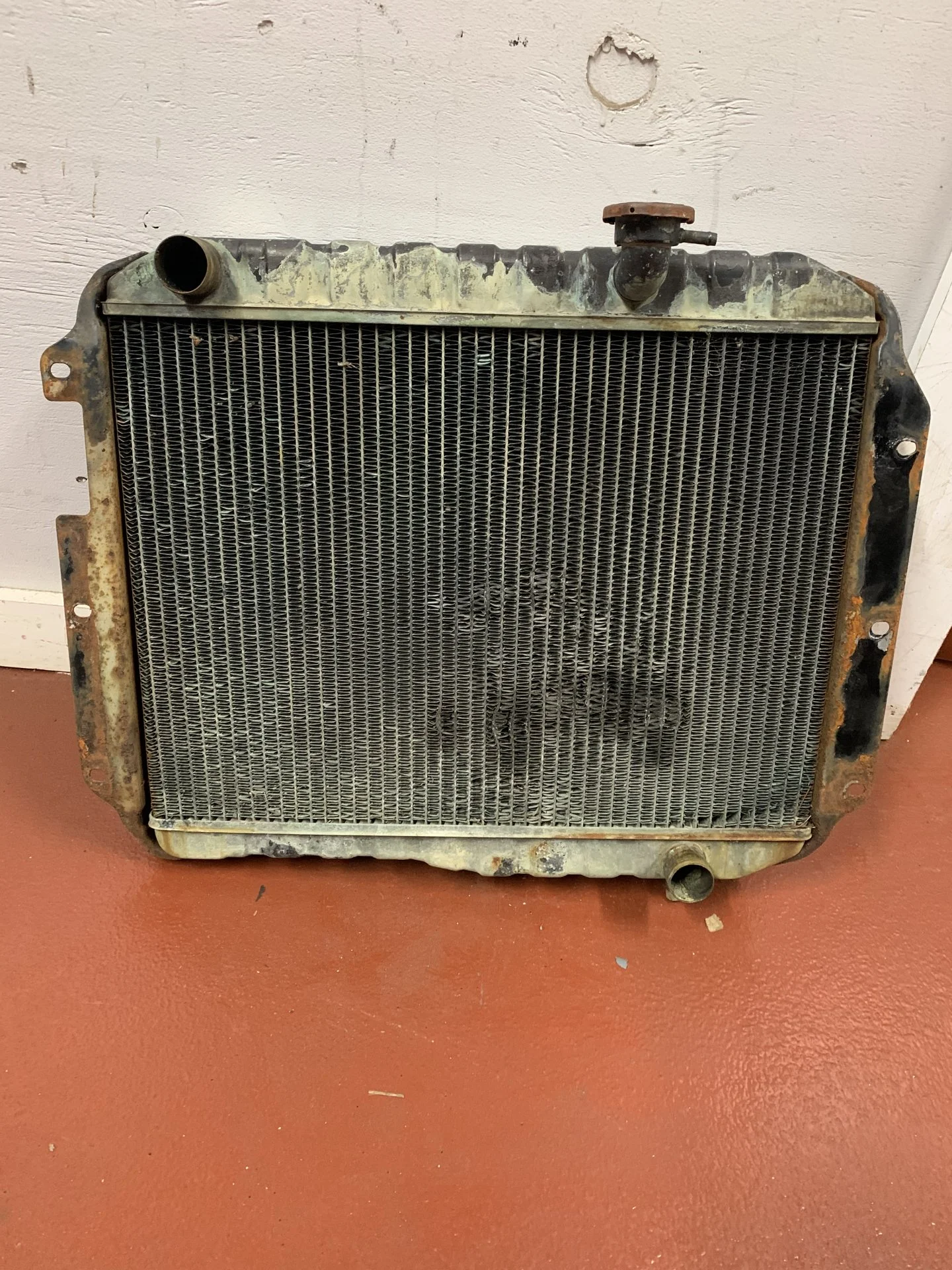

I sourced a radiator from a post 74’ truck. The parts breakdown shows a pre 74’ and post. I assumed radiator core got an extra row or something with the production of the 2F. Anyways the one I sourced showed up and doesn’t flushly sit against the radiator support. Can any pre 74’ owners send a pic showing the same pic I have here? Maybe it will help decide if I go further with this radiator or keep looking.
I added a complete view also. It has the cutout on the driver side vertical support that would copy the cutout on the later shroud as well.

that's a SNAPPY Sweet looking OEM ORIGINAL NipponDenso Unit there .............
in the blurry back ground upper LH side of above image ?
care to share ............. :D

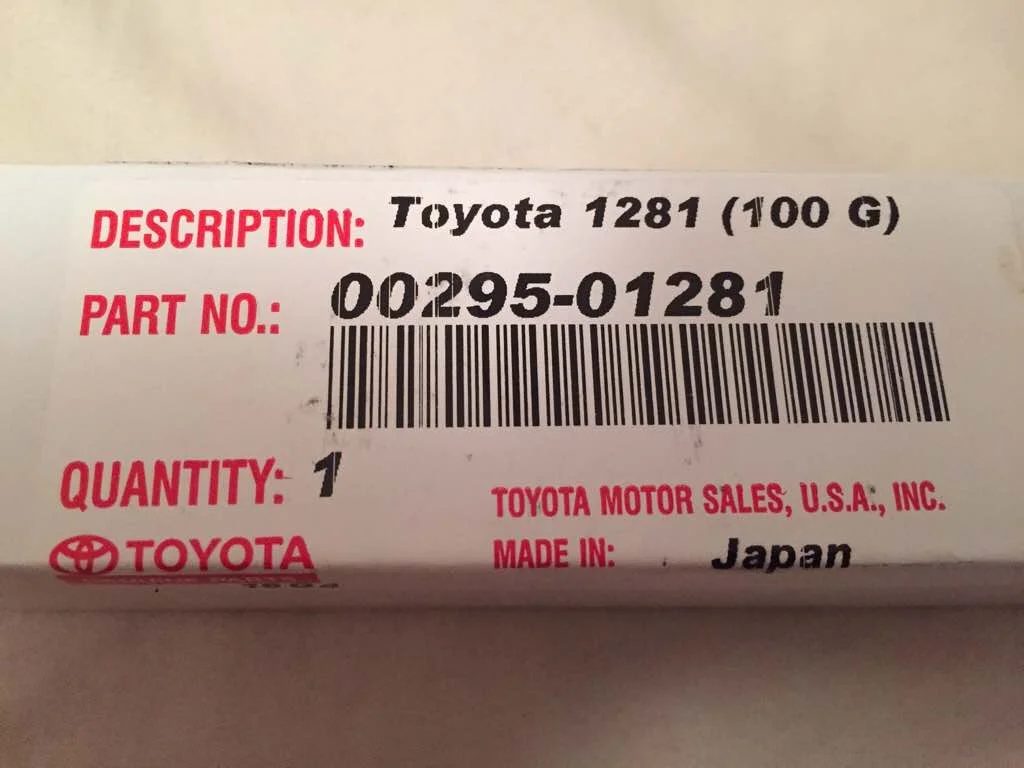

Before u get too far here ...........
you need :
Transfer-Case 4wd Shift Shaft Boot missing Part Call out # 36318 part # 36318-60010
CALL OUT # 31126 BOOT, CLUTCH RELEASE FORK part # 31126-60010
take the time say 30 minutes , pull parking brake drum .....
Install a NEW OEM Seal call out # 36132A part # 90311-45018
use TOYOTA FIPG
orange Transaxle and Gear Box HOUSING sealant
00295-01281
- Smear generously over both male splines use a cue tip smear same like in and on FEMALE parking brake drum inside splines
- Mate Together in SAME Exact order removed ,
- KEY point : NOTE staked NUT Manual STAKE punch detent , use
torque wrench , apply FSM required TOURQUE ONLT and NEVER past Original STAKE PUNCH
Detent Marks impressions
- if you have a COTTER KEY style rear park drum and cqastle nut detail parts note cotter pin locations with paint dots like a BB ball timing flywheel 7' marl for example same exact way
- used a ROUND or field made square 3/16 drift punch re-stake to original factory location ONLY , NEVER tighten beyond , u have a crush sleeve detail inside here ........fyi
- or replace cotter key same exact location removed from after pre load inital tourque step by steps in 3spd J-30 FSM chapters
- Test Pre-load per FSM best u can with a spring schale ideally , or the like
- if you don't replace seal leaks to come now or soon after easy to replace now ,
- KEY POINT NOT IN FSM : apply oem OARNGE FIPG ONLY NOT NAPA permatex EVER to be clear , if you skip this Updated asn widley accepted TECH upscale and modlern skool of thought step by FIPG step , Geat OIL WILL Seep and leak from between the male and femail p[arking brake drum splines from inside the t-case , i can say 110% it will sooner rather then later if not allready happening now ..........

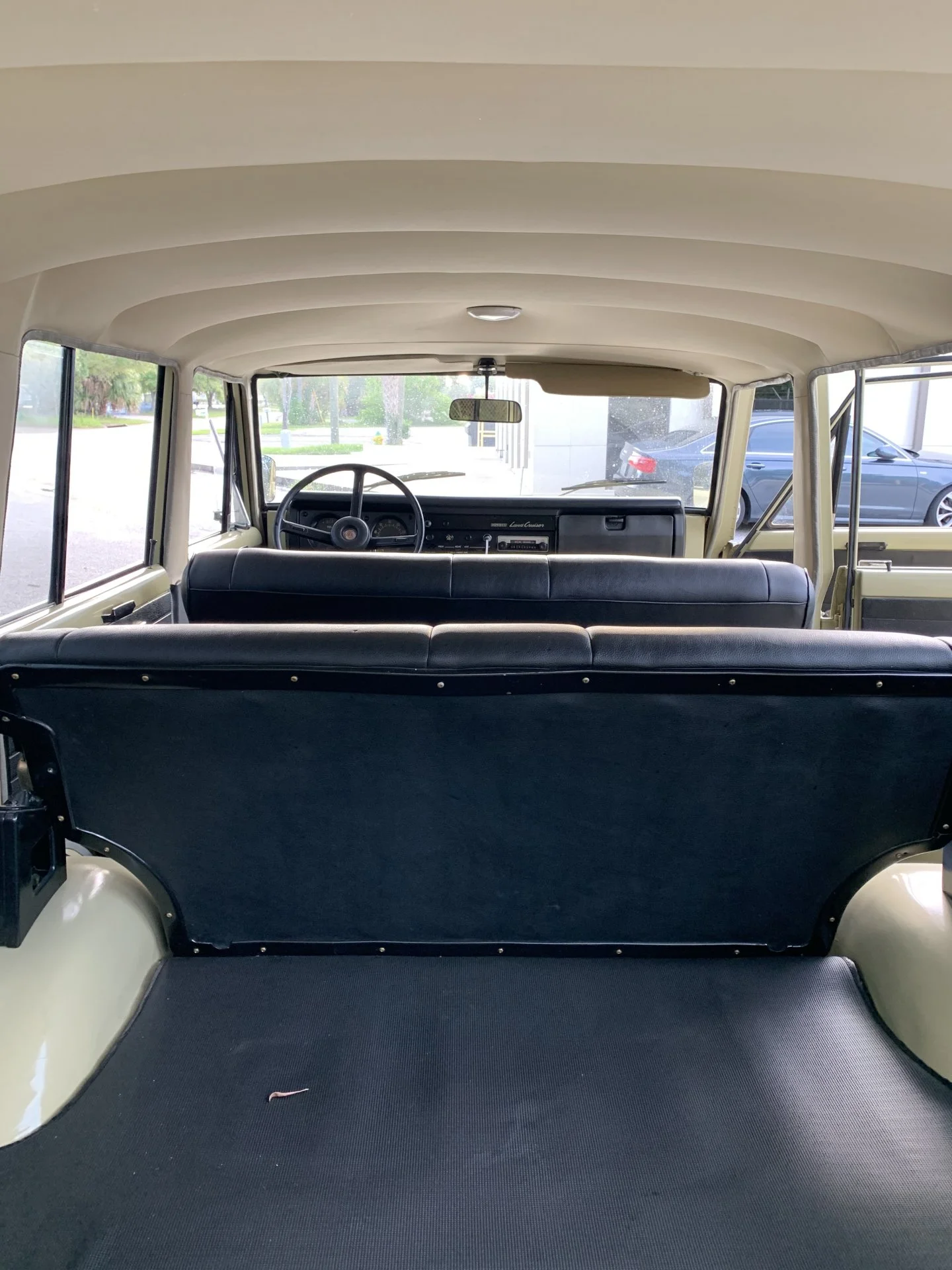

This truck has turned into a slight project / constant challenge to make it operate as it should. I purchased it because of a need to have a mode of transportation in NC. Figured I’d grab something I’ve wanted since my college years and this truck was sorta what fit the bill. I wanted a unrestored preserved truck as orignal paint does make me happy verse someone else’s short cuts and lack of proper steps. I sacrificed and got this one because it was basically completely taken apart and zinc plating done on every single item that they could think of. It just meant to me that it didn’t need to be fiddled with for the most part. Or so I thought.
I already introduced this to another thread but now I’m finding i need a place to land the documentation of all the work I’ve done and am doing. Get answers and advice here and there and maybe get some missing doodads.
That color looks great!
