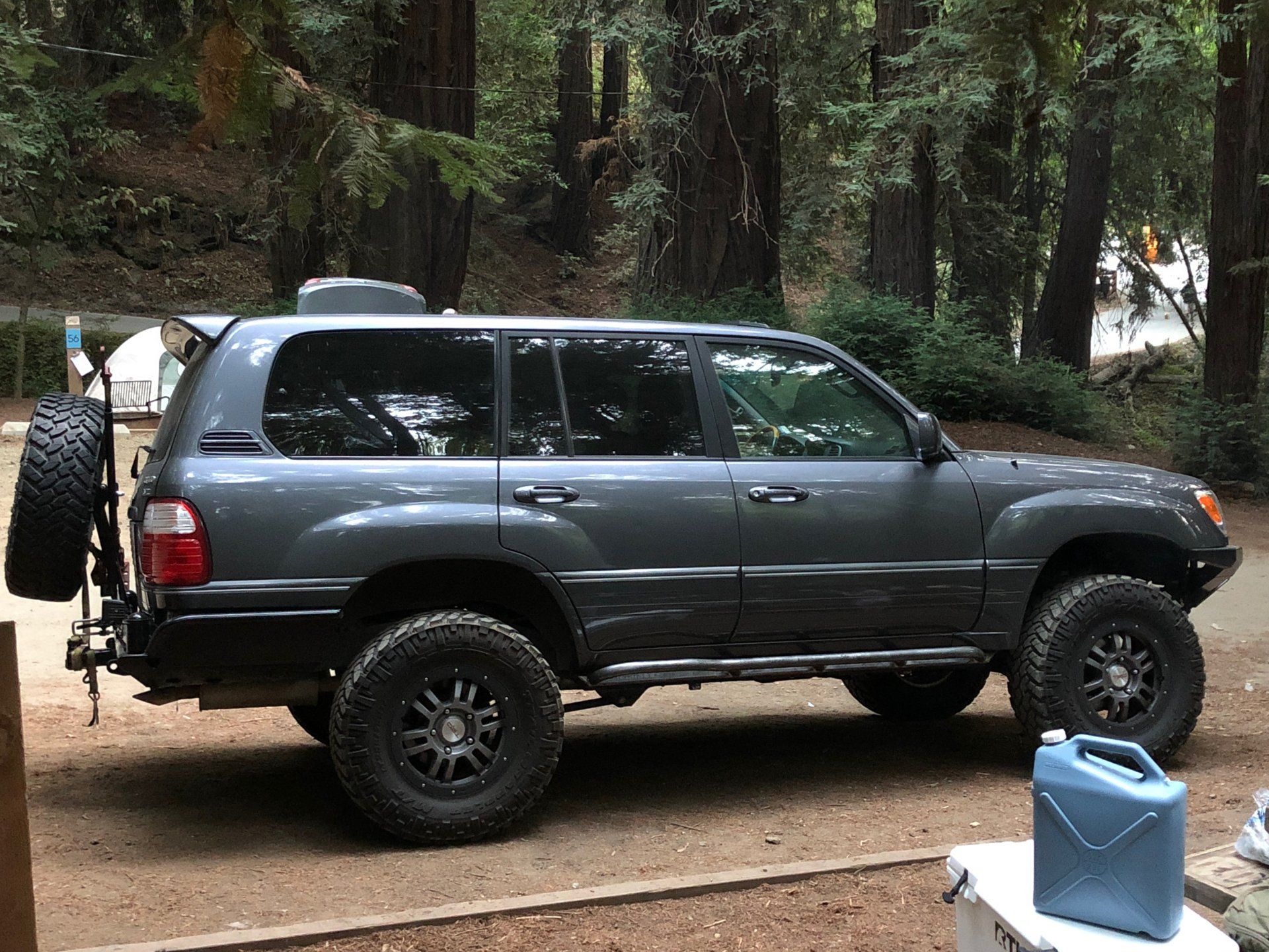

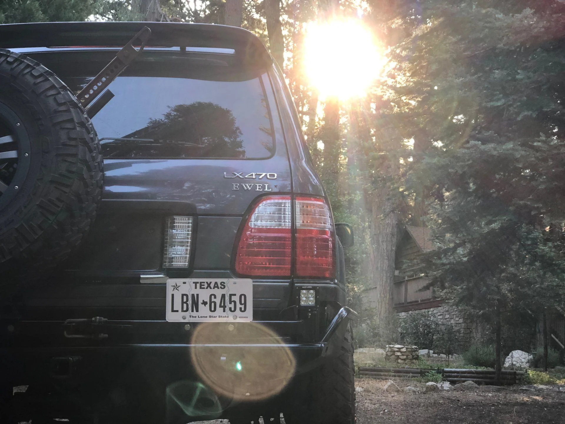

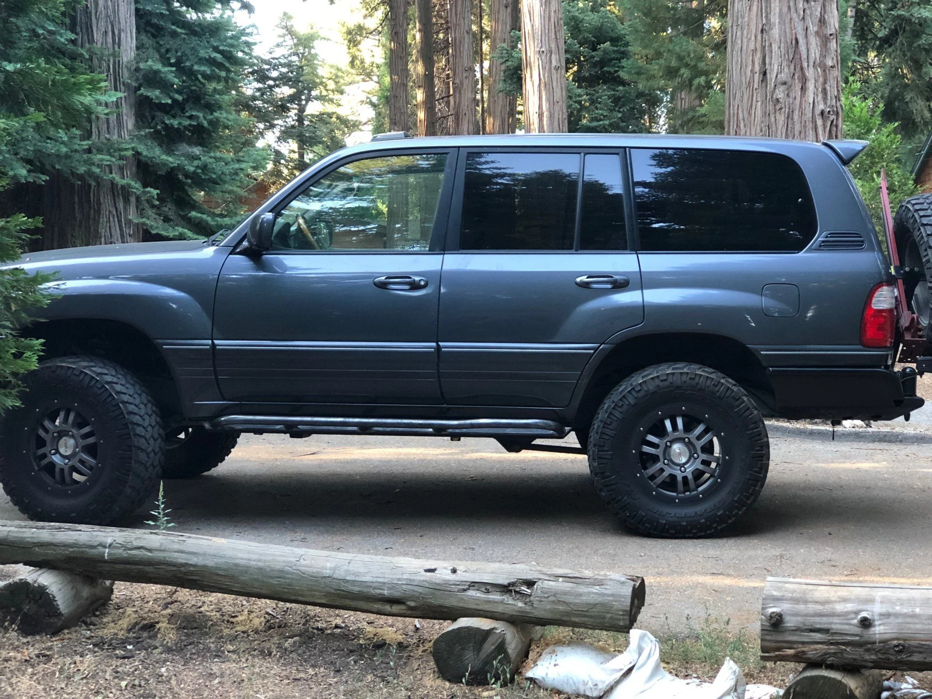

Few poser pics from our camping trip to Big Sur...hit a few really mild trails up there that led to some amazing views

Nice build - you can't post pics of the StarDestroyer and not give details on a beast like that.
Looks like Dissent front, 4x4 Labs rear bumper & sliders, Rock warriors, trail grapplers, what lift are you running?

So hopefully I’m not violating the rules here but I’ll give a quick rundown and then post a build sheet as well.
2.5” OME lift but running fox shocks
1” body lift
Slee diff drop
Heavy coils in the rear
Dissent front bumper
White Knuckle sliders (John from WKO is THE MAN by the way)
Rock warrior wheels with trail grapplers
Would love to do some mods to the interior as well but with my beautiful wife, four kids and a dog I need every inch of interior space!
Trying to decide if I want to go the roof rack/RTT route....lots of added weight up top with a pretty lifted rig...
