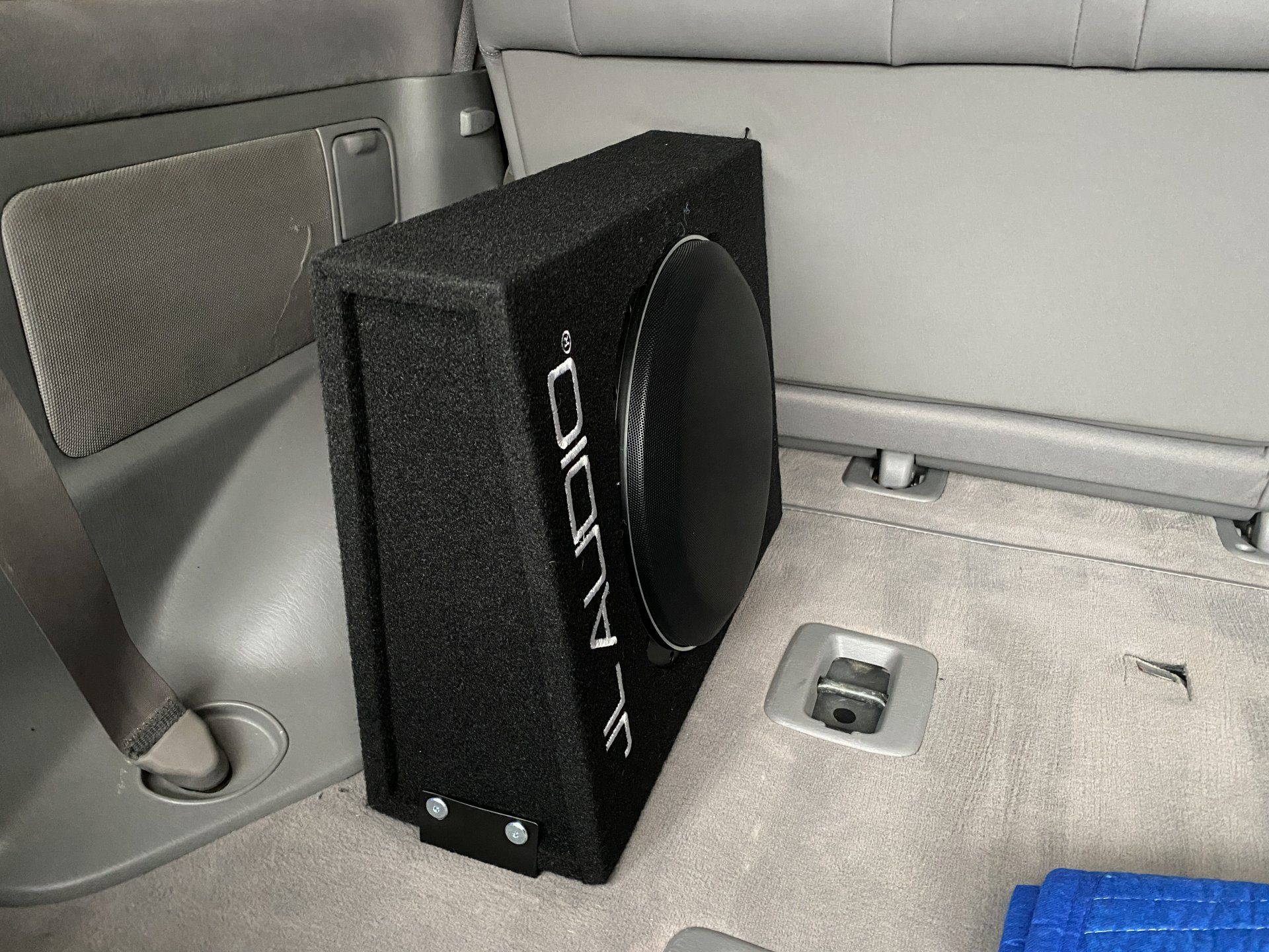

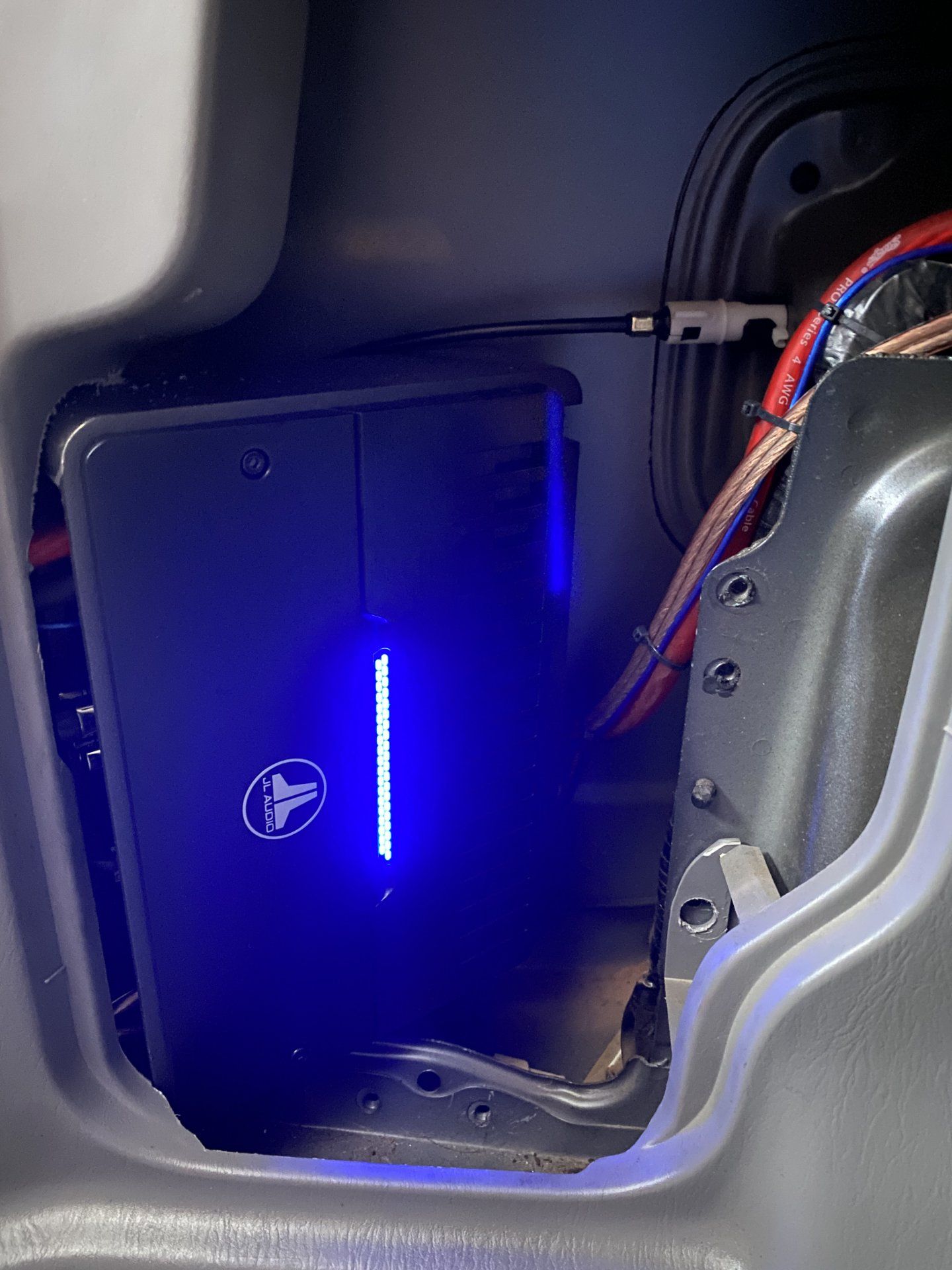

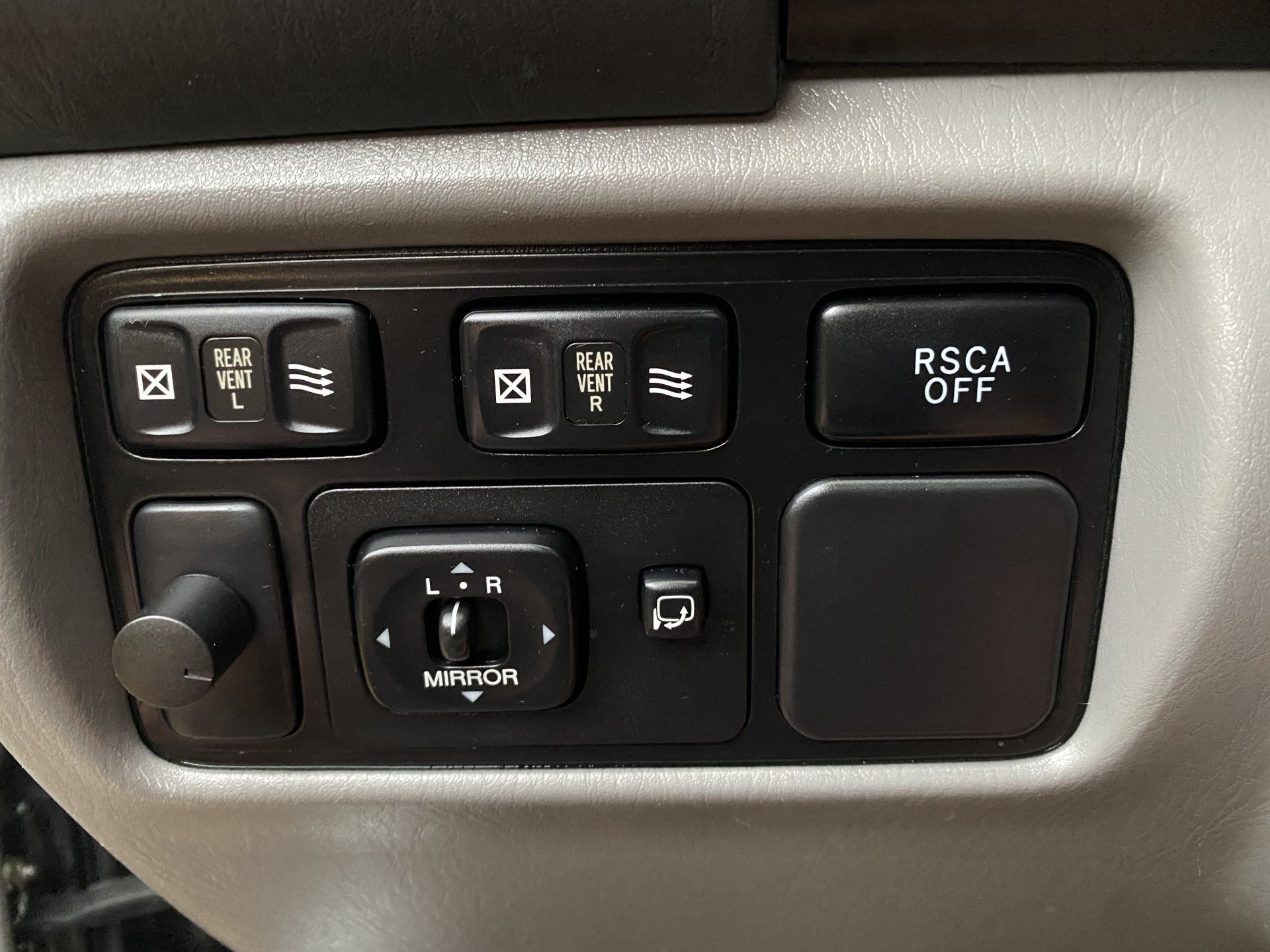

A few pics of the stereo install. Amp hidden in the jack storage area, sub knob in one of the factory knock-out panels on the left of the dash, and sub mounted in the back. Since we went with the 13" sub it didn't fit in front of the jack storage area like I had planned. I think there will still be plenty of room for the dogs with the seats down in the back.
Quality ... it comes at a price but I bet it’s worth every penny. Thanks for sharing, I got the itch to replace my whole system. Did they disconnect the rear sub and just tape off the wires or use the existing wires with the new JL or just runs new wires? (If that sentence makes any sense at all)

I'm not sure where they got the source signal, but it wouldn't surprise me if they used the sub wires coming to the factory sub for the signal into the JL amp. Then they ran new wire to the JL sub from the JL amp.

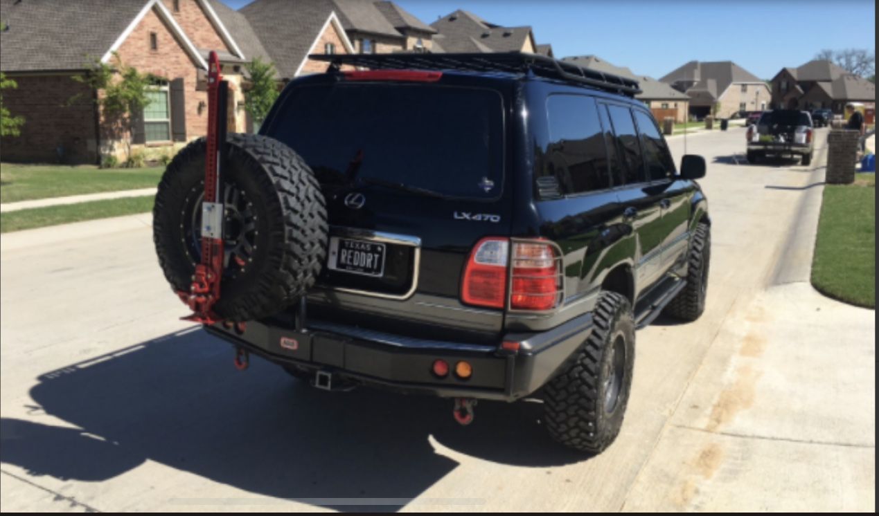

Here’s some motivation to get that build going.
These are icon wheels same size and offset as yours - tire size 295/70r17
ARB rear.
That's a great looking rig. Unfortunately the rear tire carrier is out of stock with no known lead time from ARB, so I'm just going to do two bumper blanks for now and will possibly get the tire carrier later on when it becomes available. Sounds like I need to look up the pinch weld mod, and get out the BFH. We just did a heat gun massage to the new G Wagon to get some additional clearance, so I imagine this will be about the same.

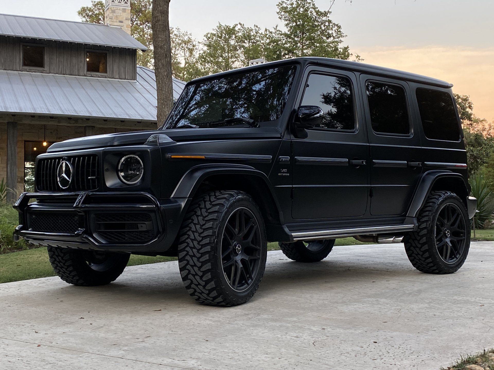

Here is a pic of the G that got the heat gun treatment. You used to be able to fit 33s on G without a lift of any kind, and 35s would fit with 50mm-70mm of lift if you had the right offset on the wheels. The new G63 has intercoolers behind the front bumper and the fender liner bumps out a bit accomodate the piping for them. You can massage it back though for a little more tire clearance.
