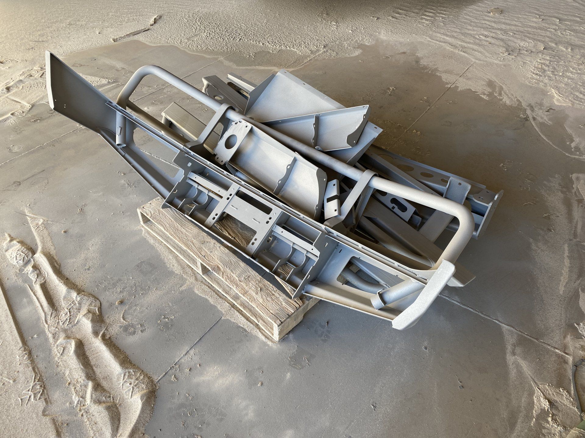

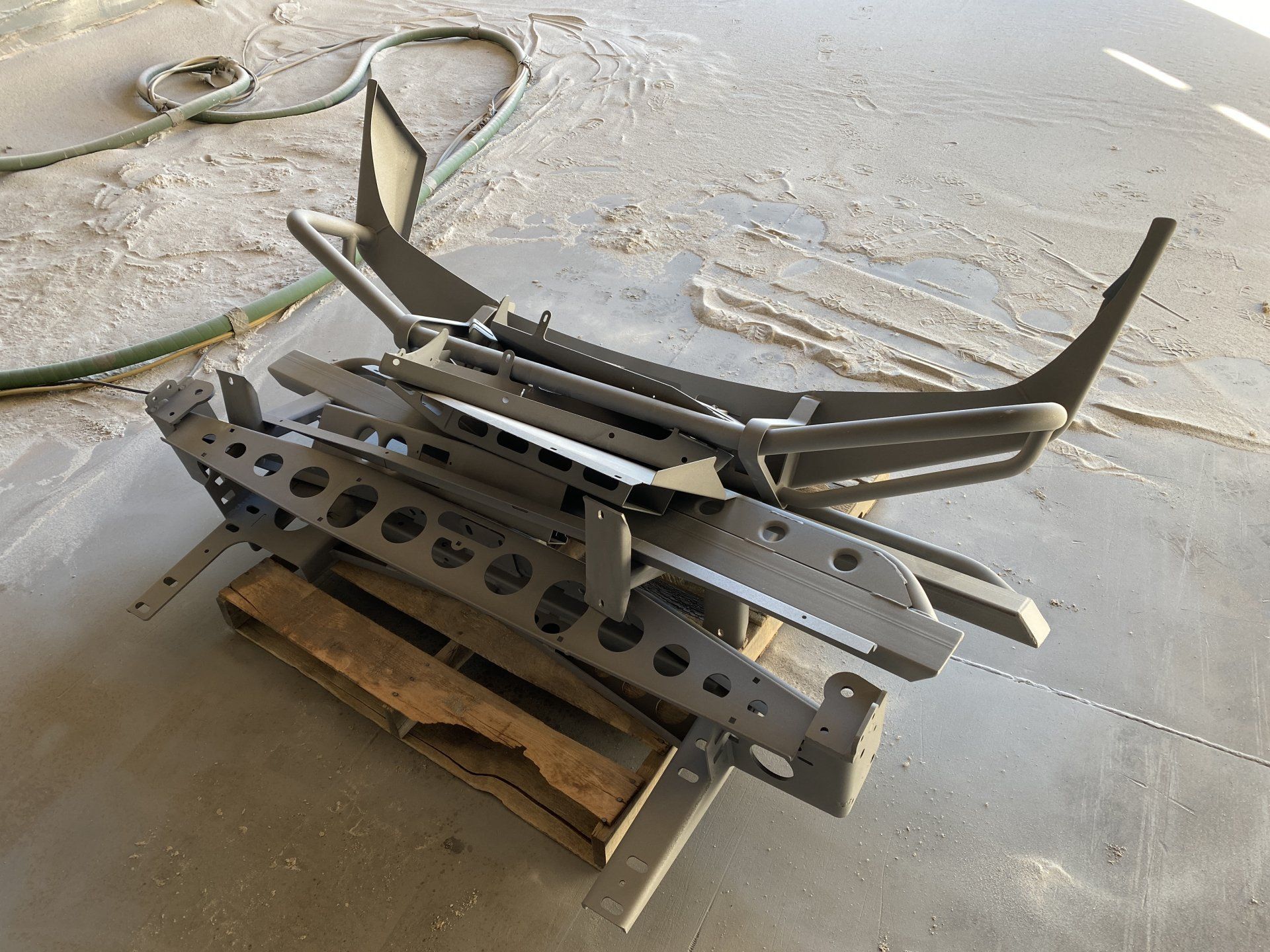

I had the bumpers and rock sliders blasted and dropped them off at powder coating. I think the color will be a little darker, but it's going to look good IMO.
It wasn't light! Actually, the front bumper weighs less than I thought it would, and the rear bumper is heavier than I thought it would be. What was really surprising was the weight of the sliders. I think one slider weighs nearly as much as the front bumper! Definitely beefy.
Bumpers and steps are back from powdercoat. They almost look black in these pictures, but they are actually Kingsport Grey from Prismatic Powders. I think they are going to harmonize nicely with the color of the truck. I mounted some Rigid reverse lights in the bumper blanks, and then put the ProComp rock lights on the corners of the front and rear bumper. Unfortunately I forgot to weld a bracket to the underside of the side steps for the step lights, so I'll have to come up with something for that. I know @Ramathorn15 has brackets that attach to the AHC, but I would have to modify them anyway for the ProComp lights, so I will probably just weld a tab to frame.

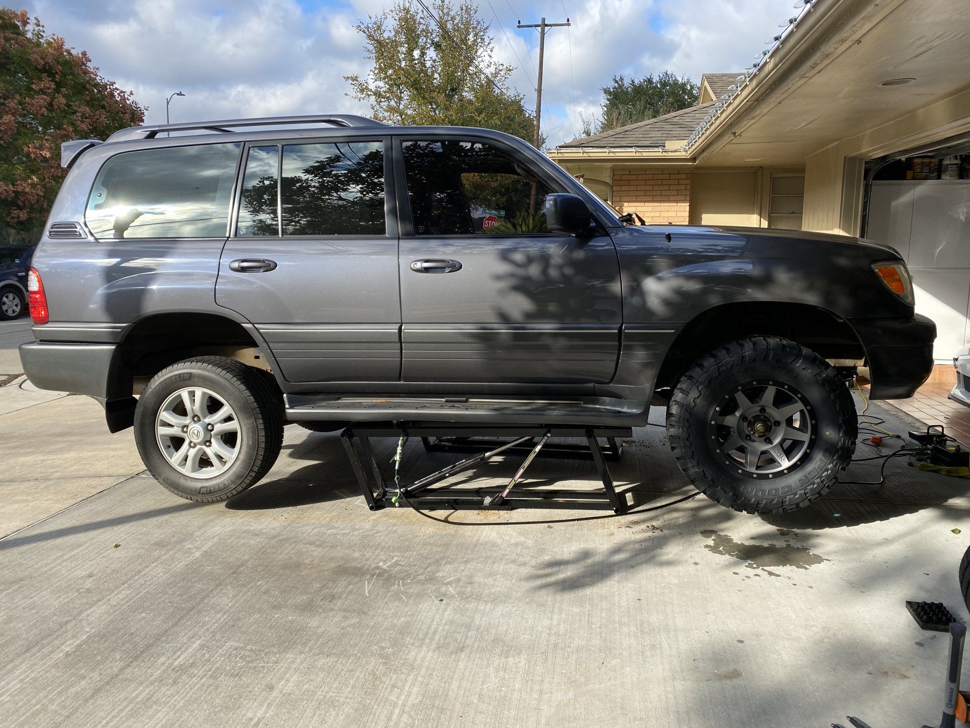

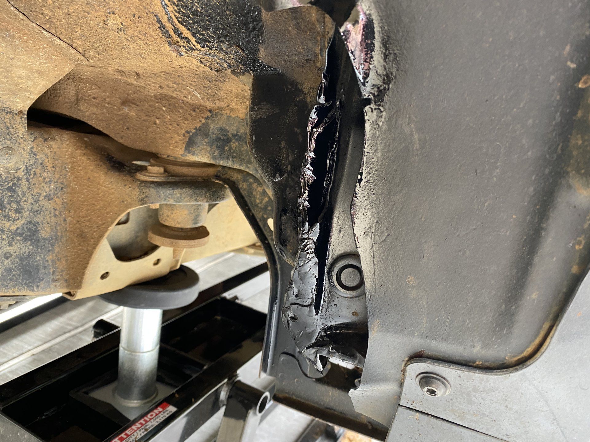

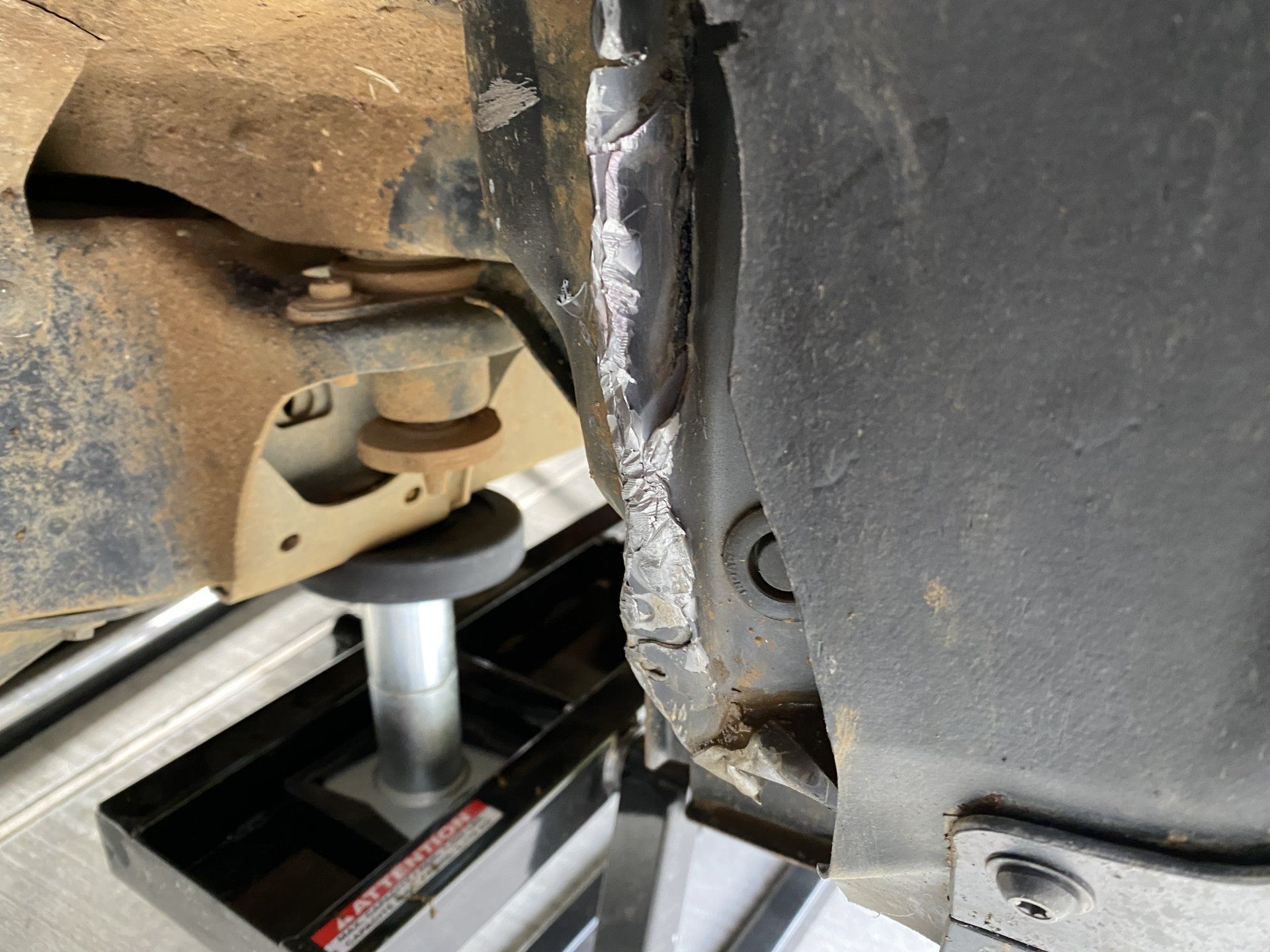

I got a few things done at the house since I didn't want to drive to the shop today. Pinch weld mod (relief cut, then hammer it over and squirt some paint on it), then removed the running boards. Who in the heck designed the rear, upper mounting bolts on these boards?! Not having a swivel head ratchet made the removal far more difficult, but I finally got them off.

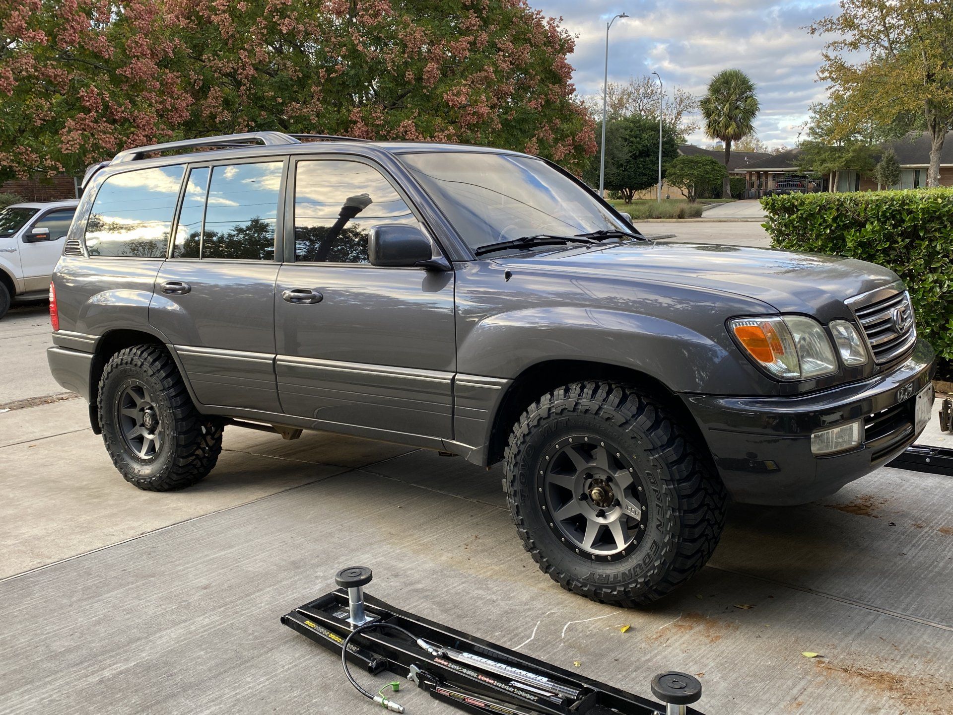

I'm pretty pleased with the way the new shoes fit. Plenty of room for normal driving. I'm curious to see if it ever rubs, but from what I can tell there is plenty of room.

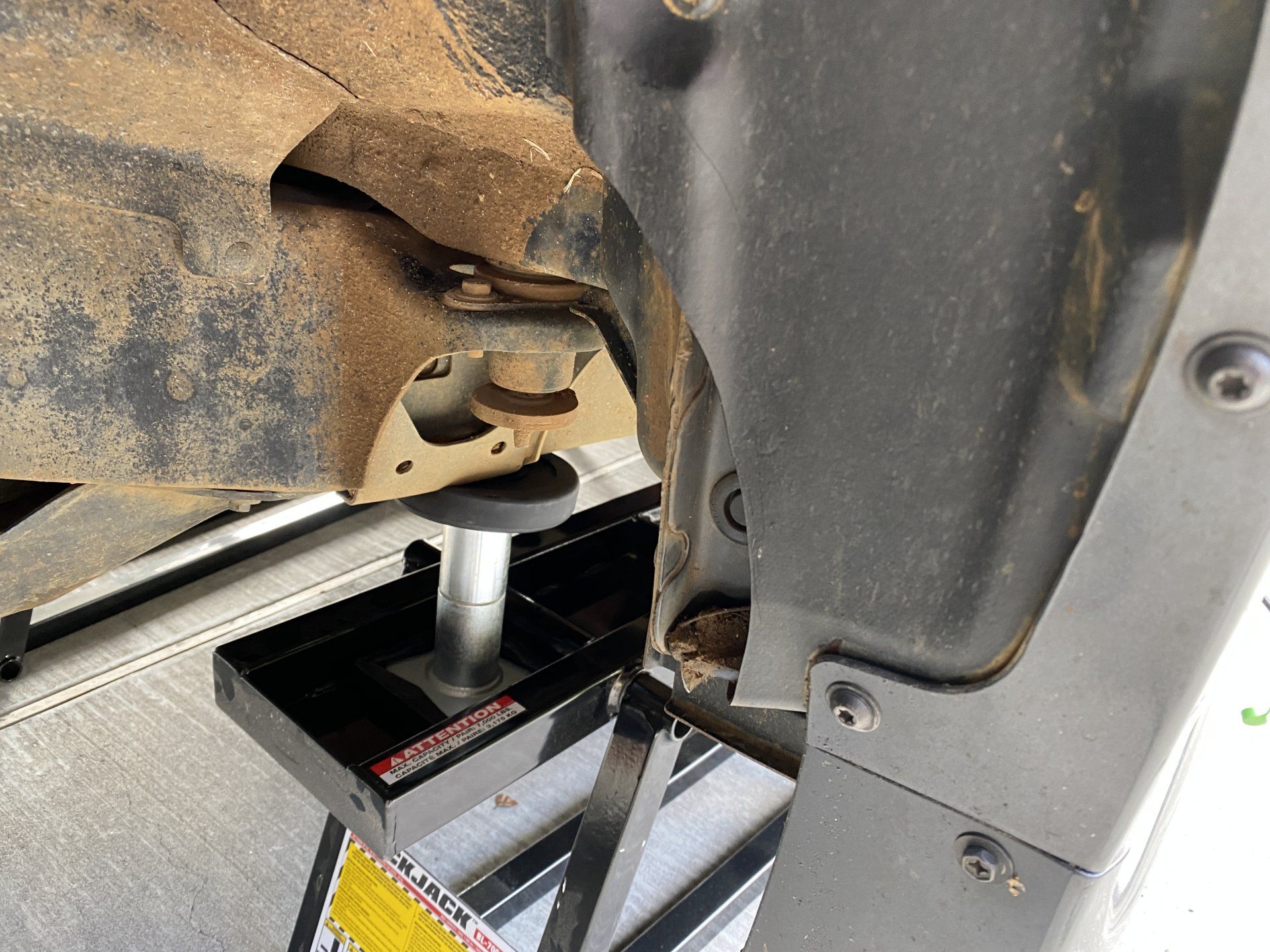

Great looking rig! Yeah, those pesky jobs can definitely get in the way of fun times tinkering with toys. What size tire are you running? Does it rub on the pinch weld currently? After doing the mod there is tons of space in there. I almost think I could have just trimmed the fender liner and not done the mod, but maybe not.

285/70/r17. They just barely rub the fender liner depending how hard of turn I'm making. Next big project is fine tuning the AHC. I also went with metal tech sliders which arrive next week and sent off for powder coat.

Well after messaging the plastic down with a heat gun, I'm still getting a little rub when fully turned. It seems I will need to complete the pinch weld mod.
The pinch weld mod isn't tough, but you do have to bang on it pretty good with a small sledge. I used a 5lb sledge and it worked pretty good. I did the relief cut about 6" from the bottom, but I'm not sure that's needed. I know some people do it with the tires on the truck, but I found there was just enough room with them off the truck. Made getting the right angle of attack much easier not having the tires in the way.
