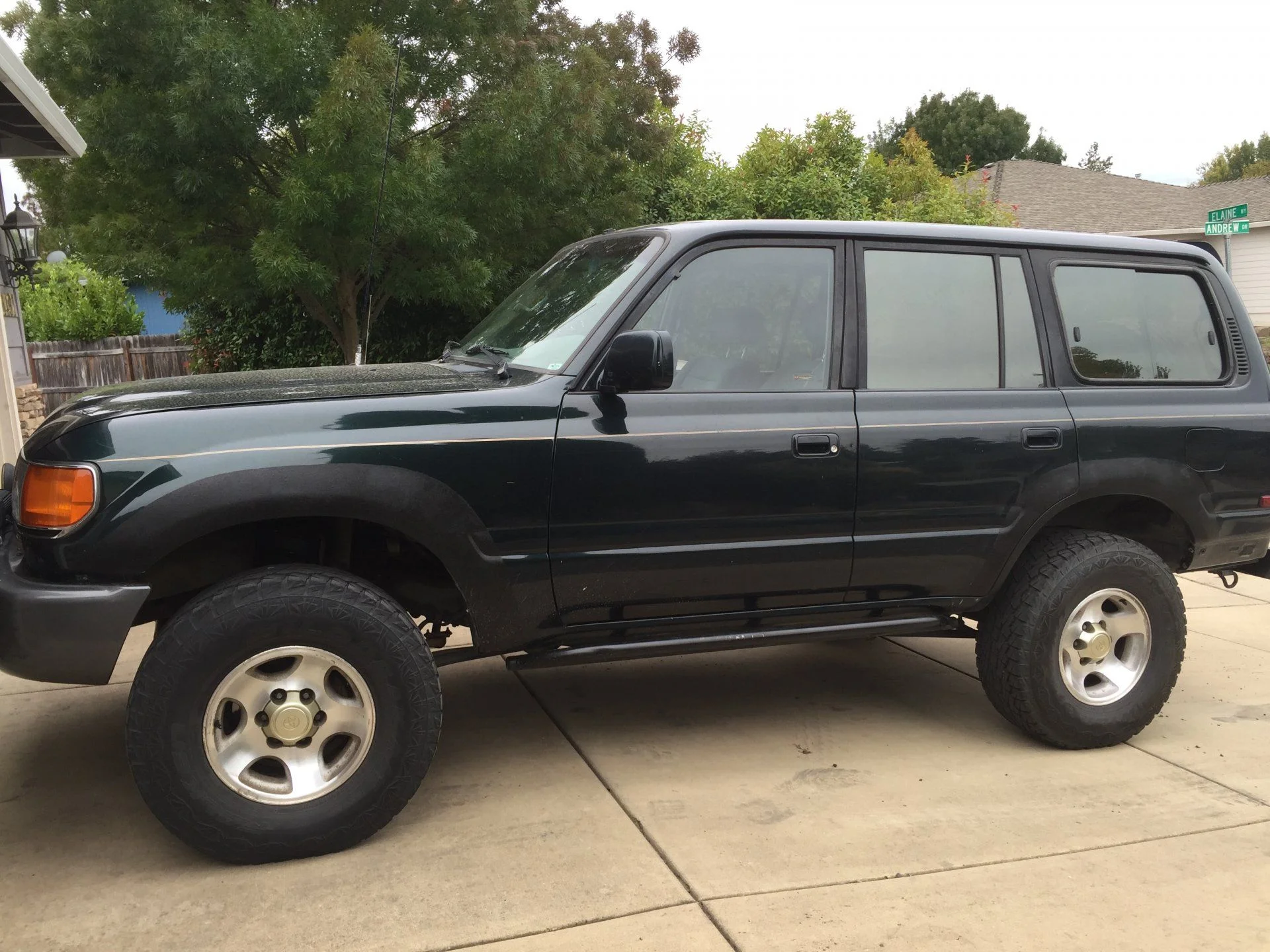

Somebody is getting another cruiser today.....I am thinking a thread may be in order.
Or not. Craigslist is fun!
As she sits today on new
Falken MT 315's
