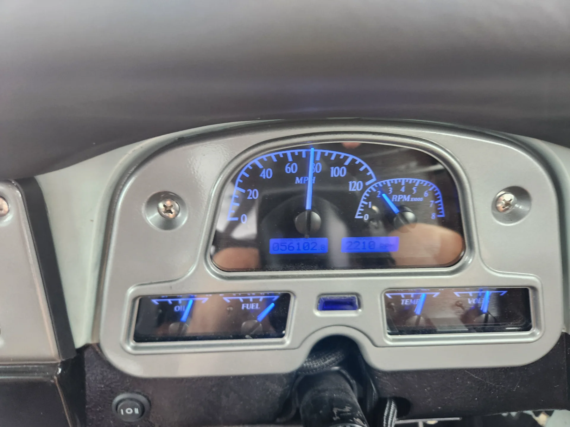

3.70 axle gears, 33" tire, H55f transmission, stock transfer case gears. Should be ~2500rpm at 78MPH
Speed is calibrated to gps, but it runs off the transfer output. 3.70 diffs, 1:1 high range, 33" rubber.
Cruise is very comfortable at seventy five miles per hour. She happy at 80 too, but I'm still getting used to her. 17.2 mpg at 75 mph with air ain't bad either.

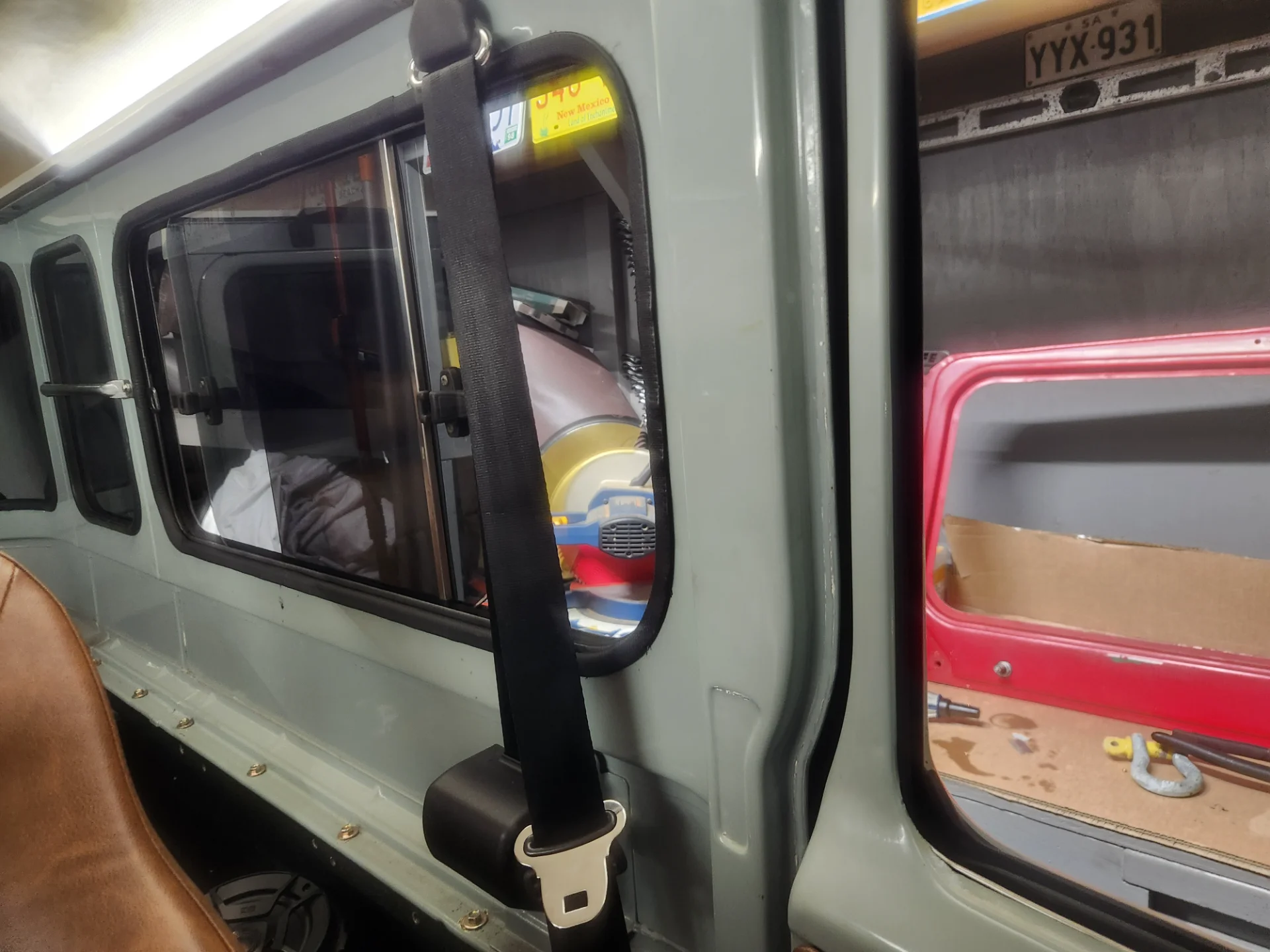

New slider window is in. My son helped me put it in when he got back from surfing (good waves right now due to the hurricane in the Gulf).
I couldn't have managed this at all though without @matt tin, thank you for finding this mate. It's guys like him, @cruisermatt @Living in the Past @frankenyota and many others who make this site so great.
Josh could you take some pictures on the inside of the sliders? Didn't play that close of attention when I grab parts off a wrecked troopy back in 2015. Curious how much it would interference there would be with a roll bar.
Also when when say speedometer uses the output of the transfer case is that rotations off the driveshaft or the speedometer cable connection? The cable connection speed varies depending on the number of teeth on the driven gear.
It's flush with the inside @Living in the Past . That's why it sticks out on the outside. There's no way it could get in the way of a roll bar so long as the bar fits with a factory hard top.

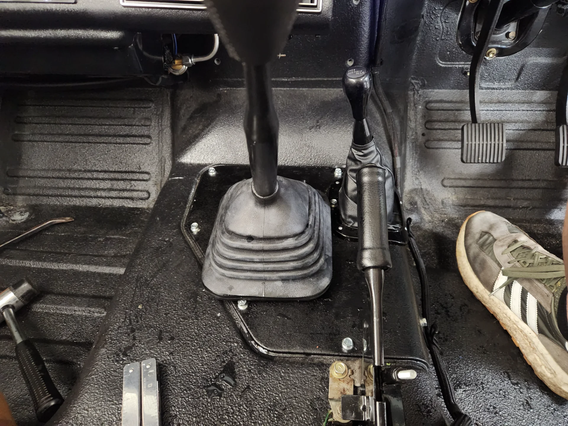

I satisfied some OCD: put the shift boot on the outside of the shift cane. Also installed the receiver hitch.

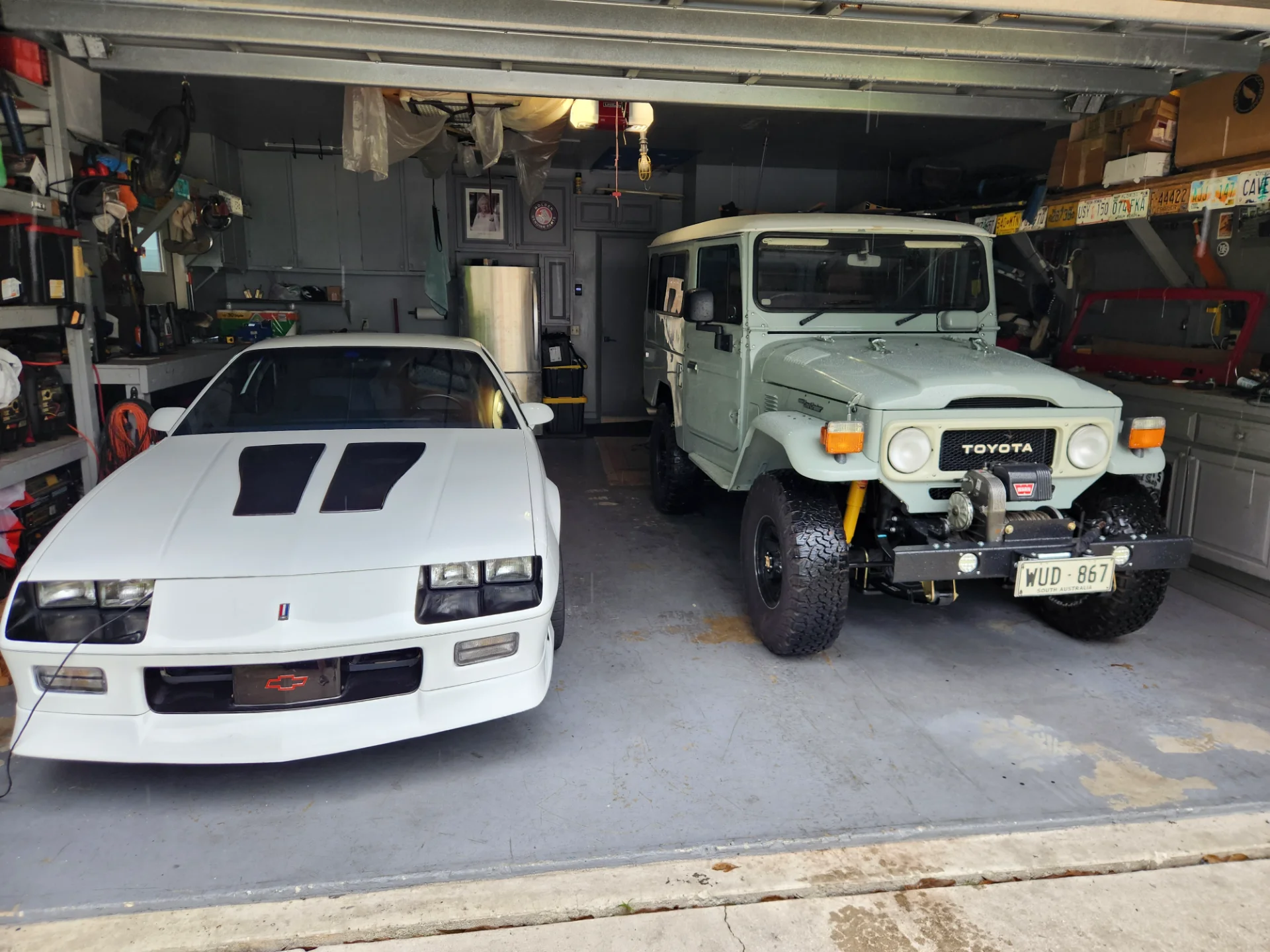

Everything is looking good. When you got it home, how many times did you open the door to the garage to look at it, or go into the garage and look again?
I remember you told us about the first ride, with your son, being a little scary and his comment. Has he gone for a ride in it now, and if so what did he say?

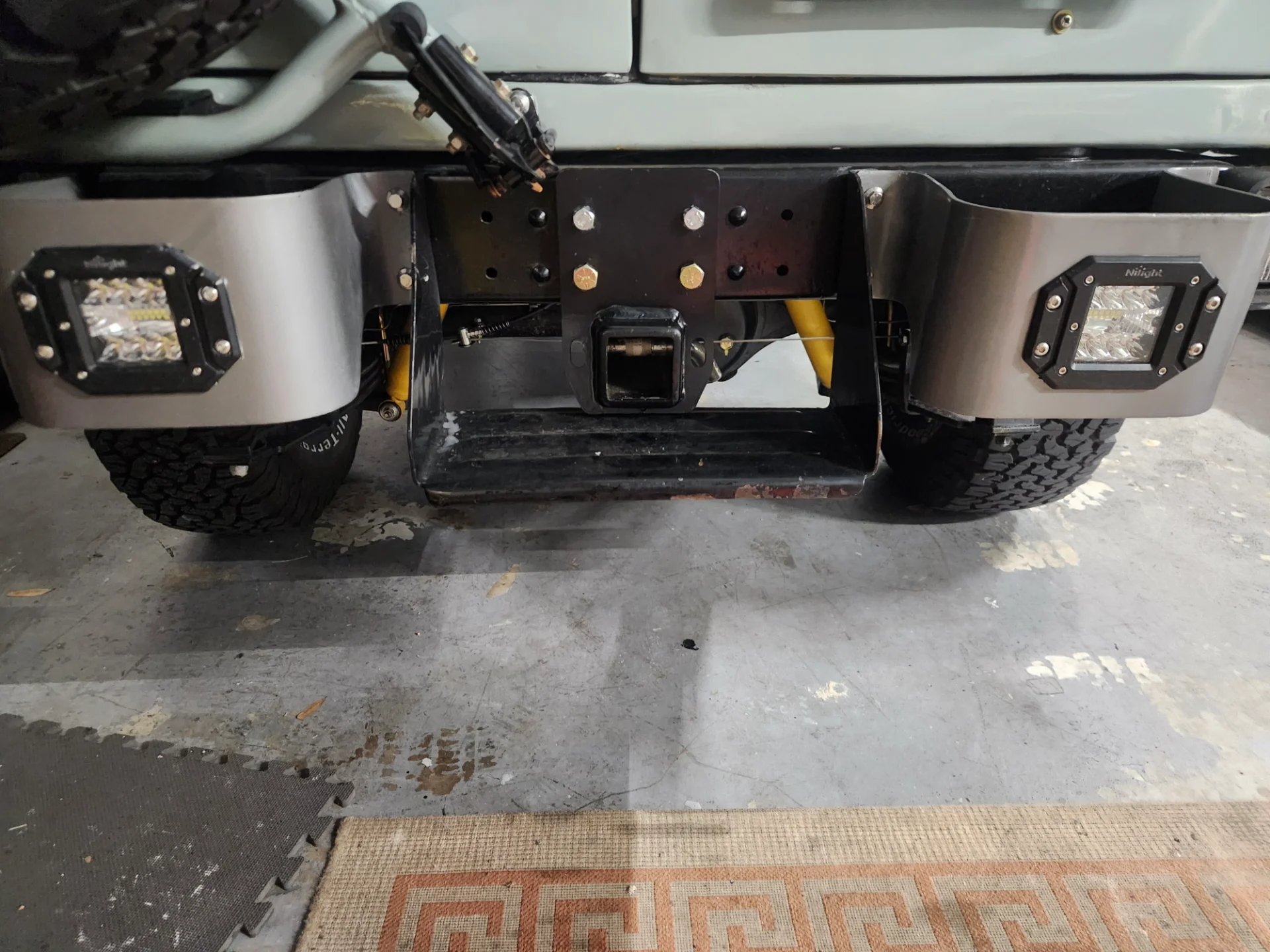

I have been wanting to add some additional reverse light to mine too, and trying to decide the best way to go about it. I bet those work well and throw out a LOT more light.
It's good to have it back. My son really likes it. It's funny, I haven't gotten to the point where I'm just admiring it yet as I'm still doing all the stuff I wanted to do to it while it was the CruiserSpa. But my son often just sits on the garage in his camaro talking to his girlfriend, and he keeps telling me it looks great😁.

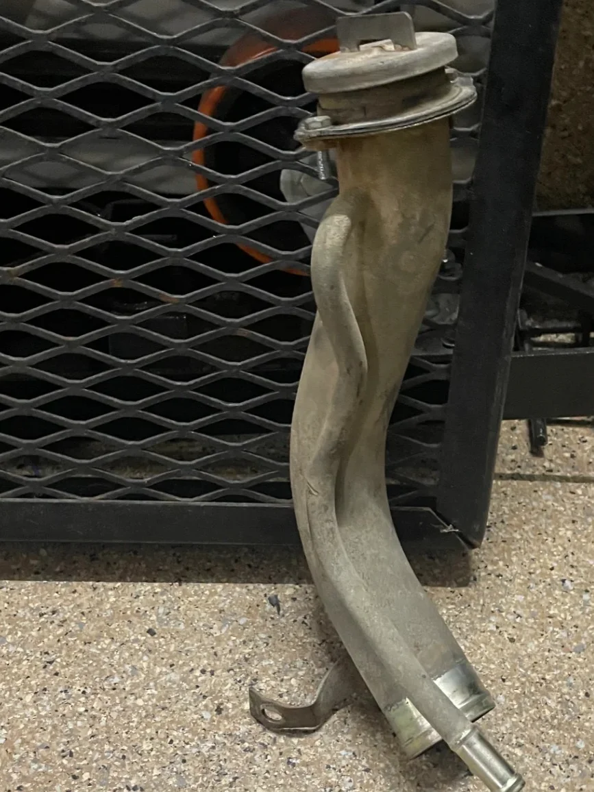

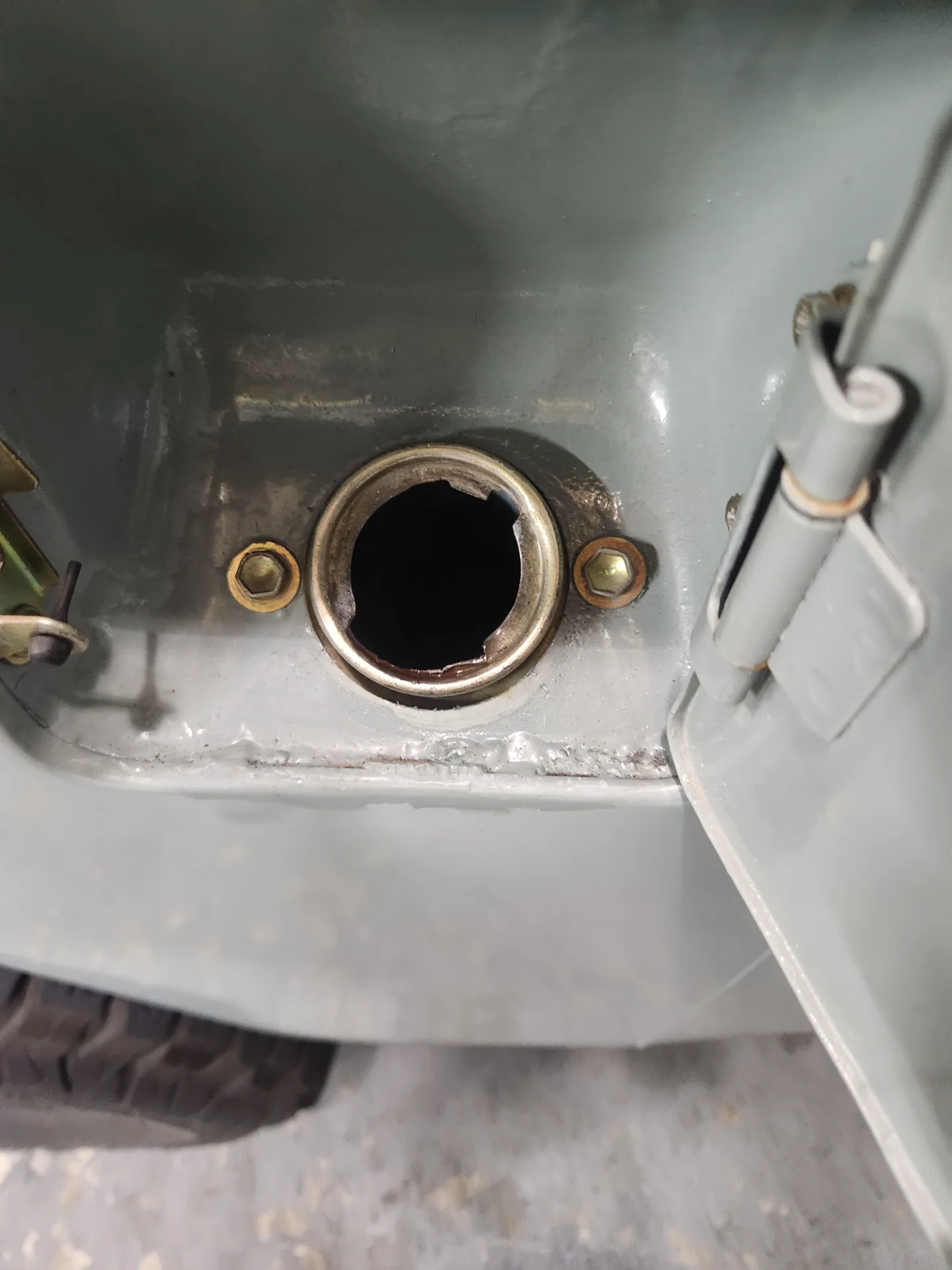

We do need to get rid of the fuel smell though but it's great otherwise. I've got an ad in the wanted section for a new fuel filler neck is anyone know of one for a '79-'84 out there. When the tank is full it's nearly overpowering.
Those backup lights are awesome. I've got them on a separate switch, so they work equally well as anti-tailgate and 'excuse me, you forgot to dip your brights' lights as well.
The plate that covers the fuel fill area on the inside and the cover that allows access to the fuel level sensor are the place that close to the fuel system. Both those having packing. I would checked both but especially the fuel fill area that has the fume recovery tank inside.
Besides a new cap and gasket plus a part called a shield, part number 77293-60030.
If that filler neck is the same as the FJ40, here's one:
https://cruisercorps.com/pages/search-results-page?q=fuel filler neck
Here's a reproduction stainless steel, don't know if it would work for you but you can take a look:
Gas Tank Filler Neck - https://www.coolcruisers.com/gastafineusp.html

1/79 everything changed. The fuel tank grew to twenty two and half gallons. Mounted underneath the tub. With a hard and windows closed you shouldn't get any fuel smell. Old pictures I have of an 82 tub. Did not come with covers. I pulled some off a wrecked troopy that had black bed liner on the interior. Can see the covers in the pictures.
Only additional thing I could think of is seal the seams on the compartment where the fill and fume tank is.
