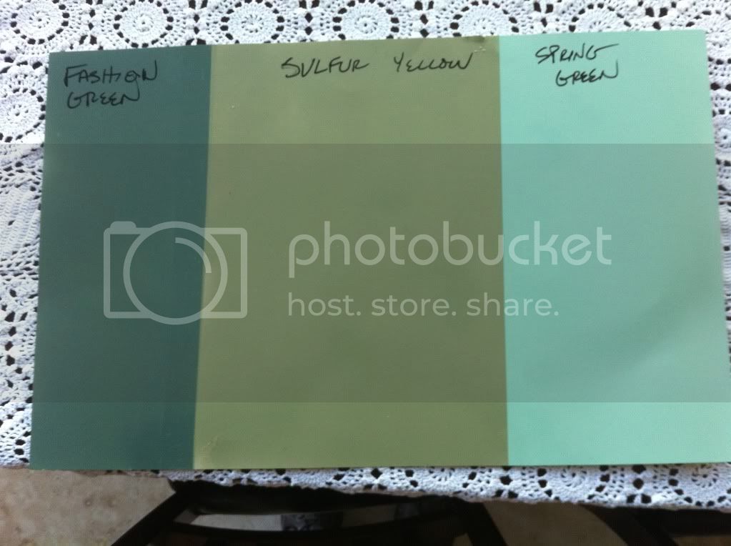

My color progress so far, whatcha think?
OK,
So I have sprayed out each of the three colors I have so far, with Sulfur Yellow being my desired end game. I show the others as they are straight out of the PPG computer. The PPG system had Fashion and Spring Green. Sulfur yellow is eluding me, but after some time at it I think I am pretty damned close.
Here is Destin's scan from the toyota color chip:
Whatcha think? It looks like it might be a tad bit dark, but not by much.

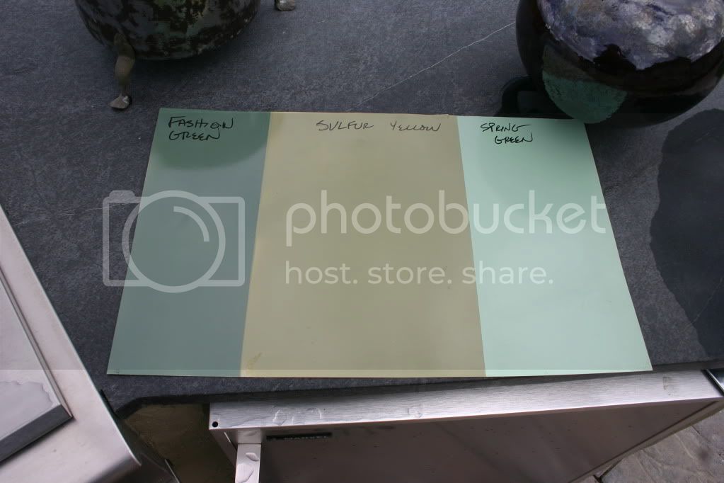

OK, here is a better pic taken with my SLR outside in daylight (not sunlight, cloudy). I think this looks better, and makes for a more accurate comparison with the rig sitting in the sun.
Whatcha think Destin?
Oh, and how I got here. I photoshop'd a large image with pieces of the chart you sent. I then had the local photo shop print it and took it in to my paint shop. We then tweaked a little and this is what I have!

I love the green in the photograph but you're only going to match that look exactly for about an hour a day. If you look at the length of the shadows in the photo, it was taken late in the day on a really bright day (typical photographer trick). The light has a yellowish/reddish cast to it. You might try looking at/shooting the paint chip some day at sunset.
That said, I think you've got the right color in Sulfur Yellow and it's a great choice.
