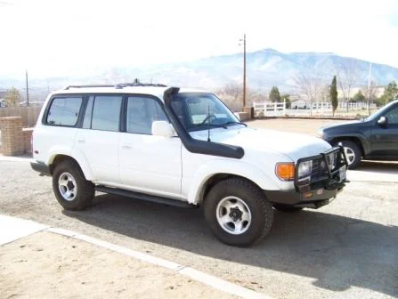

The dorkle (I mean Snorkle) has been installed. I also installed Slee's AC dryer skid plate. It doesn't look like much in the pictures, the light was all wrong, but it will save an expensive part from damage.
Yep looking much like the poser now...

Is it just the lighting/shadow or do you have a rear non-OEM bumper mounted?
Nope, still the factory one, for now.
