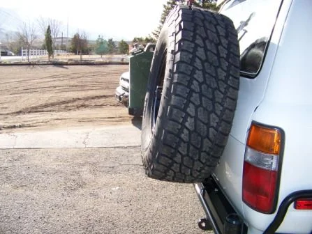

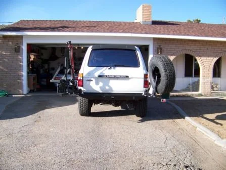

Hey Jack!
The swing outs look GREAT!
You made awesome use of space. I might be re doing mine after the blotch trip. Im just not really diggin how they came out.
The tire S/O I like, but....yeah, theyre both gonna get re built.
I didnt notice in the pics...did you put a spring pin on the swingouts?
You know those lil deals like slee puts on his and it locks out the swing outs in both the open and closed positions?
Nice job man!

Hey Jack!
Nice job man!
K
Thanks.
That was why I didn't powdercoat my swingouts, just in case I didn't like how it turned out after I got it done. So far I like it, but will know for sure after a trip or two. This is the third bumper/tire carrier I have built for my stuff and have helped on a few others, you will always find a better/different way of doing something. Sometimes you can look and think something to death and think you have it figured out, but once its together, it just didn't work out like you thought (been there).
No pins, I used the gas struts that 4x4labs supplies. They work on an over center/cam system. They help keep the swingouts closed even if the latch is opened and then once over center, they push the swingout open and will hold them open.
