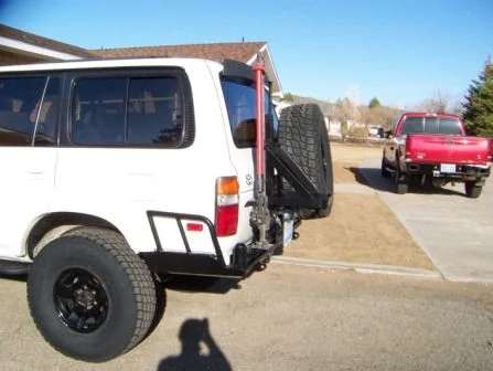

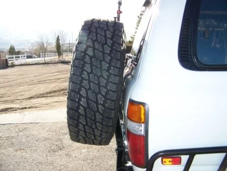

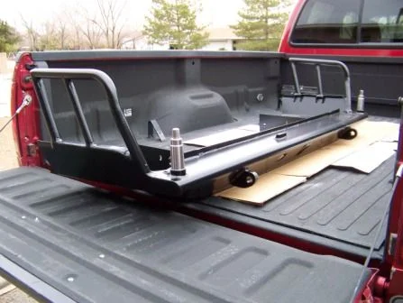

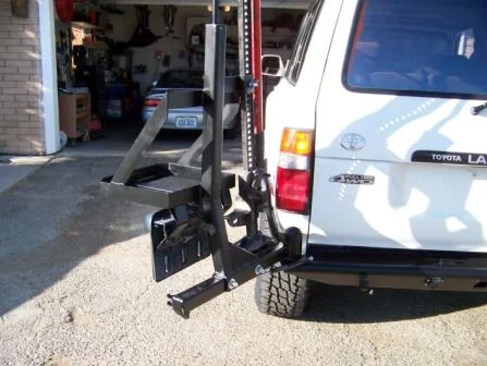

I fianlly got the rear bumper done. Here are some pictures.
Now that the bumper is done, I am just going to get my 2m radio installed (I have a place to mount the antenna now) and I'm going to call it good for a while. Time to use it.
Jack
