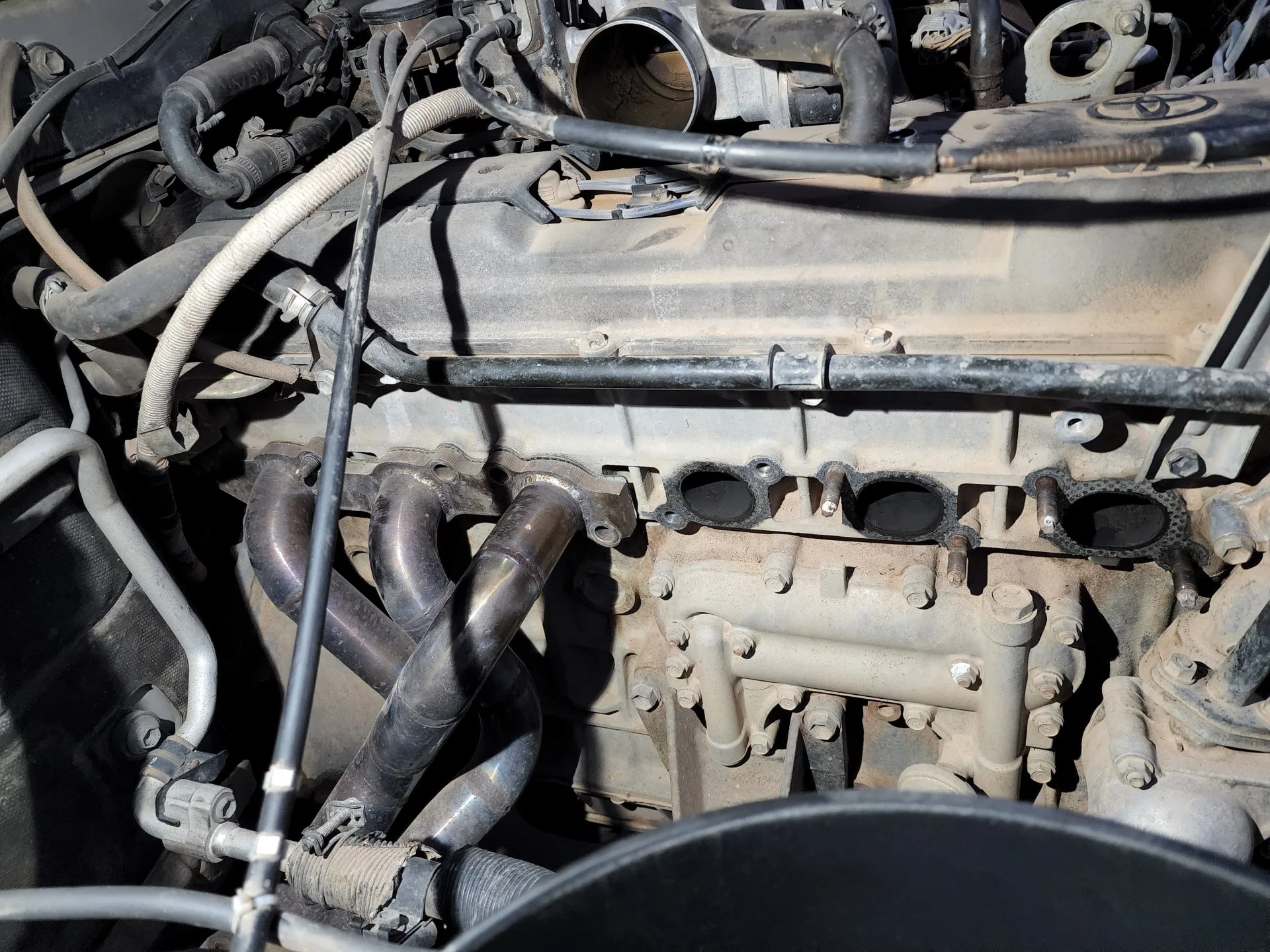

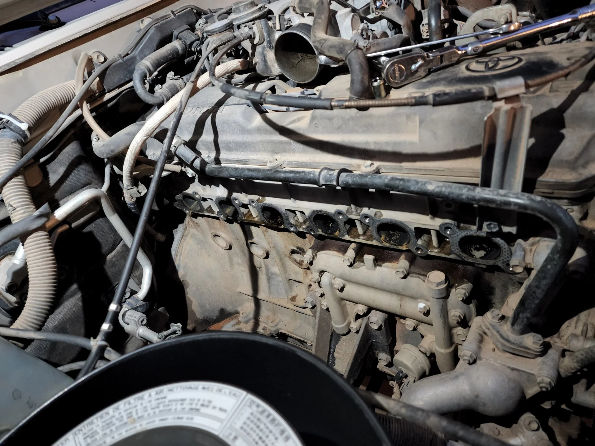

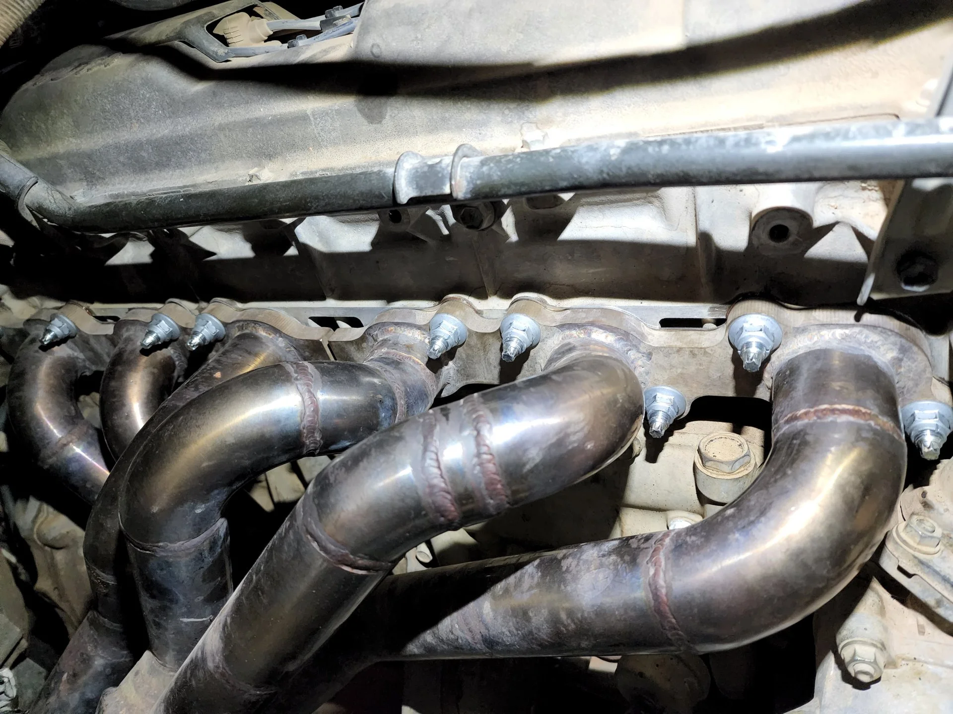

Later today I should be going over to a buddy's to tackle the exhaust manifold gasket.
Got the exhaust manifold gasket and collector gaskets replaced. The leaks were worse than I thought, it idles much quieter now.

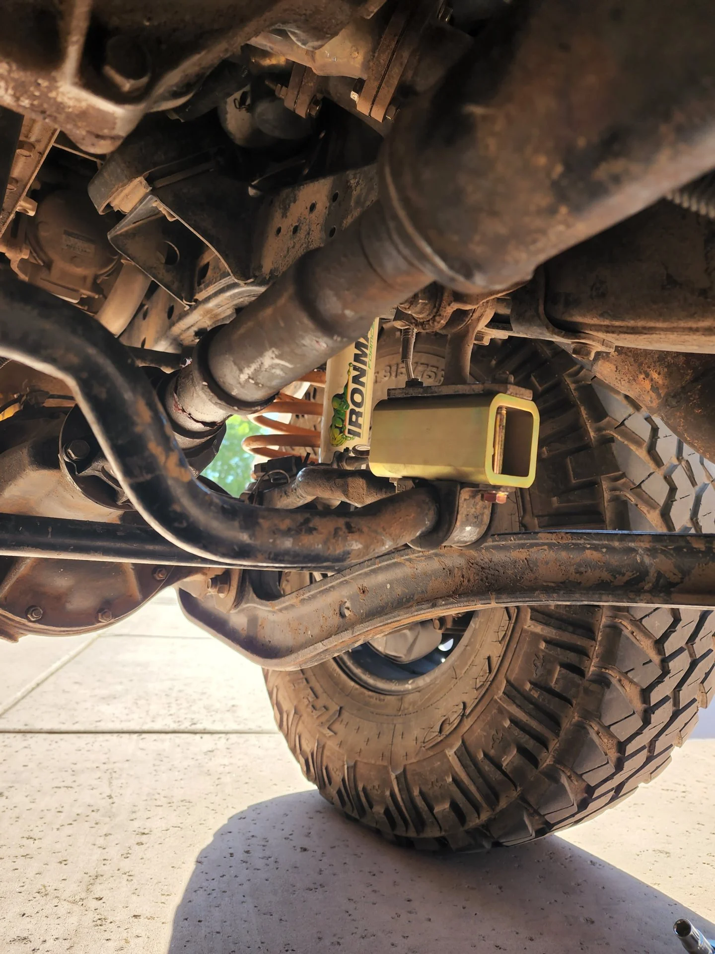

Well I feel stupid. I knew my sway bar was lowered but never really thought about after I got the rig.

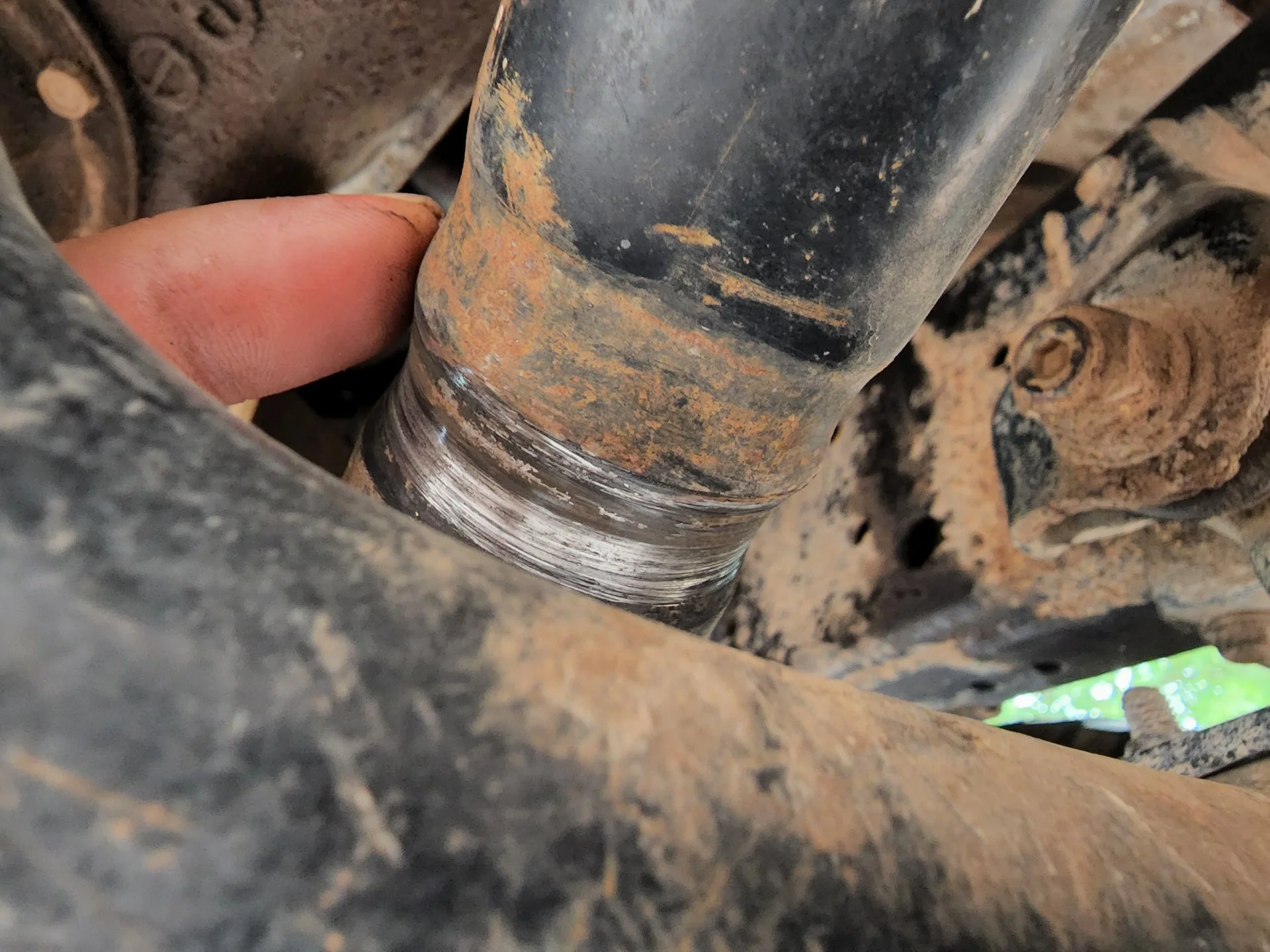

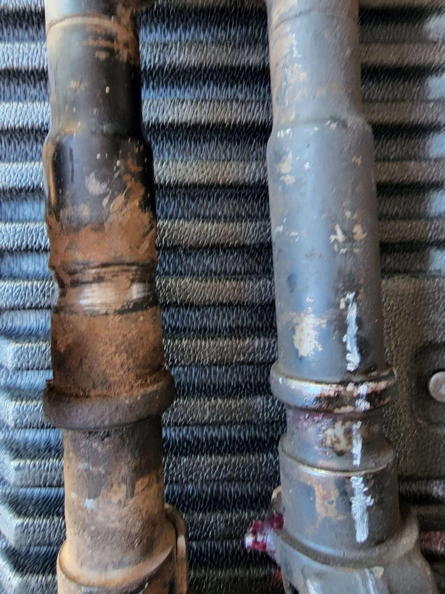

While I was fixing exhaust leaks I noticed the front driveshaft was gettting nice and grooved lol.
What's funny is the shaft has two grooves. One from before the RAM mounts and one after the ram mounts. Solid proof the axle got pushed forward.
Looking closer at the sway bar it had only been lowered 1" with some janky spacers. I guess a 1" spacer isn't enough for 3 inches of lift.
So I got some sway bar parts and new u-joints ordered and will get a different used shaft installed up front.

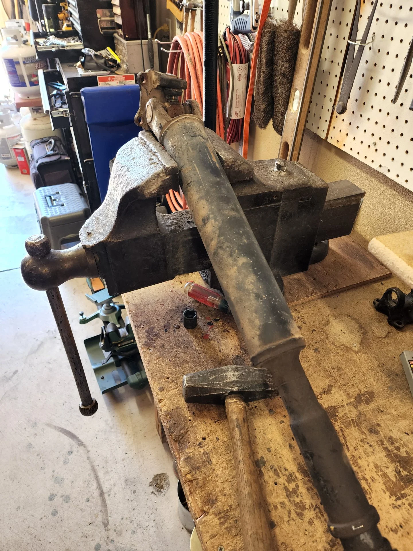

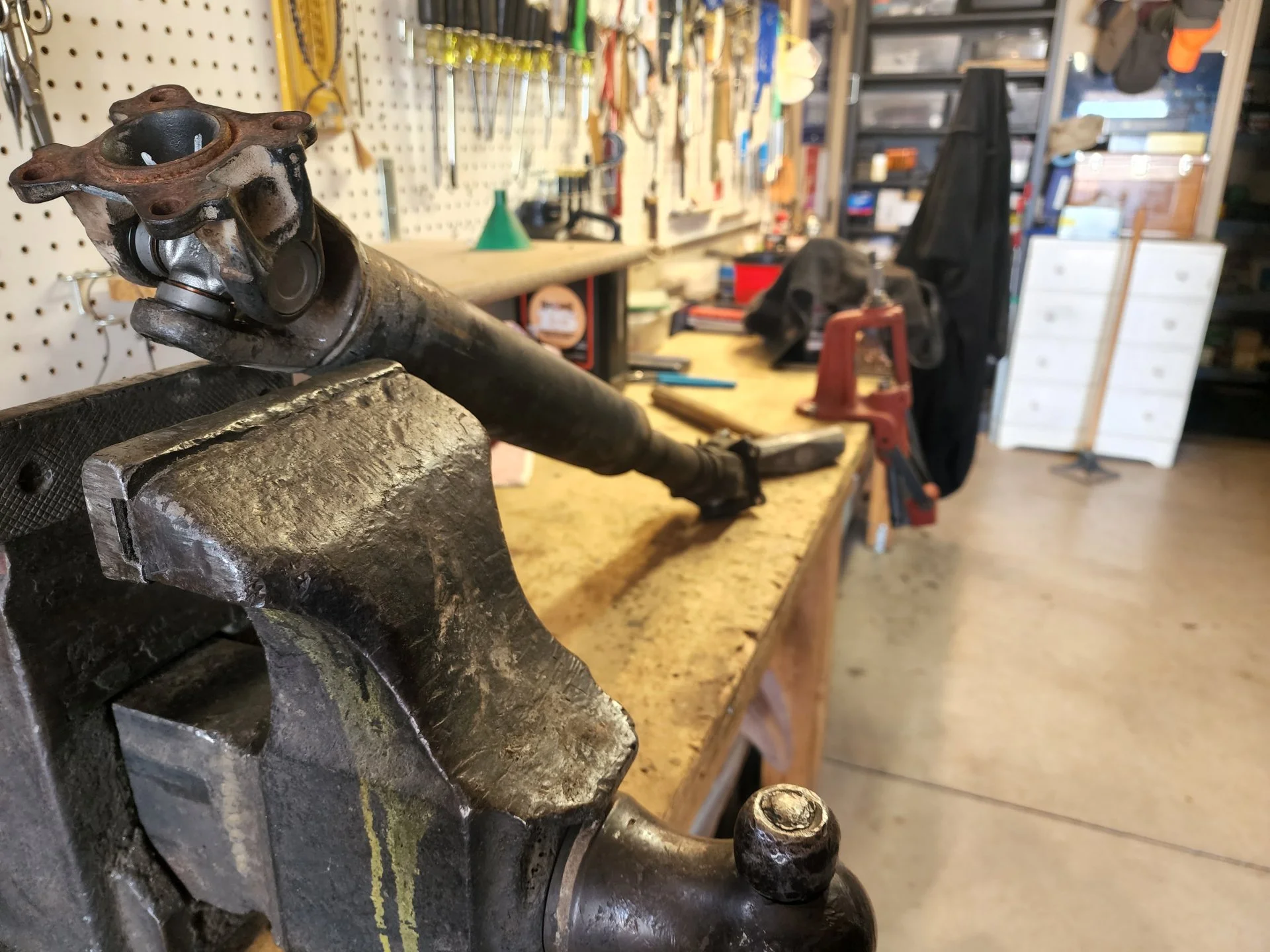

Today I got the old u-joints out and prepped the "new" used front shaft.
Installed new u joints on my spare shaft a couple days ago.
Than today I got some spare time to crawl under the rig.
The front drive shaft definitely had some grooving going on.
There are two grooves, the old one is from before the RAM mounts moved the axle forward an inch.
Out with the old and in with the old....
I ordered a 2" sway bar drop kit from @landtank to replace the 1" spacers that were on there.
I got a cold cut saw and drill press but I figured for $50.00 dollars it's worth it to avoid digging out the tools and spending 2 hours trying to find the right bolts locally. Plus his product has a high quality finish. Totally worth it 👌

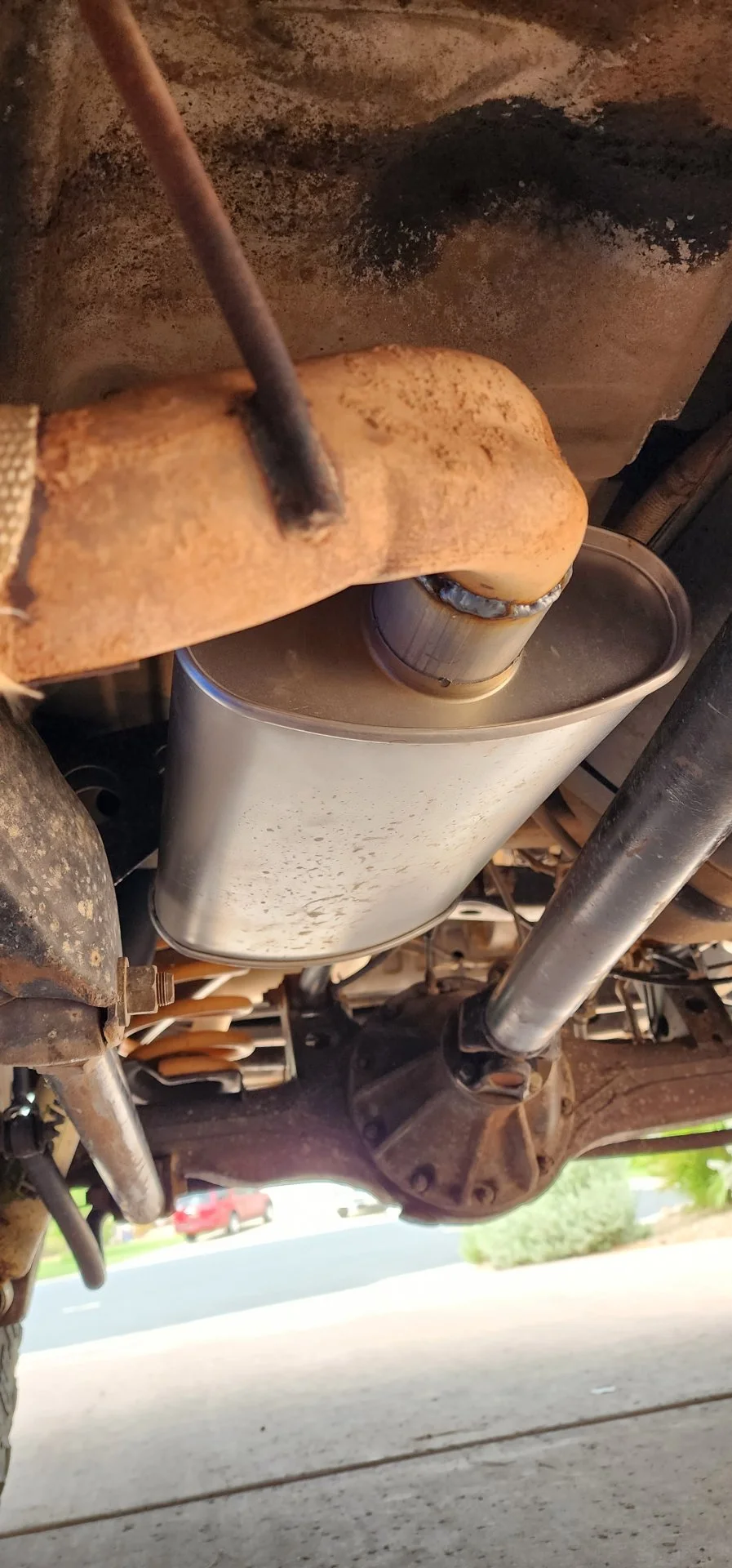

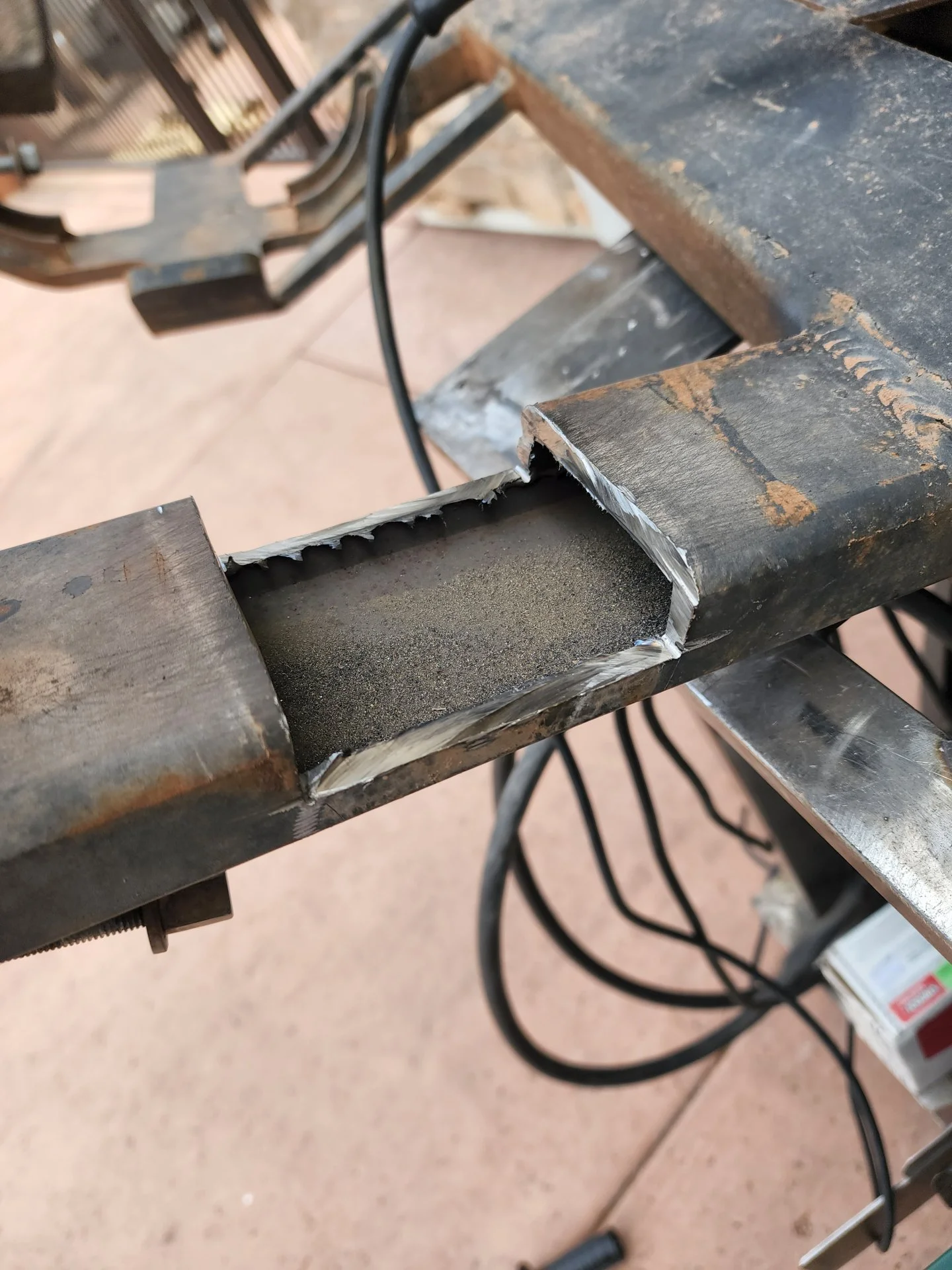

I have finally finished overhauling my exhaust. Between the leaks, rattles, and headache inducing loud muffler I couldn't take it anymore.
Took it to a shop and had them replace the exhaust the pipe behind the exhaust to quiet it up and cure the rattle where it would hit the body behind the muffler.

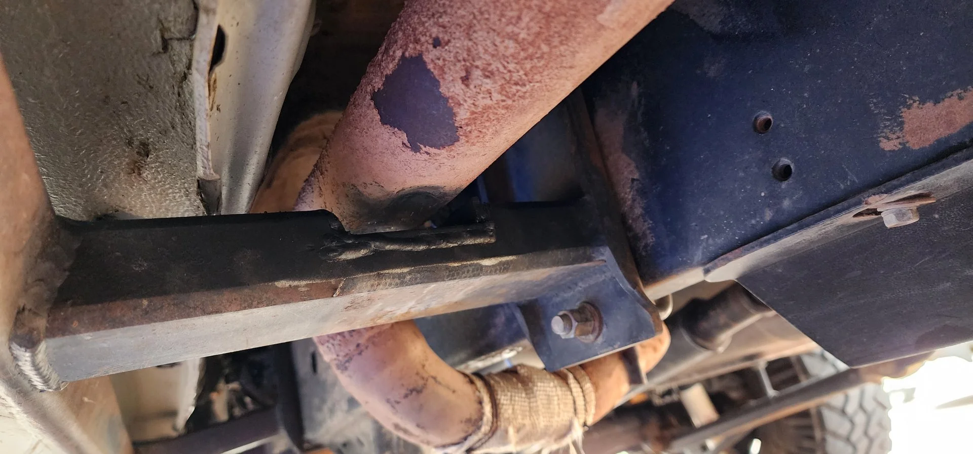

I decided to keep the exhaust from the cat to the muffler routed high and tight so to cure the last and worst rattle I pulled and notched the slider.
It's finally quiet!!!!
Ignore the rust, I know I need to spend a couple days cleaning and painting the undercarriage and armor.
