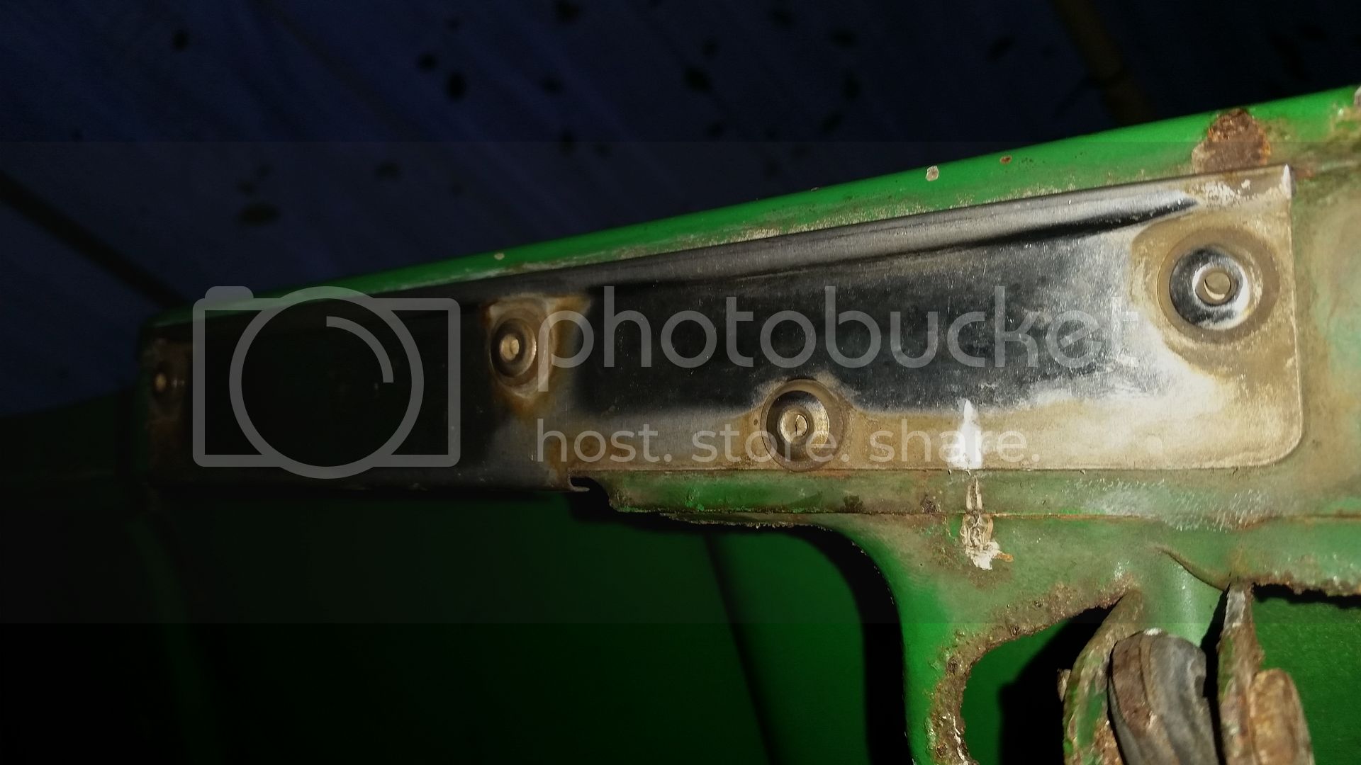

the other hood you showed with a pic of with the silencer is a later hood I think, it has the stainless metal plates on the leading edge of the inner hood(they match up to the rubber bumpers on the bib), my 82 has that. Your hood may have had them and they were removed

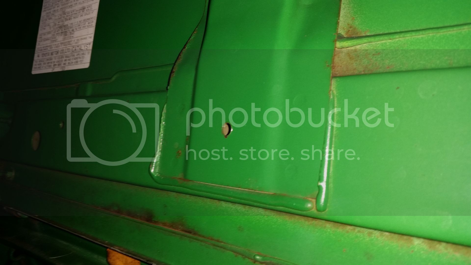

there should be a gap on the center support, but about every 6" there is suppose to be the body sealant that is painted body color, between the support and the hood.

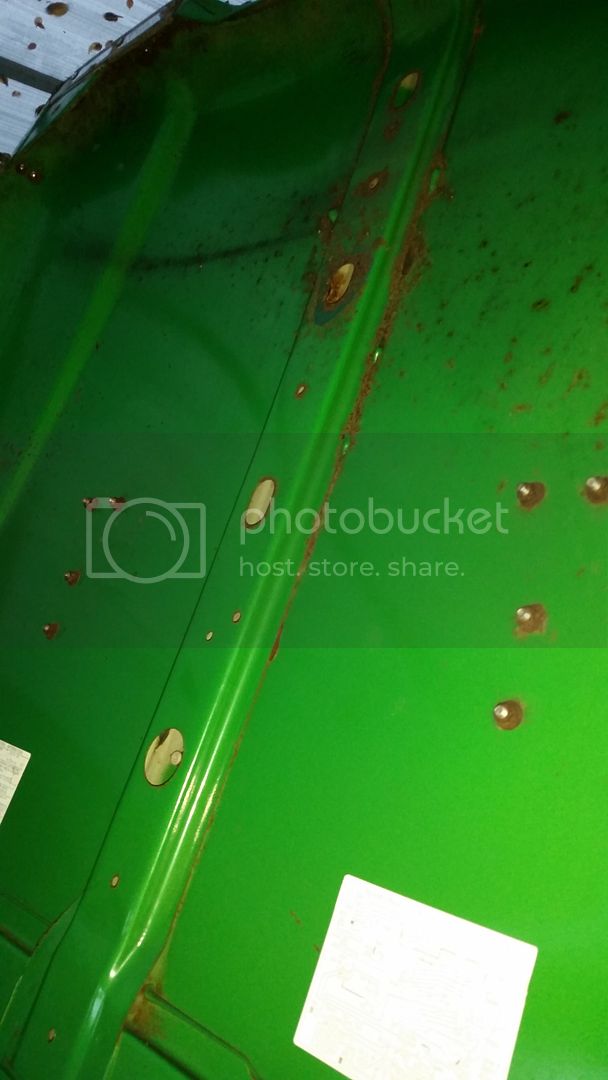

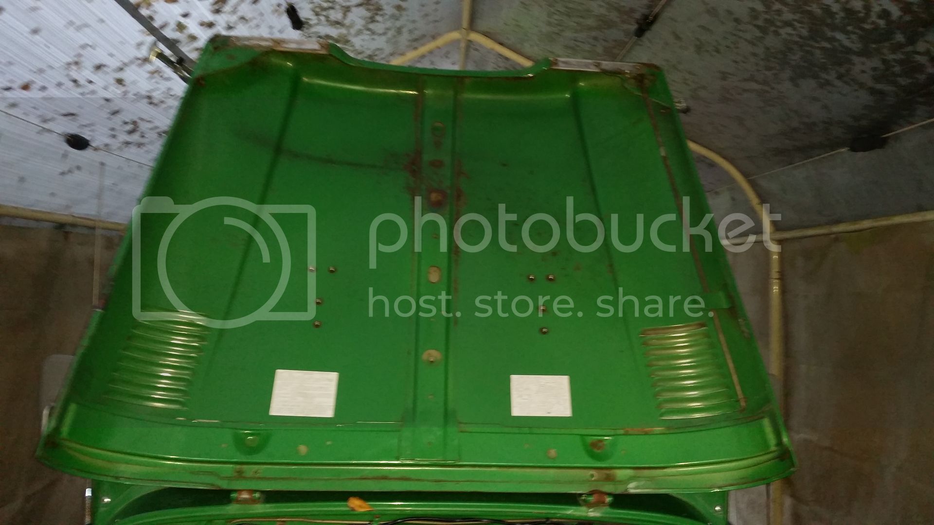

few pics of the hood on my 82, original and untouched. My other 82 was identical.
think your hood has the matching rivet holes, just not the plate
seam sealer used on the bottom of the center support
hard to tell but you can see the glob of seam filler toward the top of the center support, same stuff as above
